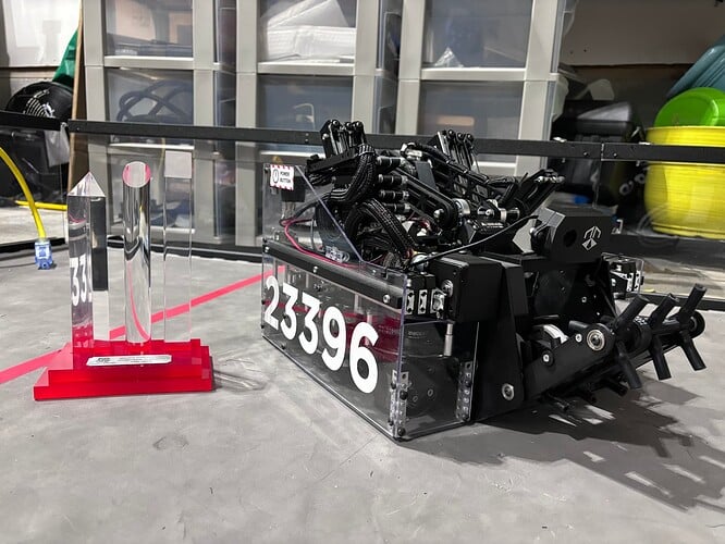

FTC Team 23396 Hivemind is proud to present our CAD & Engineering Portfolio for our 2024 season.
Won the Think Award and placed 3rd Inspire at our regionals
Our robot was a 12x12 coaxial swerve drive, with horizontal and vertical slides
Please feel free to ask any questions and we’ll answer them

Sorry if this is obvious, but for ftc what advantage does coaxial swerve provide over mechanum, and is that worth the motors used?

More of a design & packaging challenge for us than anything, it provides instant near acceleration and better traction due to not having slip from the mechanum rollers.

To add on to my previous reply, we only use 4 motors, the rotation of the pods is powered by servos with built in analog out so we can get their rotation
