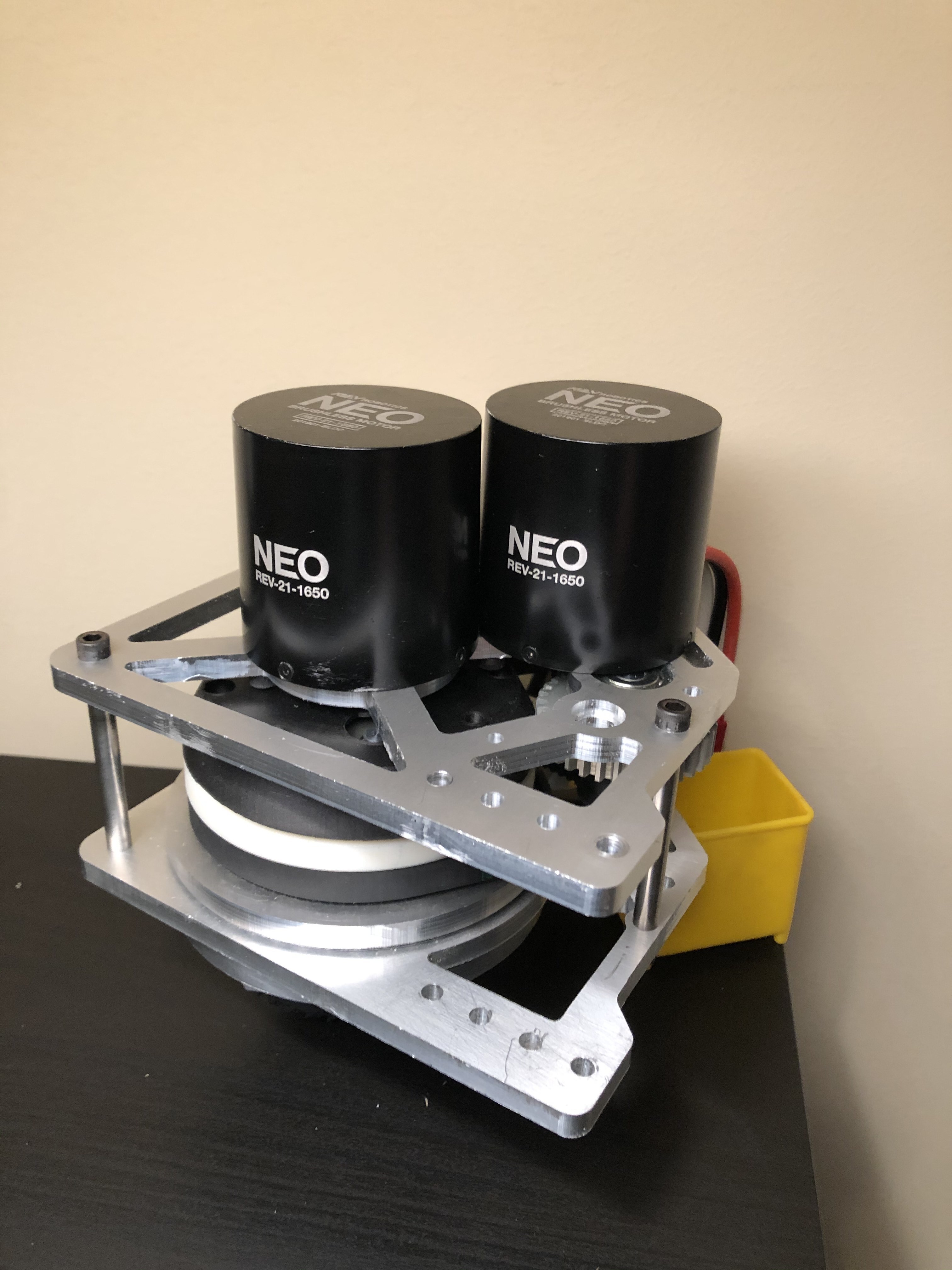

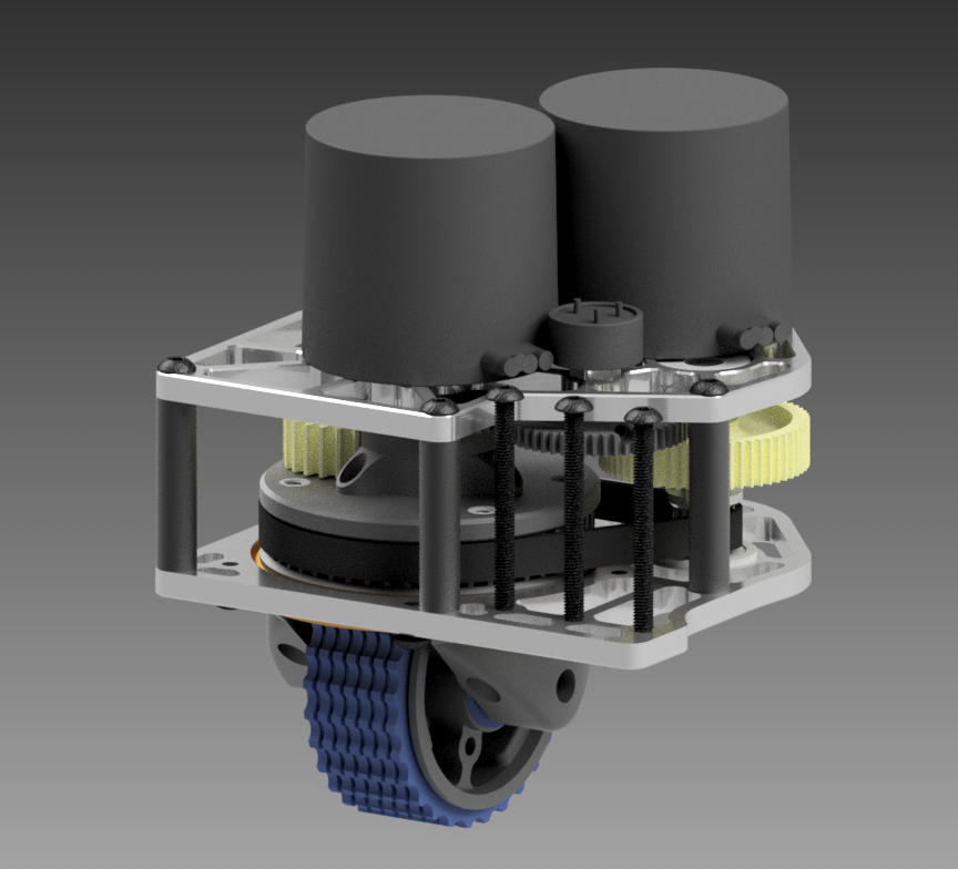

I am excited to announce Team Mean Machines’ new swerve module for bunny bots and hopefully the 2020 season.
The goals on the new module were simple, make it easy to machine, zero-backlash in the steering, durable and easy to maintain, and finally lightweight, “cough cough” simple.
Quick stats:
  • 3d printing: time = 28 hours and costs = $29.88, per module.
  • Tormach parts cut time = 80 minutes, per module.
  • Module Weight = 3.663 pounds, yes with everything pictured above!
  • Drive free speed options (ft/sec) = 14.95, 16.1, 18.07 (With current plates) 11.59, 12.65 (with different plates).
  • Steering reduction = 19.6:1

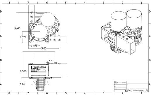

  • Module Size = 5” by 5” by 6.53” (with neo) or 7.53 (with Falcon), 1.875 form center of wheel to the edge of the frame.
  • 2.15 of ground clearance.
  • KHK bevel gears
  • 3" id by 3.5"od and .25" thick sealed bearing.
  • 3" wheel
  • bill of materials cost is 315$ includes everything pictured above.
CAD will be released before build season.
Questions are welcome as always!

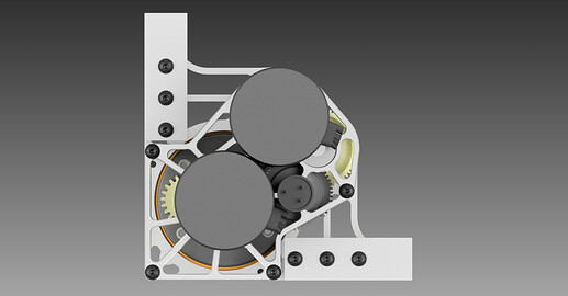

Is there bearing support under the vertical bevel gear that drives the wheel?
What size bevels are you using?
What size pulley is driving the steering of the module? How many teeth are engaged by the belt on it?

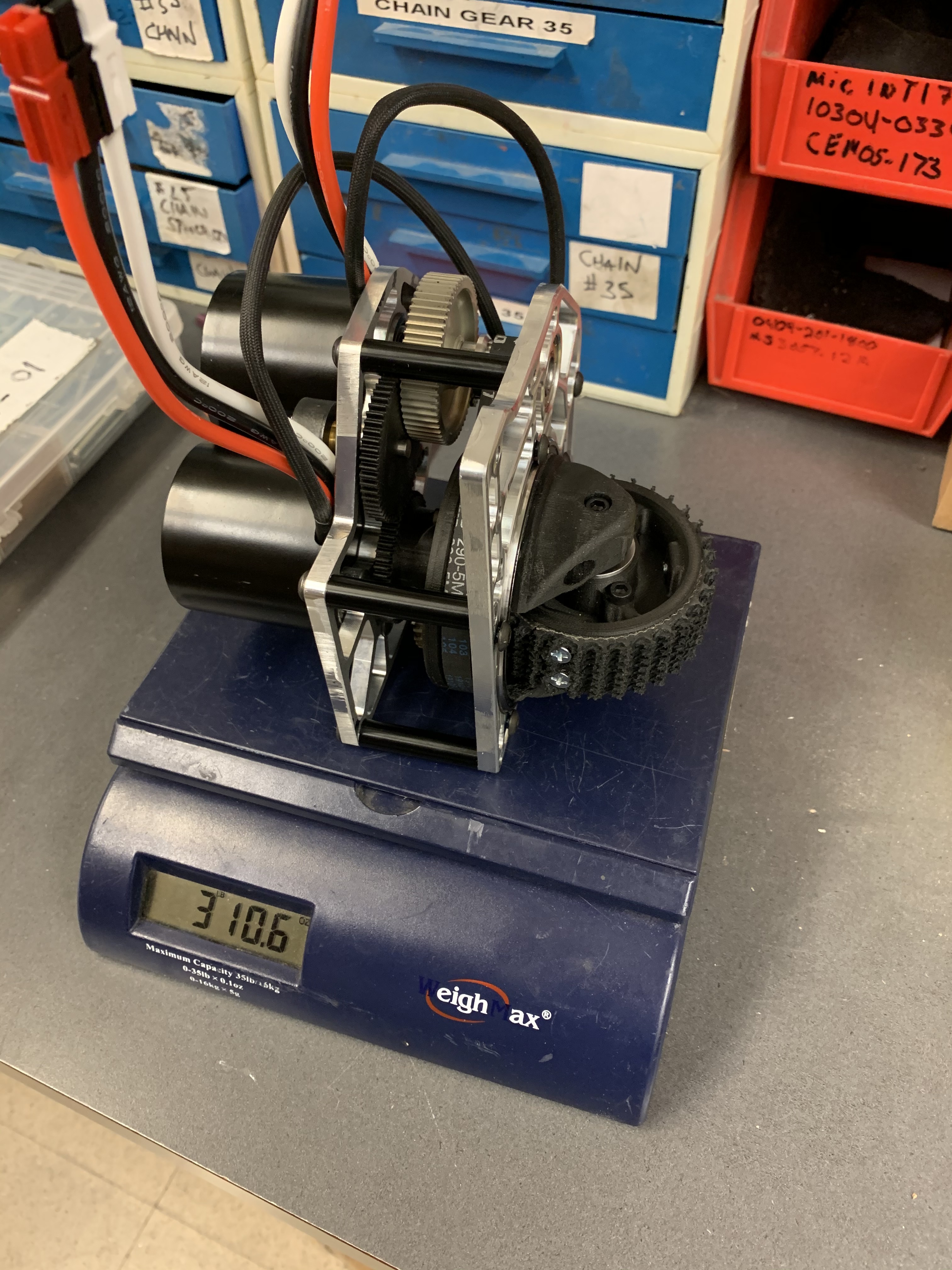

I read the scale and thought it was 310.6 lbs

Hey Nick,
Hope I can answer some of your questions!
Yes, there is a .25 id bearing in the very similar to how 2910 has done it in the past.
We are using the same ones as last year, the KHK SB1.25-1545 and KHK SB1.25-4515. We have moved to bolt the gear to the wheel instead of epoxying it to allow for wheels to be scraped without losing the gear.
We are using a 10 tooth belt pully like used on 2910 mk2 module and have around 3 teeth engaged at any point in time.
-Owen Wilks
Hey Caleby, Thanks for the kind words!

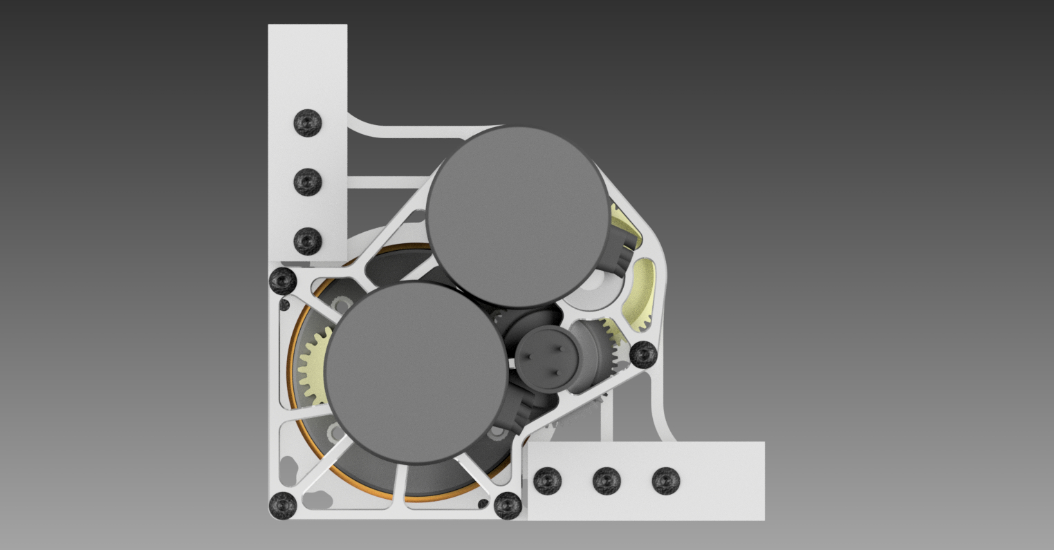

Last year we never really had a problem with backlash in the versaplanetary as the encoder was on the final belt stage. We wanted to be able to PID the new modules steering using the neos built in encoder and knew that we couldn’t have any backlash. The Magnipot from Digikey is only used at the beginning of the match to zero the modules, the rest is done with the neos.
-Owen Wilks

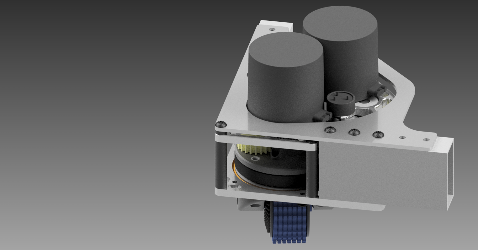

Have you noticed or expect any robustness issues for not extending the drive train tubing all the way to the edges? If not that extra space saving is really nice!

I don’t expect issues, but we won’t really know till we use them on a full weight chassis.
Anecdotally, I stood (160lbs) on one of the frame rails of our bare chassis. There was some visible deflection, but it didn’t cause a problem. Also, the spacer that is supposed to tie the corner of the module to the top plate of the frame (which would significantly increase rigidity) was not there during the test.
