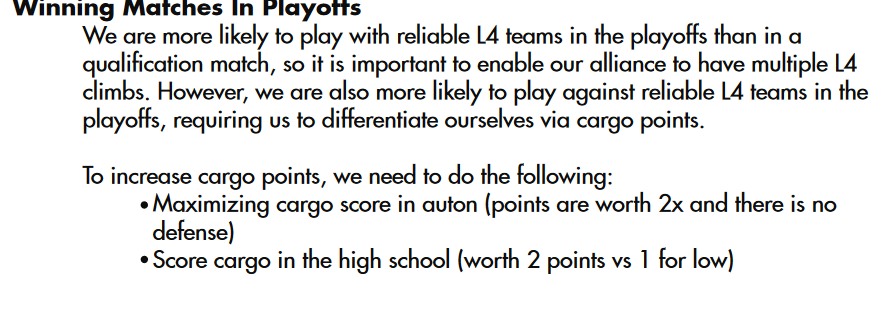

I wouldn’t want to score cargo in the high school

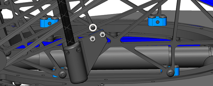

  1. Is the shooter assembly only connected to the turret with 4 bolts? If so what size bolt did you use, and what percausions did you take in the design process to make sure that it is stiff enough and durable enough to withstand the vivrasions and kickback of the shooter?

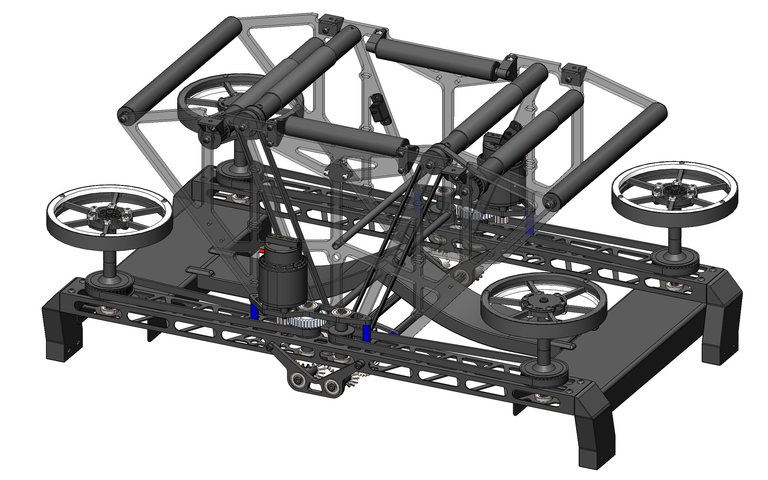

  2. I would love to understand more about your serializer design, mainly the integration to your chasis.

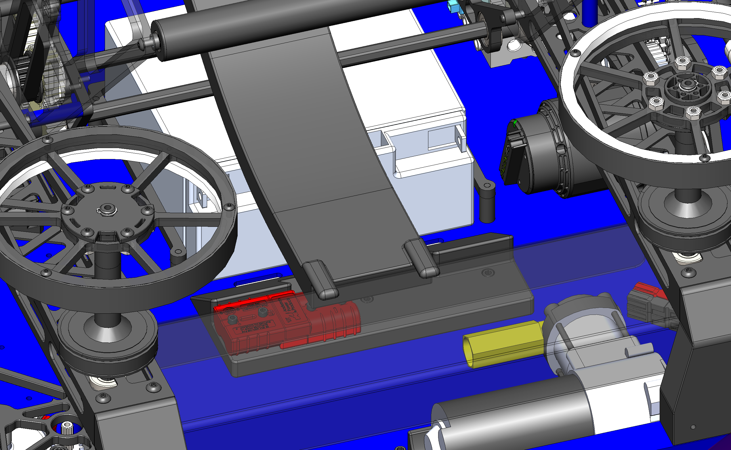

  3. If there are any pictures of your battery inside the robot, It would be great to see, as I don’t fully understand how it mounts there.

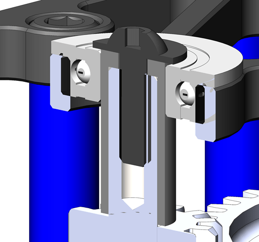

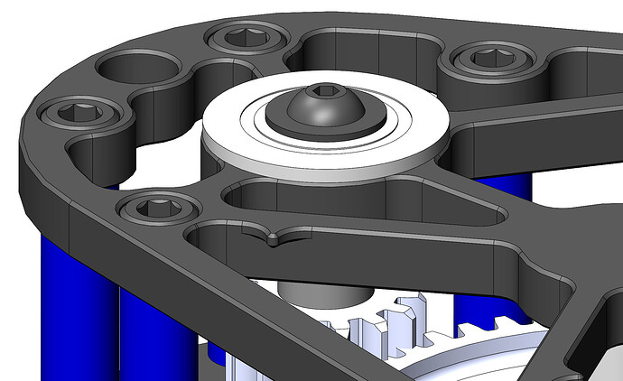

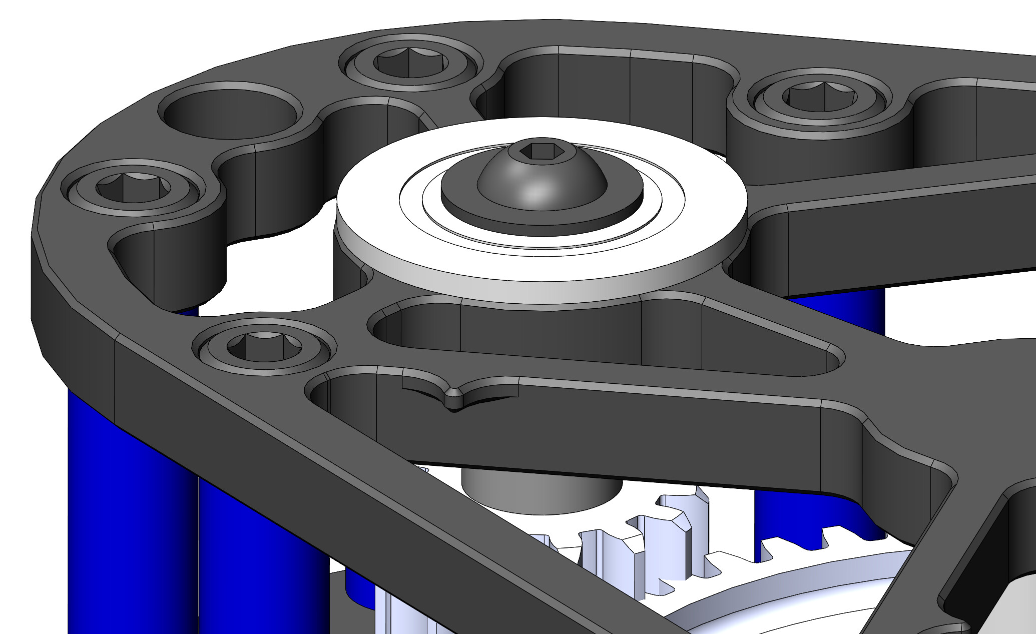

In the binder it says you modified the swerve modules to add bearings that support motor shafts. Is it possible for you to post pictures of what this modification looks like along with information on the bearings you used?

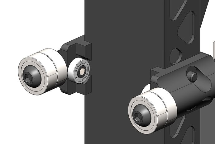

What is holding the elevator carriage on the sides? Are there some recessed bearings or something?

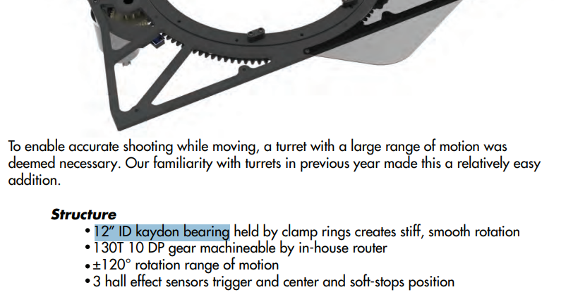

Is this a genuine Kaydon (Reali-Slim?) bearing? Regardless, would you mind sharing the source/vendor?

Shooter Mounting
There a 4 CNC milled adapter blocks that connect the stationary main sideplates of the shooter to topside of the rotating inner ring of the turret. The blocks have 2 #10-32 cap screws that go into the turret ring, and 1 #10-32 that goes through the shooter plate and taps into the block. We didn’t do analysis except back-of-the-napkin “feels about right” math. The screws are well spaced out and the clamping force and friction generated by 10-32 screw is quite high. More screws probably would’ve helped a bit but after we tried this method in 2020 and it worked fine we felt comfortable doing it again in 2022.

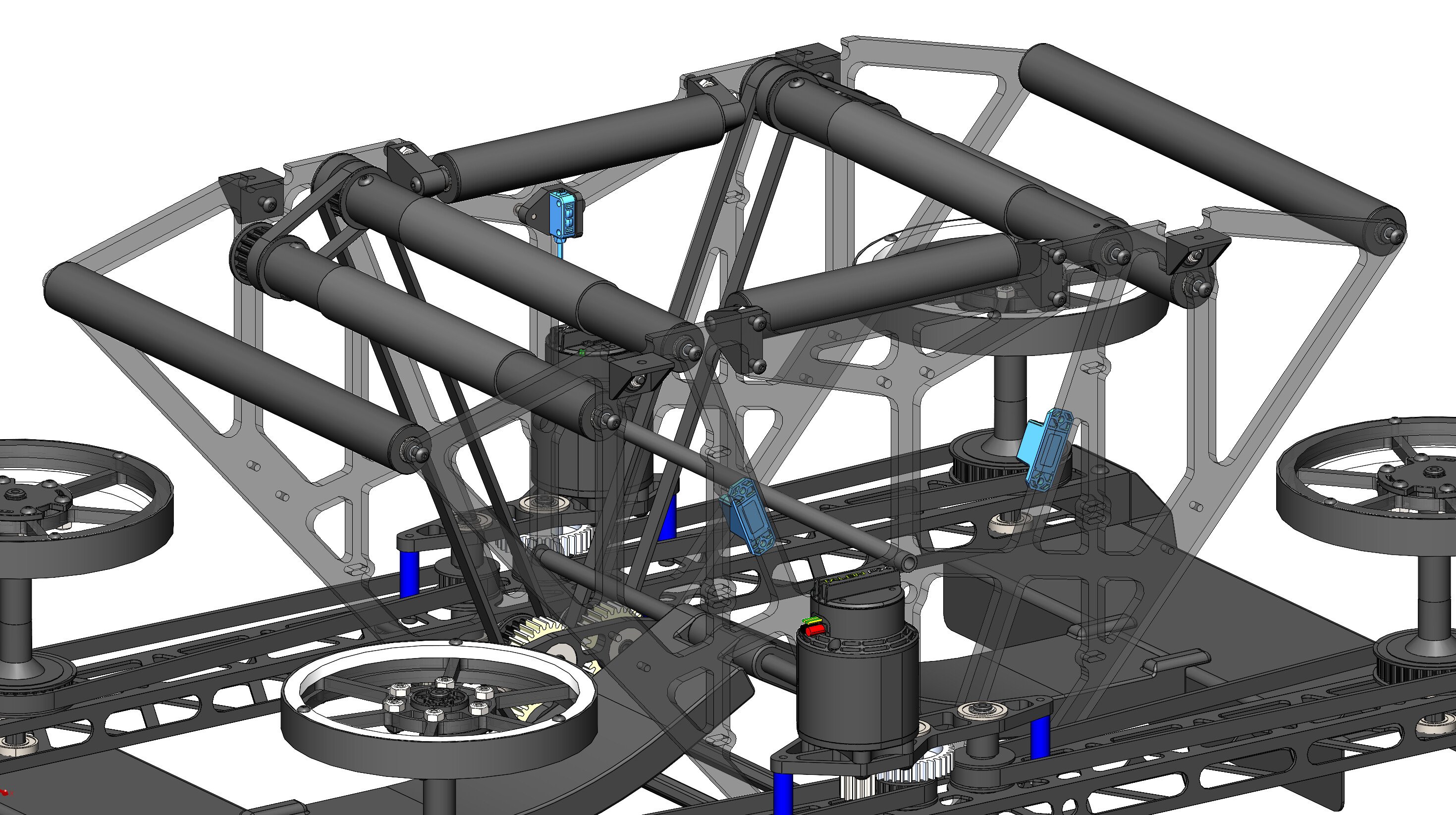

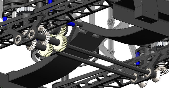

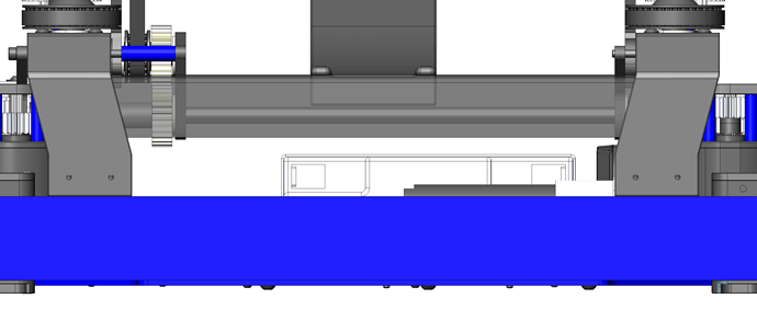

Serializer
Functionality and Ball Path:
The Serializer and Feeder subsystem funnels balls from full-width intakes to a single ball stream up into the Shooter. Wheels made of stacked 6" diameter polycarb plates with grip tape on the outside funnel the balls. The ball is then pulled in and up into the shooter by powered top rollers, with a combination of grip tape or heat shrink to have the right amount of grip.
Powertrain:
The top rollers and funneling wheels for the robot’s left side are powered by a single Falcon 500 with a gearbox, bevel gears, HTD belt runs, and a connecting jackshaft. The top rollers are 1" OD 1/16" wall tubes with 3D printed endcaps with pulleys and bearings in the ends spinning around 1/4" OD deadaxle standoffs/shafts. The outermost top rollers were passive and just held the ball from popping out the top when being funneled.
A mirror image gearbox powers the robot’s right side wheels and top rollers. These two motors let us drive just one side or other, allowing us to feed one side into the shooter first, or shuffle a ball from one side to the other.
Shuffling was needed to open space for the incoming 2nd ball, which may be of the wrong color so we needed to be able to pass by and go out the shooter while not touching the correct ball we are already holding.
Structure:
The heavily pocketed horizontal 2x1s hold the funneling wheels, gearboxes, and bent-polycarb shelves that the ball sits on as it gets funneled.
The large triangular polycarb sideplates hold the top rollers, Color Sensors (REV V3 worked well) and Banner beam-break sensors. It also held the standoff that large curved ramps could pivot on, to be lifted up for robot maintenance or getting the battery. These polycarb plates also held a piece of surgical tubing that served as a reaction force to push the ball into the feeder top rollers. The surgical tubing was lightweight and worked in both directions, always complying to push the ball against the roller it needed to. This clever bit of design is one of my favorite features on the robot.

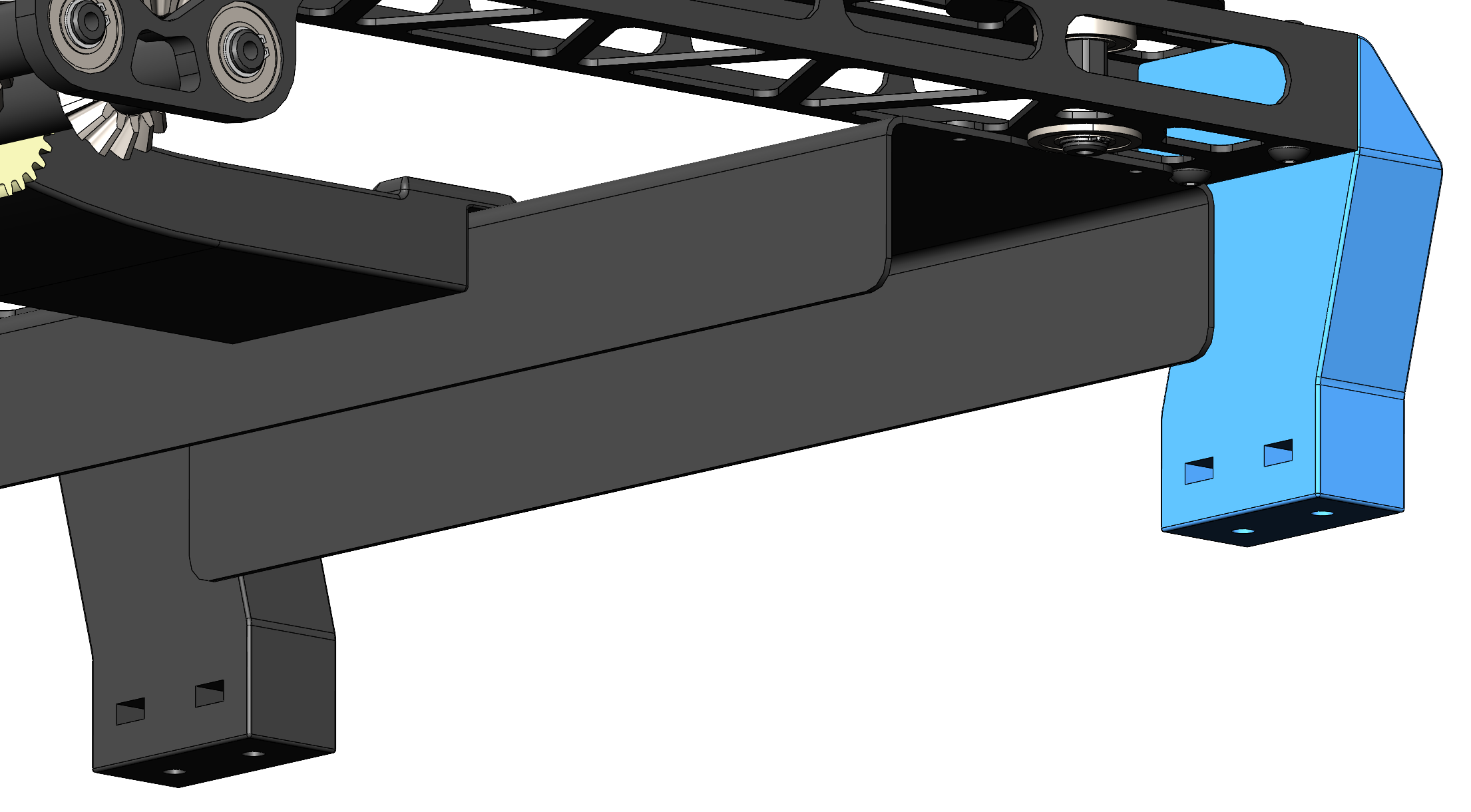

Mounting:
3D printed (Markforged) blocks connect from the top of drivetrain framerail 2x1s to the horizontal pocketed 2x1s of the Serializer. They have a little “jog” to them to allow mounting to frame rails outside of the MK4i swerve modules, then plug into the endcaps of the horizontal 2x1’s at the correct spacing the 6" funneling wheels wanted.
Square-shaped 10-32 nuts are pressed into the 3D printed blocks. I do not recommend this, this offseason square nuts spun free in the pocket and we had a real bad time getting the Serializer off. We had much better success in other locations form-tapping 3D prints and just threading directly into the plastic.
Battery
The battery is in the direct middle of the robot. This had some weight/CG benefits, but mostly was dictated by packaging. During initial placement we had a large color sensor under the bent polycarb cross-bridge pieces, this prevented the battery from being near the frame rail on left or right side. The elevator and stinger for climbing prevented the battery from being near the frame rail on the front or back. The middle was really the only open spot.
The battery is held in with a 1/4" thick aluminum plate held on standoffs, with 2 webbing straps with buckles pulling it down to the bellypan, like we’ve done for battery boxes in the past.
A 3D printed ramp on on side holds the Anderson connection and the wedge ramp allows the battery to angle up and slide out of the robot. The large curved ramp of the Feeder needs to be lifted and pivot up to get the battery out.

We green-loctite glued 19mm OD, 10mm ID flanged bearings (4390N154) into the holes (19.13mm ID) in the top swerve plate. A 3D printed adapted slide over the end of the falcon shaft and into the inner race of the bearing. A flanged button head cap screw on top threaded into the end of the Falcon shaft and held everything together.
We don’t really know if this was necessary or helpful. Plenty of teams ran MK4i all season and offseason without this addition and had no issues. This didn’t seem to introduce any new issues for us and was a pretty small cost on weight, so we kept it. Not sure we feel we need to do this next year.

The carriage uses the new WCP elevator bearing blocks (WCP-0323). These blocks have very small (12mm OD) bearings that roll against the inner faces of the elevator uprights and constrain the carriage side-to-side.
Luckily the side-to-side loads weren’t that high this year, mostly front-back like most elevators, we did eventually replace these tiny bearings in the offseason but they held up through Worlds.
We purchased the bearing from Ebay, which allowed us to get it for much cheaper than buying it new from Kaydon directly. I think we actually ended up with a FAG-branded bearing, but it doesn’t really matter since almost any large thin-section bearing (including much cheaper knockoffs) would be fine for this application with such low load and stiffness requirements.
Just to share another way to get these as @josesantos brought up a good question here. 118 struggled a little to get our hands on large thin section bearings last season. We used Lily Bearing for our turret bearings. We bought ours for just under the $600 limit and got them just in time to stick them into our robot to film our reveal video, after about 6 weeks of shipping from China.
We had no issues with the quality of these Kaydon clones and will likely use them again. We will continue to plan for long lead times and order early.
