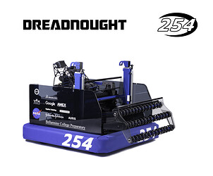

Team 254 Presents: Dreadnought 2020-2021 Technical Binder + Q&A
Team 254 is proud to present our Technical Binder for the 2020 (and 2021) seasons.
The Technical Binder, along with our Reveal and Season Recap videos can be found on our team website.
Dreadnought never got to compete at a regional, but we are (as long as the school allows) going to pursue attending California offseasons this Fall. We are still deciding whether or not to release the build blog, but we will eventually be releasing the 2020 Code when it is ready.
Myself and other students/mentors from the team are also happy to answer any questions you have about the robot and these past two seasons, but I advise anyone to skim through the Technical Binder before asking a question.
We do not upload / directly share CAD files, but I can pull up screenshots if needed to clarify confusions.

Mind sharing a CAD screenshot of the linkage for the chock and the actuation of the ramp in the back of the serializer? These renders look dope, but it’s a bit hard to make out some of the smaller details from the pdf.
Are you guys using some sort of traction control code? I remember doing the math for 4 falcons and something like 13ft/s would already get you wheel spin.

Gearing really fast is an effective form of traction control.

CHOCK
The Chock was a late addition that helps the Serializer. While intaking, the Serializer is contantly running counter-clockwise (when viewer from above). As the first few balls come in, they will get swept around and back to be under the shooter, making space in the front half of the serializer for the next 2-3 balls to fall in. When we are ready to shoot, the chock gets lifted and the serializer spins up while the shooter spins up.
The Chock itself is just a fixed plate and a moving plate. A cylinder pulls the moving plate down. Pivot is a shoulder bolt and a bushing.
“Skatepark Ramp”
Normally while the Serializer is spinning, the balls barely contact the 2 Feeder rollers. When we want to shoot, we needed some way to slightly elevate the balls above the normal serializer floor they were rolling on, so they would contact the Feeder and get taken up into the Shooter.
The Skatepart Ramp is our nickname for this little pancake cylinder that just pushes up a flap of 1/16" polycarb to create a little ramp that guides the balls up to the Feeder. Nothing more than a cylinder whose rod pushes directly on a piece of polycarb is thin and fixed on one end.
