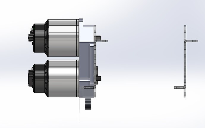

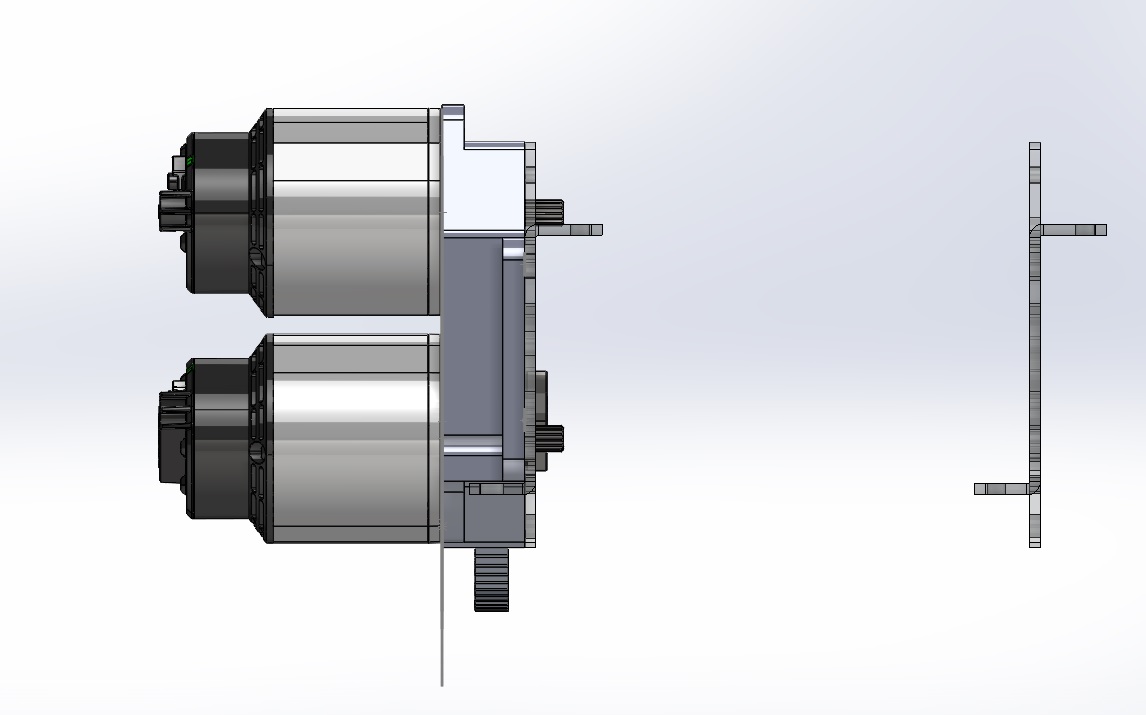

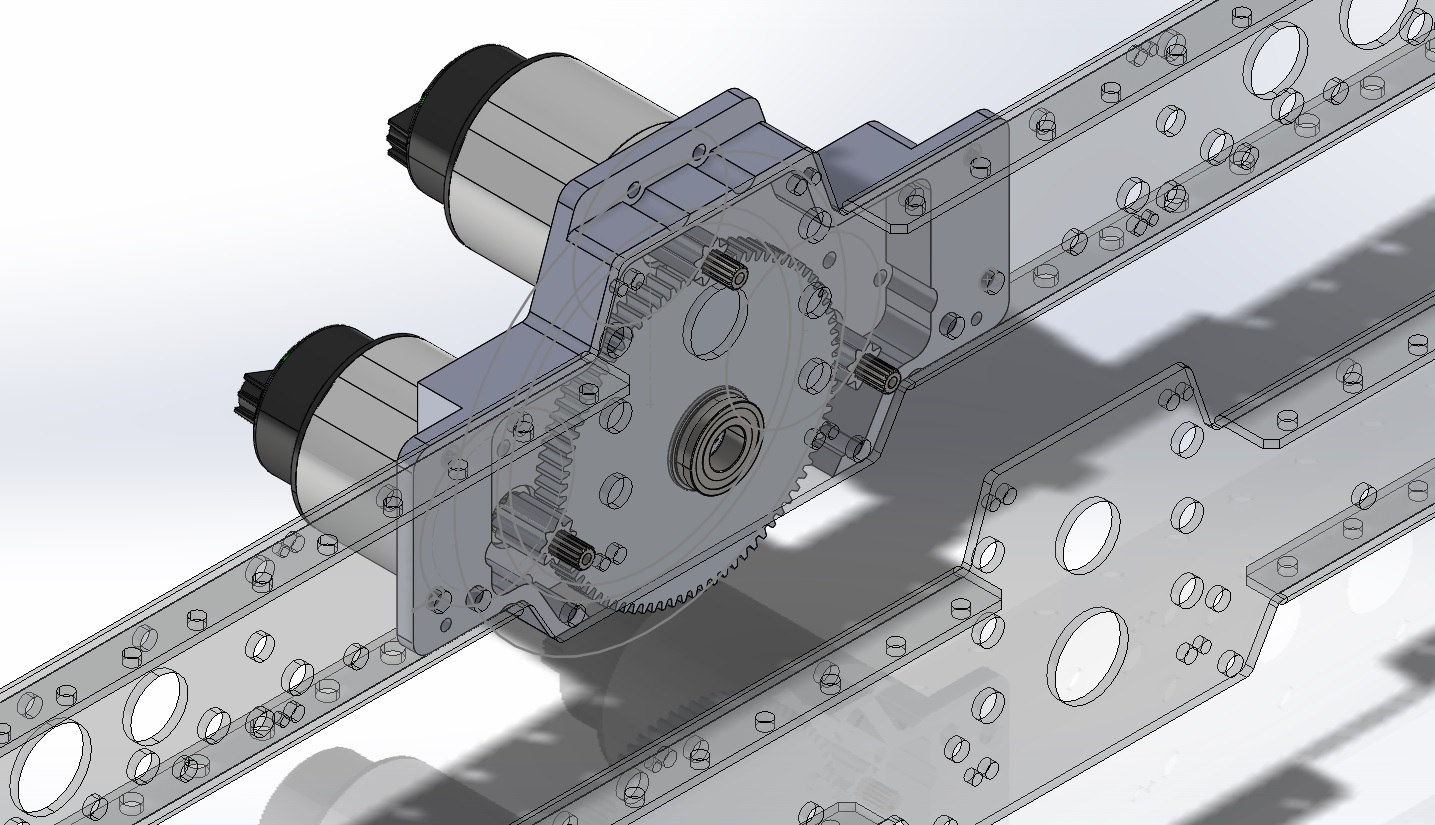

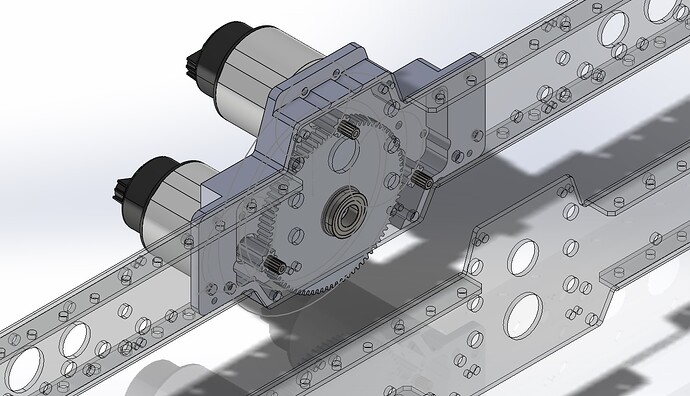

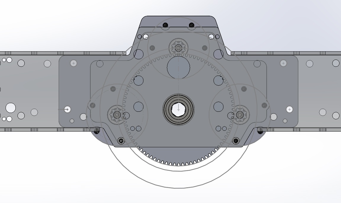

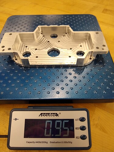

Please take a look at some of the preseason work we did this year! I have to say I’m pretty proud of the students for their work on this. We had a couple of goals in mind for this. 1) To design and build a three falcon gearbox that is similar gear ratio to the KOP gear ratio and that would be a bolt on replacement to the KOP gearbox. 2) To learn to go from our Solidworks model to our Acer knee mill with Accurite G2 controls. We found that the plug in for HSM works to Solidworks has a post processor for the Accurite G2. It took a bit of work for us to figure out how to set HSM works to not use any Z axis because our machine only has two axis CNC control. Once we did, it wasn’t really too bad and was very nice for the program to come up with the tool paths rather than us moving the machine.
From the link attached the .step file is there so that we are compliant with R15. If you are able to see it, there are two inner plates for the chassis shown there, an AM14U3 and AM14U4. We have both at our shop, so we needed to see what the specific differences were. In the link there are multiple pictures of the one machined component we’ve made and a video of a portion of one of the toolpaths (plus the youtube video is here: https://youtu.be/SEaLQLfd4ZA ) . We were hoping to have the Falcons in time to try it out, but as we all know they aren’t available yet.
And yes we have read the other forum topics on three Falcons are too many, but in this design it would be very easy to leave out the top motor and just run two. We wanted to keep our center of gravity of the motors as low as possible, and still mount to the KOP chassis, so keeping them low was more of a priority that flipping them and putting them above the frame rails as others have done.

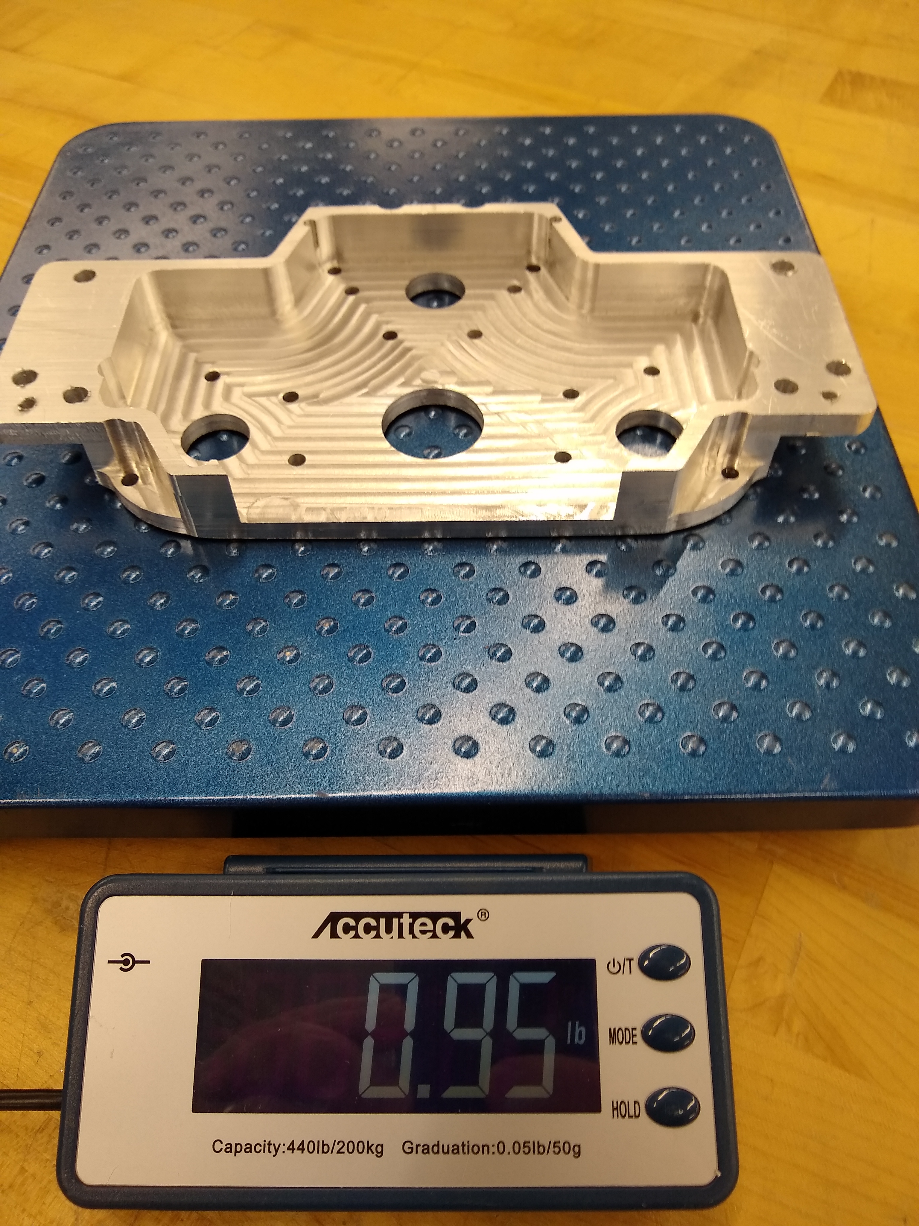

Wow, is that all one giant billet block? Very impressive! What’s the final weight and machining time on it?

Yes it was. As I like to tell me newer students, the seniors went digging for a part in aluminum and they found the part they wanted!
As far as time, that’s hard to say really. It took us a long time because we were learning the process flow and how HSM works, and how it interacts with our mill. There were several setups on the mill plus it was a job for one of my seniors that still had classwork and this was an additional project for them.
Hopefully our precision machining class can come through and make this on their HAAS Mini Mills also.
Oh and final weight was 0.95 lbs for the Aluminum.
On that toolpath, there appears to be an aggressive 60 IPM full DOC slot at around 1:50 in the video. How well did that cut in real life? That seems like some insane material removal for the endmill.
Nice catch!!! :slight_smile:
That video was the first pass before reviewing it with our machining class. That definitely got changed, plus every single tool path. The HAAS Mini Mill - EDU only has 4000 rpm and we kept the IPM down to 12 and the “carry over” (I’m forgetting the correct term right now) to about 20%. So, a lot changed in the tool path that they have, but didn’t have a chance to get to before Christmas break.

This is really cool. Personally, I would redesign the gearbox when the game is revealed so that there isn’t a top motor mounting point so less material and less weight. When redesigning, you could also reconfigure the gear ratio to be more optimized for the upcoming game.
On the second setup, there’s a removal for the mounting flanges which starts from the center and leaves the outside edges for last. Did you have issues with chip evacuation there? It looks to me like it might have been easier to remove material from the outside in there.
I see that the Kitbot on Steroids has evolved, and has become a Kitbot on Hallucinogens.
What will you do with all that torque? Traction limit will be less than 20% of stall.
Maybe put a PTO somewhere and yank yourself off the ground in a few hundred milliseconds.

This design seems ripe for Delrin to me. Since the spacers are integrated into the plate, the usual issue of needing additional plate support for a plastic gearbox is gone.
