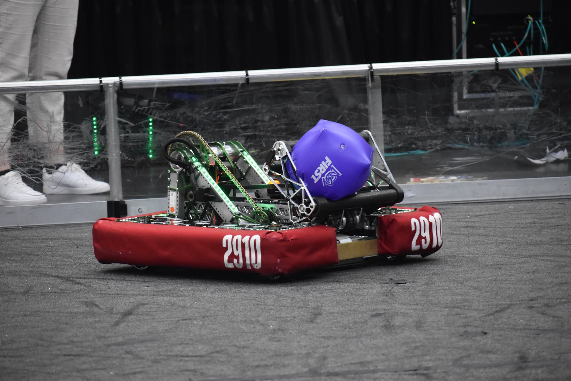

Team 2910 Code Release 2023
Team 2910 is proud to release the code for our 2023 robot!
https://github.com/FRCTeam2910/2023CompetitionRobot-Public
Let us know if you have any questions.
