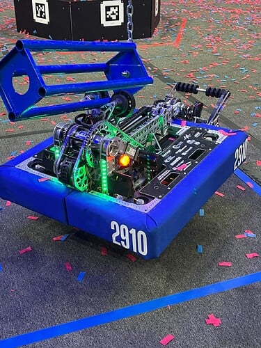

Team 2910 Code Release 2025
Team 2910 is proud to release the code for our 2025 robot!
https://github.com/FRCTeam2910/2025CompetitionRobot-Public
Let us know if you have any questions.

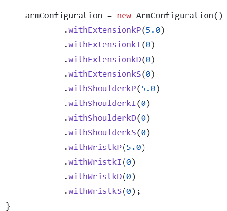

Find it magical to see these numbers

How did you guys do replay mode for advantagekit? Isn’t the logic unreachable? Not real means you’re robot type is SIMULATION but you need to have a robot type that isn’t sim to activate replay mode.
They also seem to use the regular CTRE drivetrain class, not the AK impl. Plus, they don’t have IO classes for simulated subsystems. I get the idea that they use AK for powerful logging, but don’t do replay. But I could definitely be wrong.
I thought I heard it in their btb video but I could be wrong. Also, what level of simulation did you guys have? Did you find it useful to test out things before they were fully built?

We did not use log replay this year
We used simulation but I think this year we did a good job of actually testing out code on past robots. We were able to get our arm code fully running on our 2023 robot before bringup :stuck_out_tongue:
