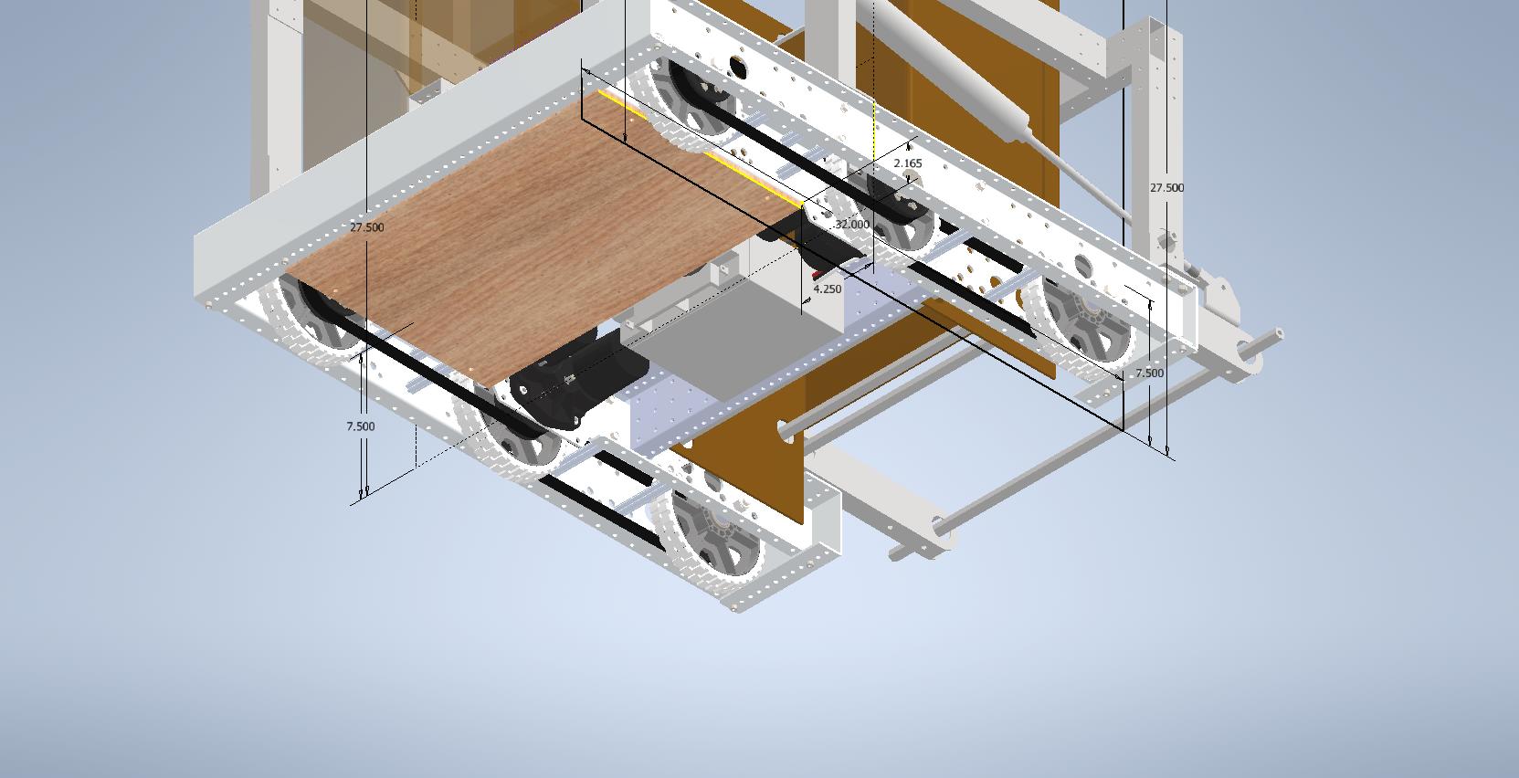

First off:
Dumpling.
Dumpling is a box on wheels. Running the full length of the field to load power balls from the feeder station, and run them to the low goal. It will either use springs and a motor to pull a pin, or 2 small motors to lift two hooks up to grab the switch, a 45:1 gear setup will then wind up cables connected to a pulley on the bottom of the hook to lift the robot from all 4 corners.
Showing the back drop out panel that should bridge the gap between the back of the bot and the feeder station.
The box lifts up to dump the balls into the low goal. we may have to carefully design the box to prevent jamming, or make it active using belts on the bottom.
Shows the lifter fully extended. It pulls the hooks down hopefully hooking onto the bar. The hooks then disengage from the lift mechanism and lift the robot up.

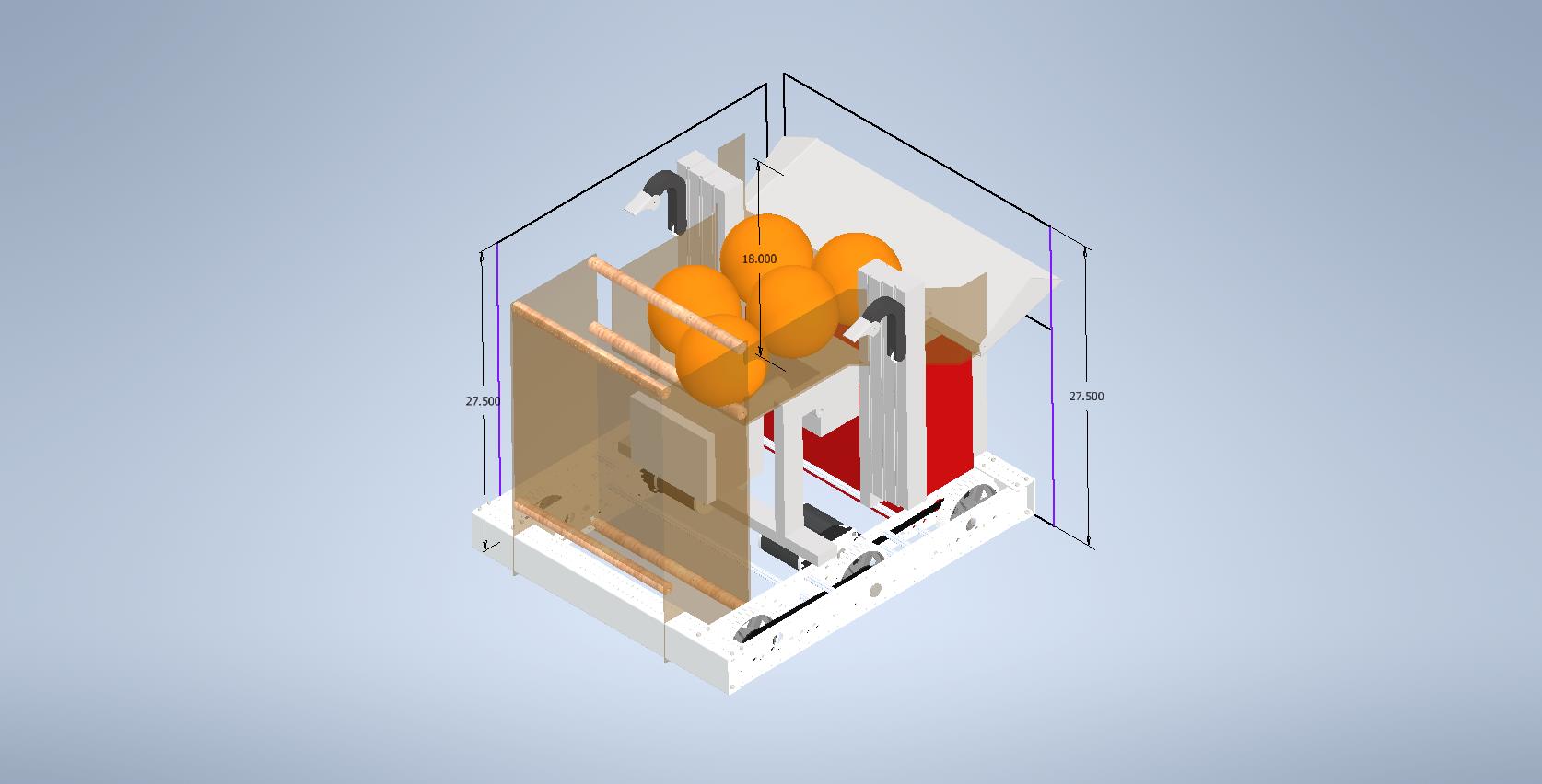

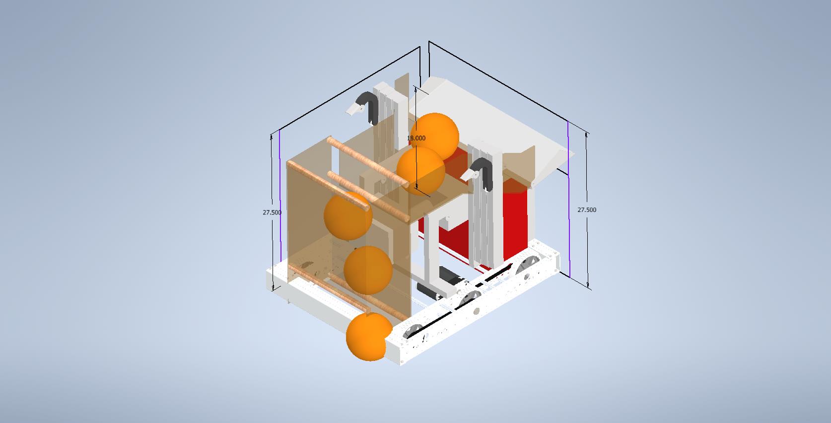

This shows the flap on the front of the box which will span the gap between the front of the box and the wall or the human player station.
This is a really quick rework of the original dumpbot design. It shows about how the box might hold all 5 balls. We will have to move the lifter further back, and out over the wheels in order to have have the box in the way.

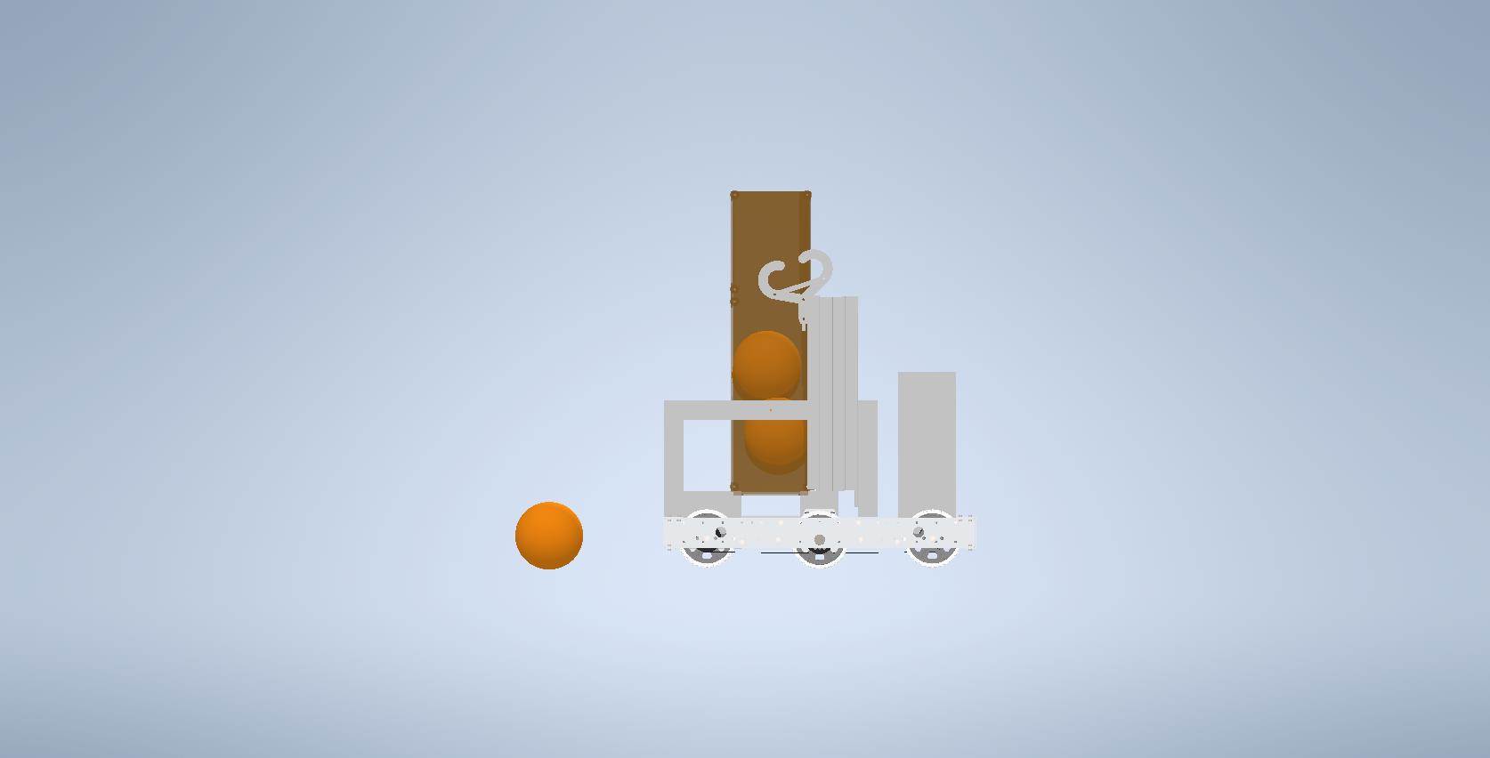

This picture shows the path balls will take when we floor load them. This capability would make it so we can score more points more quickly by only traveling as far as the next ball.
This shows the position of the box when we are dumping balls out into the low goal. This way we will be able to take advantage of the low goal which might greatly increase the capabilities of the robot.

Today was another productive day for us. We got the intake box CADDed, which is good because we are out of polycarb and it won’t get here till Sunday. Probably better if we slow our roll a little bit and really think things. A lot of the CADD work is done and pretty solid in terms of how things are going to be placed on the robot. We do need to figure out how to transfer power from one place to another in a few places.

Today Luke finished his design of the intake, and Makenzie modeled the lifter for getting the hooks up to the bar. I tweeked the frame a bit, making room for running the cables to the hooks. We also made a mockup of the box that might almost be good enough to use as is once we locate the servo that will open and close the front flap, and the piston mounts for tipping the box up to pour the balls into the low goal.

As for the frame tweeks…moved the front upright bars further out to make room for an intake that feeds into the ball elevator. I also got rid of the support bars for the lifter arms because they pushed the lifter too far out making it really difficult to run the pulley’s that will lift it, and also fit a motor behind it in order to actually make it/them actuate.
Finally the current plan is to make the frame out of 1/16th wall 1*2 aluminum square tube. We have traditionally gone with 1/8th wall…Hopefully this will be strong enough. have already made the brackets for connecting the various bars using rivets. In the past we have welded and even brazed tubes in our frame. Never really gone this route before so we’ll have to see how well it works. Hopefully we won’t be rebuilding our frame 5 weeks from now. Better get it built early so we have time to figure out what works and what doesn’t.

Luke’s intake/ball elevator are in, and it just happens to work out that a 10 inch piston should work perfectly on the intake arm without messing up too much else, though all of that might change tomorrow.

We have executable CADD models of the intake, ball elevator, dump box, frame, electronics box, pneumatics box, and hook lifter.
We cut out all of the frame members and about 90% of the brackets to hold it all together. We will probably begin riveting the frame members together tomorrow after final check of the CADD to ensure we know where all the mounting holes should go.

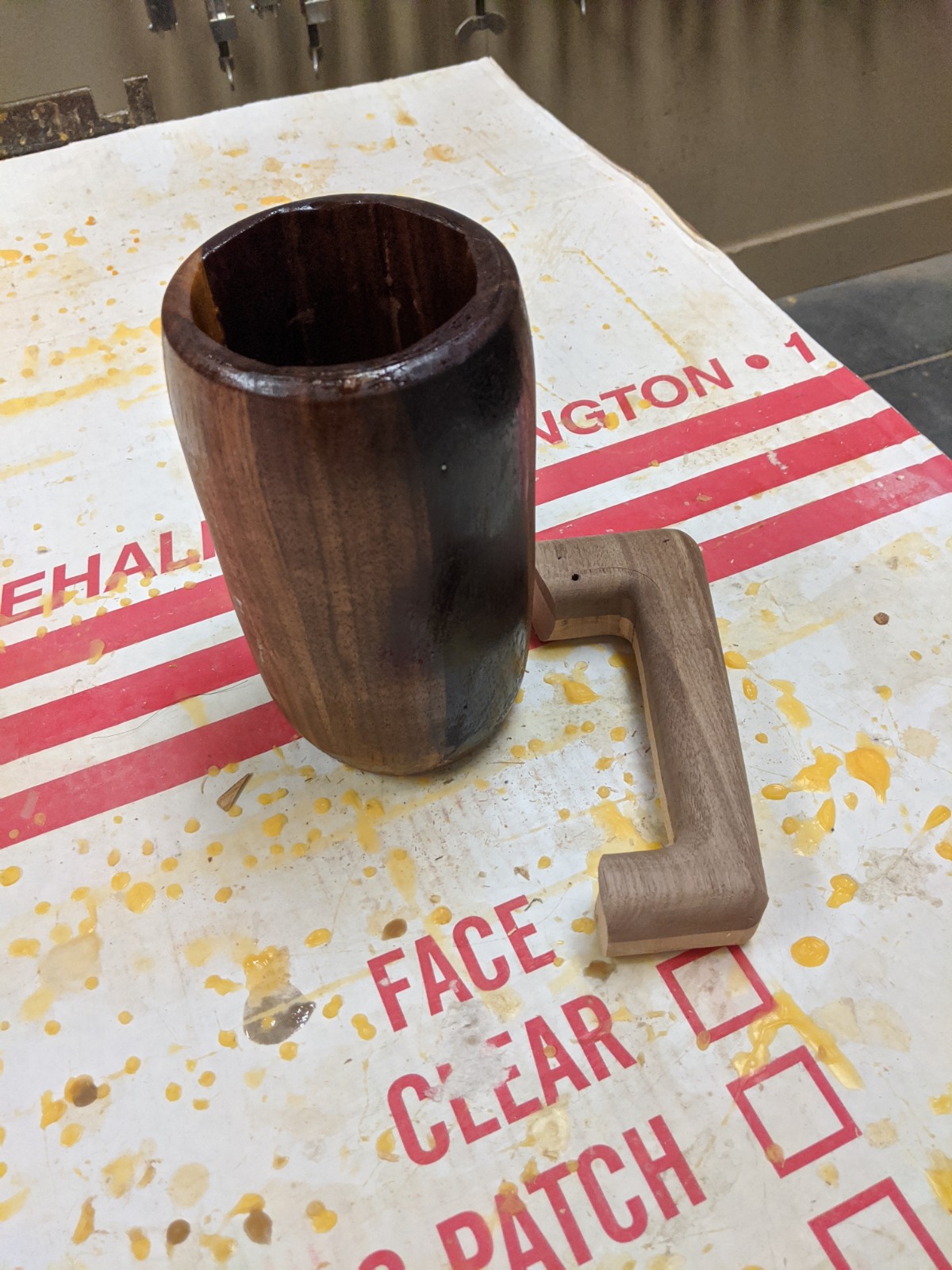

I worked on making a wooden beer stien. :slight_smile: Its my first one and I am definately learning a lot making it. I ordered a bigger chuck for my lathe so I can hold the next one a lot better. That will make turning the inside easier. I tried on my lathe today after turning a tenon out of some plywood and the whole thing came off the lathe like a badly snapped football bouncing around my shed for what seemed like an hour.
In anycase, I’m going to start a set of 4 next week for the auction so hopefully I can do a better job with those.
