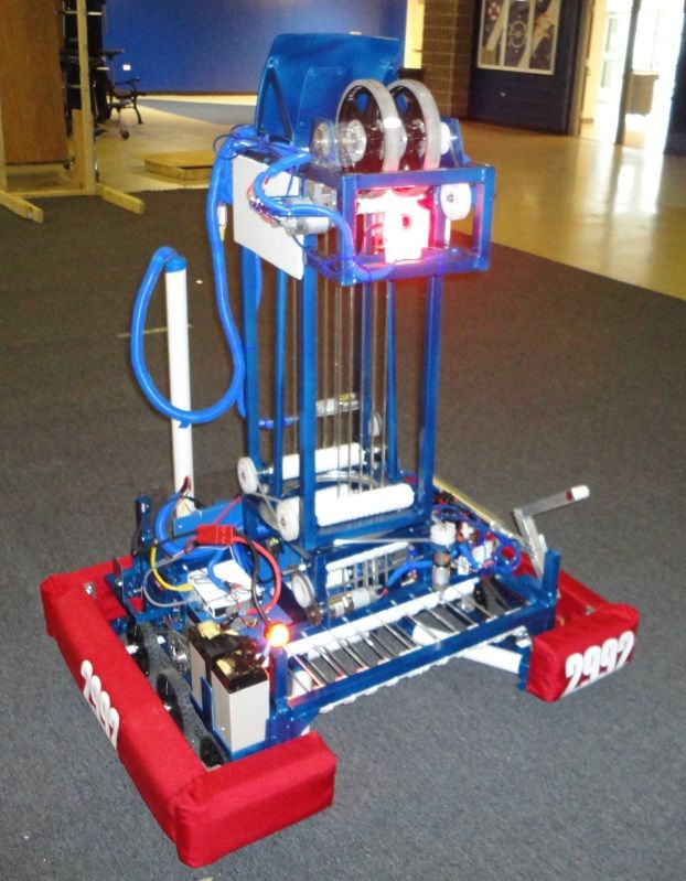

Mandeville Skippers, Team 2992, Rebound Rumble Robot:
Artemis (the Hunter)
http://img.photobucket.com/albums/v682/46auto/Forum%20Posts/CroppedBotPic.jpg
Chassis:
6 Wheel, dropped center, 4 CIM drive
Andymark 2 Speed Wide-ratio Super Shifters
Pneumatic bridge knocker
Turret:
Holds all 3 balls for consistent feed
PID driven, Encoder controlled shooter speed
Camera aimed
LED target illuminator
Dual motor shooter
(Interchangeable 775’s on Cim-u-laters or Fisher Price’s on 4:1 Banebots)
180+ degree turret rotation
We’ll see everyone at the Bayou, good luck!
