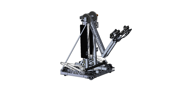

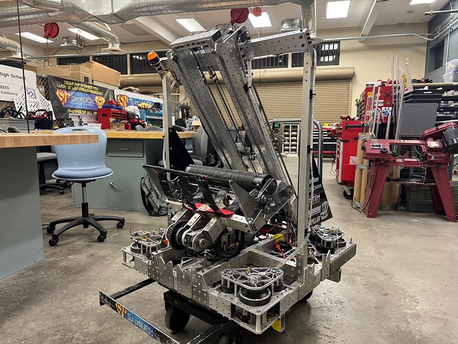

2023 Robot “Doc Ock”
Robot Reveal Video
General
  • 2 Piece auto
  • Self balancing auto
  • 115 lbs
Intake
  • 4” compliant wheel intake
  • Spring loaded rockers with surgical tubing
  • Dual Neo 550 powered
Collector
  • 2” flex wheel roller
  • 4 bar linkage deployment
Arm
  • Double pivot arm mechanism
  • #35 chain driven
  • Signal Falcon 500 gearbox for each pivot
Drivetrain
  • L2 SDS MK4i swerve modules
  • Falcon 500 powered for rotation and propulsion
CAD Link
CODE Link

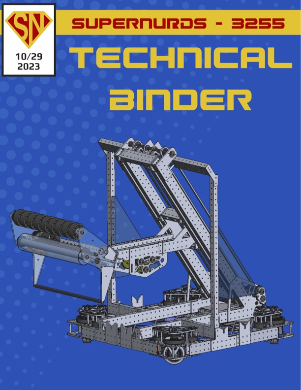

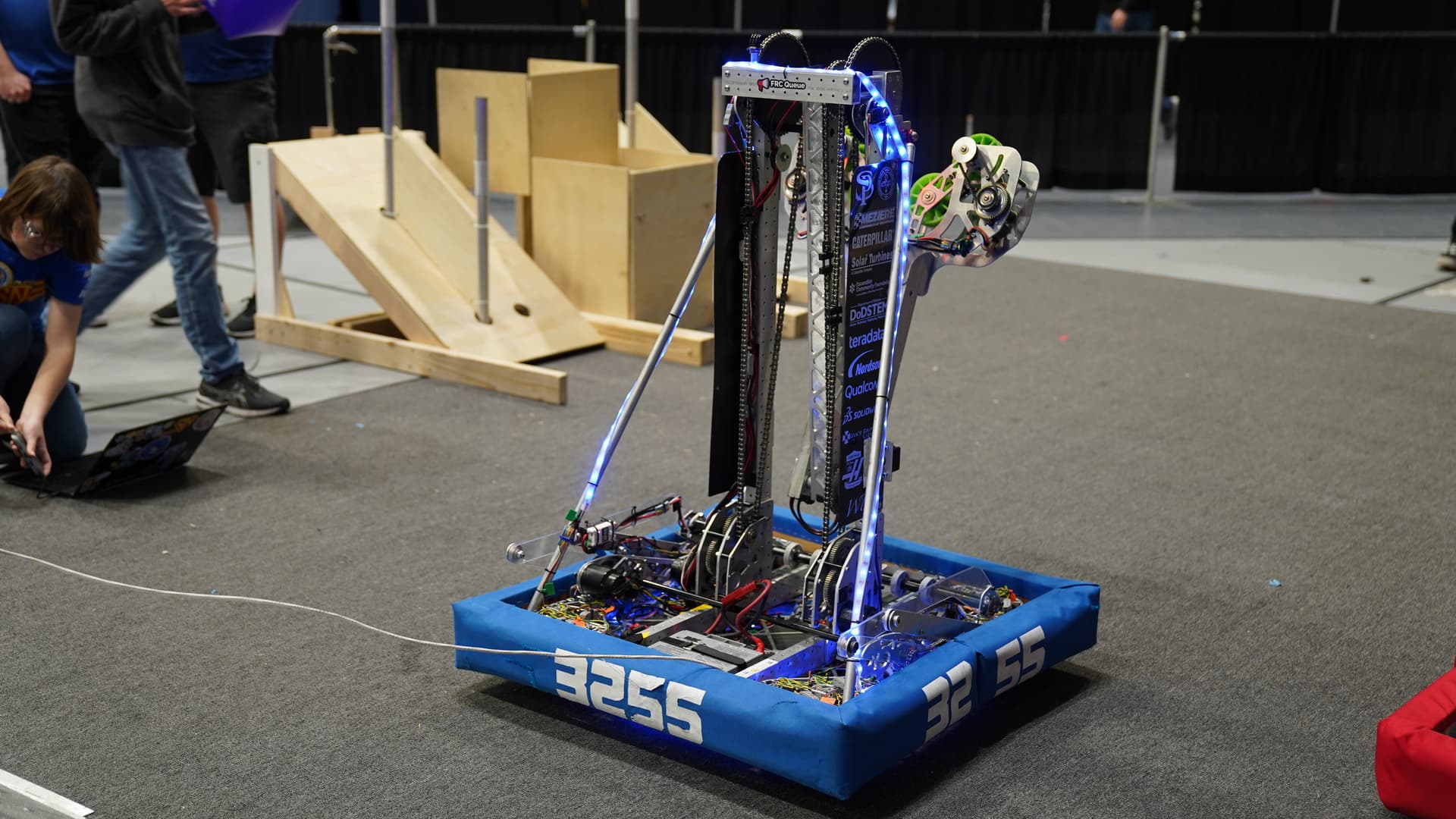

2023 Offseason Robot “Rhino”
Offseason Robot Technical Binder Link
Practice Match Footage
CAD Link
CODE Link
