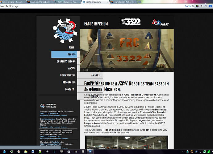

Once again, great job with the new website. Hope you guys do well this season. :slight_smile:
The menus are behind the text, or behind the picture. Chrome 19.0.1067.0
Other than that bug, great site! Wish ours was that good…
O.o Canary, huh? Odd as it works in the stable version of Chrome and is done using a z-index… you sure this isn’t an issue with Canary itself? I will look into it and try to fix it. Thanks for the bug report either way, and thanks for the compliments. :slight_smile:

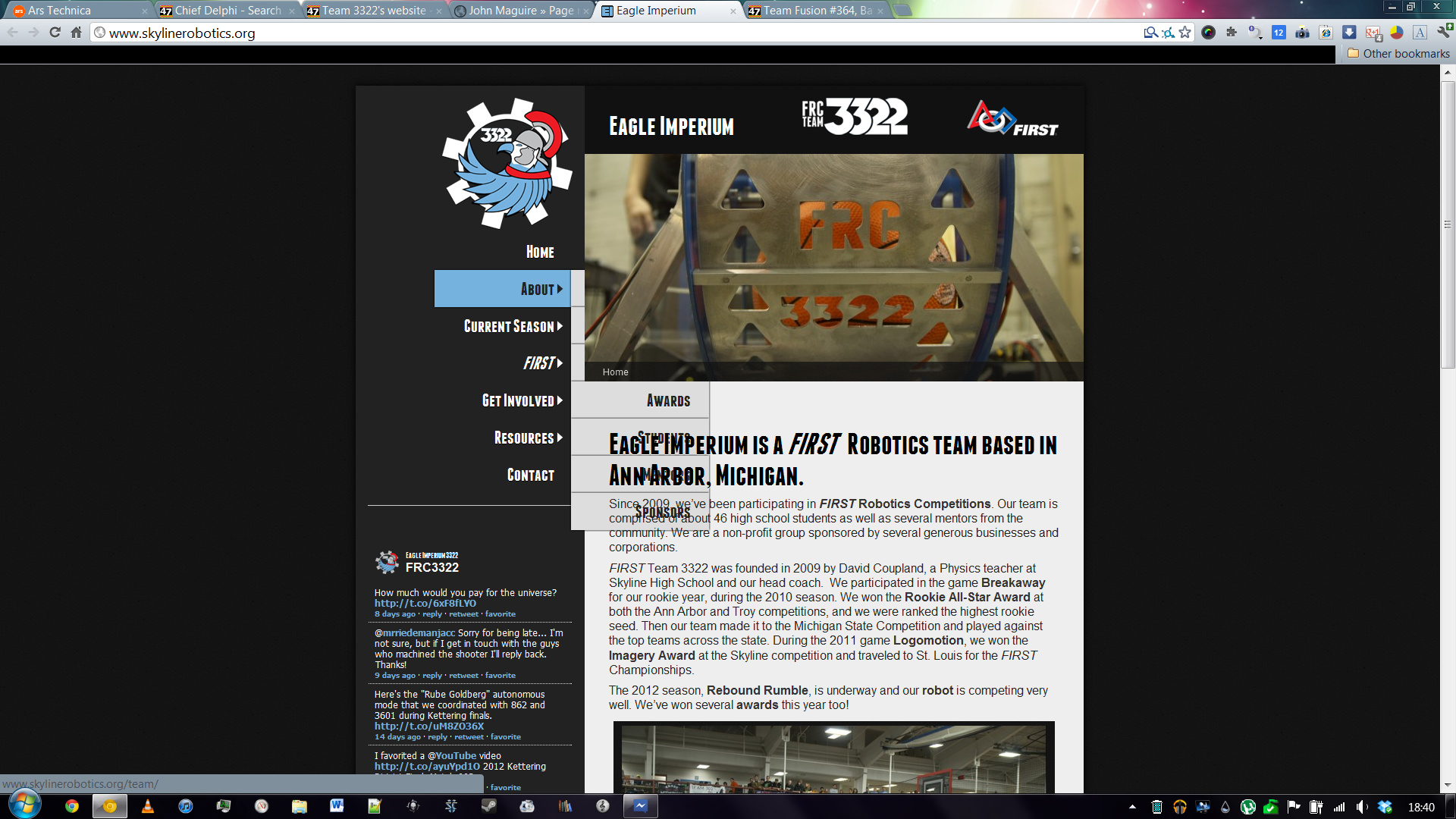

Do you mind telling me what you see on this website?
Also, can you try our site again? I made a change, but I can’t test as my good laptop died, and I’m having to use this temporary one… which can’t run Chrome. -_-
Still has the “hiding behind image and text” problem, unfortunately…
