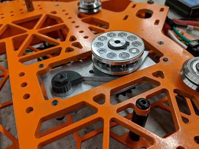

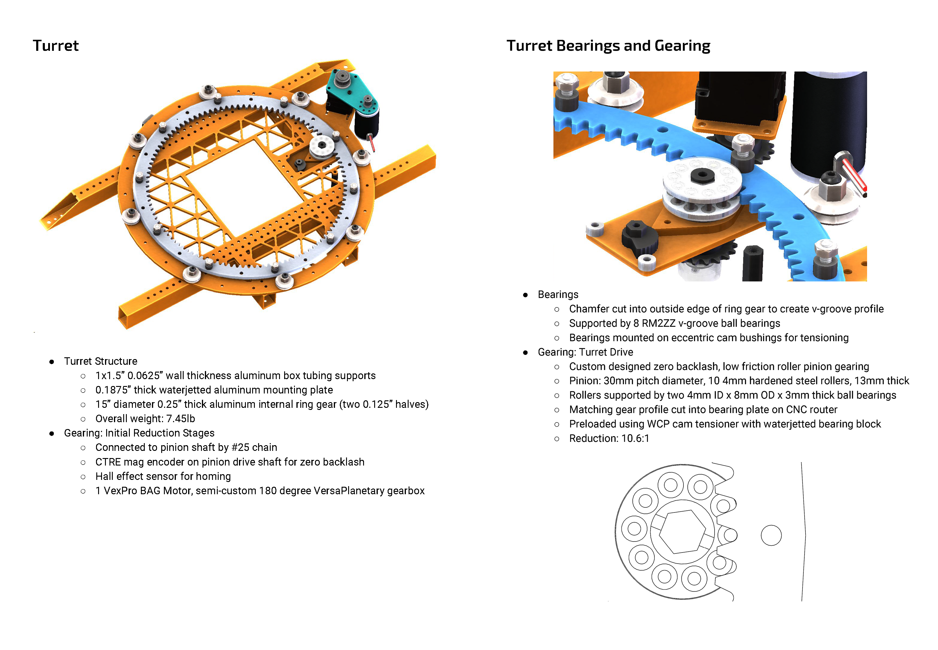

We are using a custom-made roller pinion drive that basically consists of a pinion with rollers arranged in a circle and a large internal ring gear. The rollers are on bearings and rotate freely instead of sliding against the gear teeth, so it has very low friction. Due to the nature of the design, there is practically no backlash if it can be manufactured accurately. We made the ring gear on a CNC router and CNC milled the bearing holes on the pinion.

Here is our whole technical binder for this year’s robot:
Technical Documentation.pdf (2.2 MB)

How did you generate the tooth profile on the turret gear to get it to mate with that pinion? That whole turret rotation mechanism is just amazing.
I can honestly say I’m in love with your turret. Wow.
Ditto this question.
Could you elaborate a bit more about that pinion and roller assembly you have that rotates the turret gear? Specifically how you machined/assembled them and where you got the 4mm roller pins and bearings from.
4x8x3mm MR84ZZ bearings from VXB: https://www.vxb.com/MR84ZZ-Miniature-Shielded-Bearing-4-x8-x3-p/mr84zz-1.htm
4mm hardened steel shafts from McMaster: https://www.mcmaster.com/6112k12
Here’s a drawing for the pinion body:
We turned the overall shape from 1.75" round bar stock on a manual lathe and hex broached the center hole. The bearing holes were milled on a Haas Mini Mill and sized so the bearings can be press-fit in tightly. We used aluminum soft jaws to hold the pinion for this. For drilling the set screw hole, we put the pinion on a hex shaft, clamped the shaft to a piece of scrap aluminum to keep the hex oriented correctly, and drilled the hole with a drill press. The reason for using a set screw is to minimize backlash between the pinion and the encoder on the other end of the shaft due to poorly fitting hex shafts.
The pins were cut to size with a dremel from 4mm hardened linear shaft stock (the only 4mm shafts McMaster sells). The ends of each shaft were given a very slight taper with a bench grinder to reduce the amount of force needed to press them into the bearings. We pressed bearings into all holes on one side of the pinion, then inserted the pins, and then inserted the bearings on the other side.

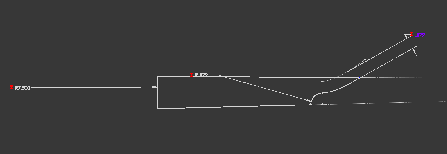

Each roller on the pinion would trace an epicycloidal path if the pinion were rotated around the inside of the ring gear, so the tooth profile would be offset from an epicycloidal curve segment with a circular root the diameter of the pins:
Here are some parametric gear templates I made in Solidworks using equation-driven curves to generate gears like this:
roller pinion drive external gear.SLDPRT (1.3 MB)
roller pinion drive internal gear.SLDPRT (1.4 MB)
Note: the actual gear on our robot uses an approximated tooth geometry (straight line instead of an epicycloidal curve) because I had issues getting equation-driven curves to work correctly. It had almost no noticeable backlash and worked fine, so this is a potential solution in CAD software without equation-driven curves such as Fusion 360.
