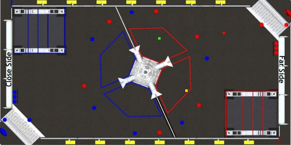

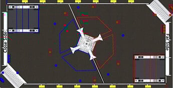

Here is Code Orange’s scouting data from OCR! For each data field with coordinates, each coordinate corresponds to a pixel on the image.
For drawing out the Auto Path, we used the image below (600px by 460px).

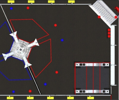

For marking shot locations, we used the image below (600px by 300px).
The cycle count and teleop path fields are used together to mark shot locations and shot percentages. For example, a cycle count field with this data: [[1, 2, 0, 0], [2, 1, 1, 0], [3, 0, 2, 0]] and a teleop path field with this data: [[326,77],[382,185],[459,66]] allows us to display the image shown in the image below. We color the different location squares based on the shot percentage, with Green indicating 100%, Yellow indicating 50%, and Red indicating 0%.
Shot-Location-Example
