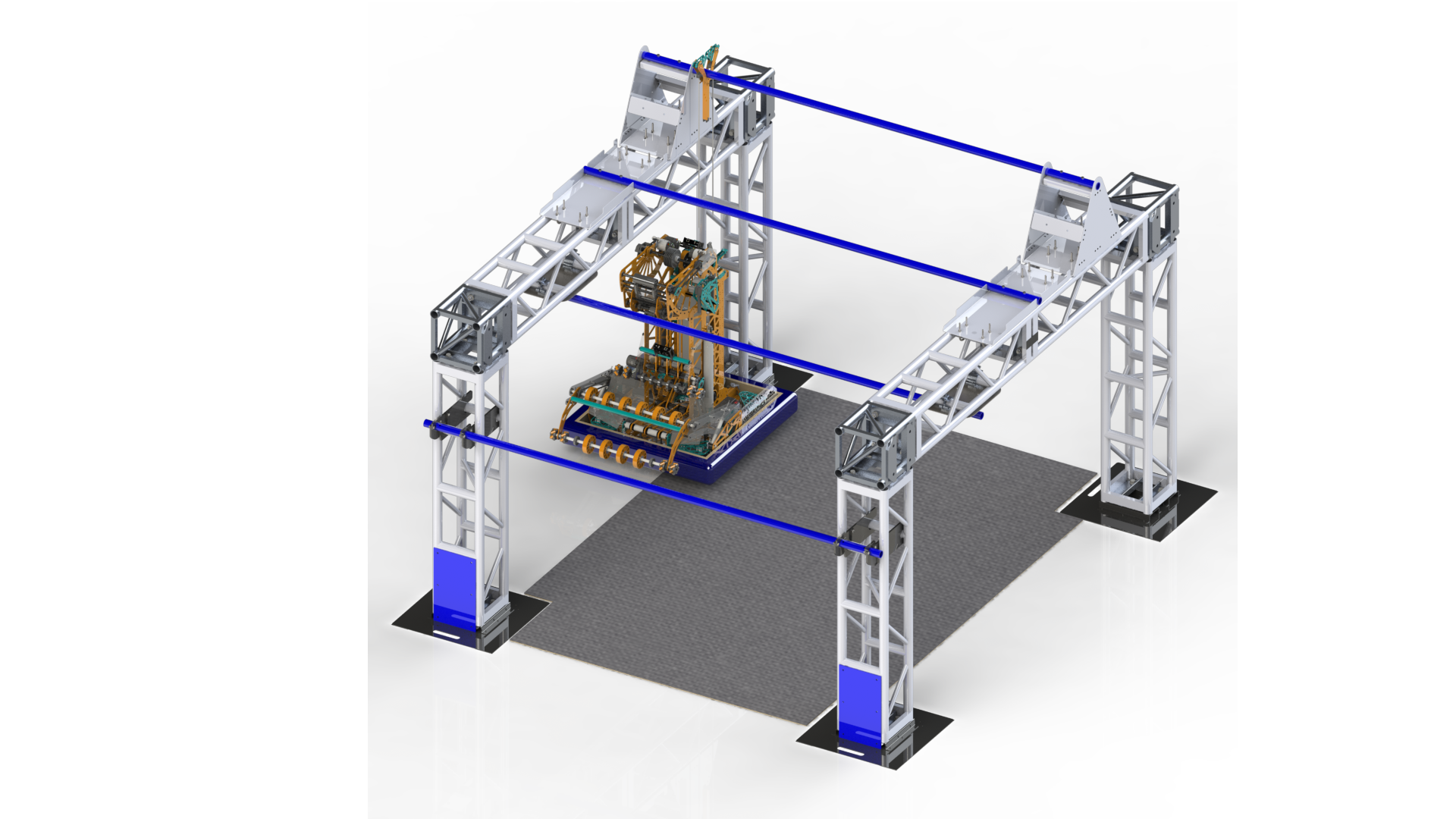

Team 3476: Code Orange presents "Project Orange Time"
Since Week 4, our team has been working on a T0 climb that deploys to the traversal bar and pulls our robot up after the round ends with pneumatics.
Due to the latest team update, we won’t be running this at champs, but we wanted share it anyways.
Special thanks to Team 6328 for the idea from a few weeks ago!

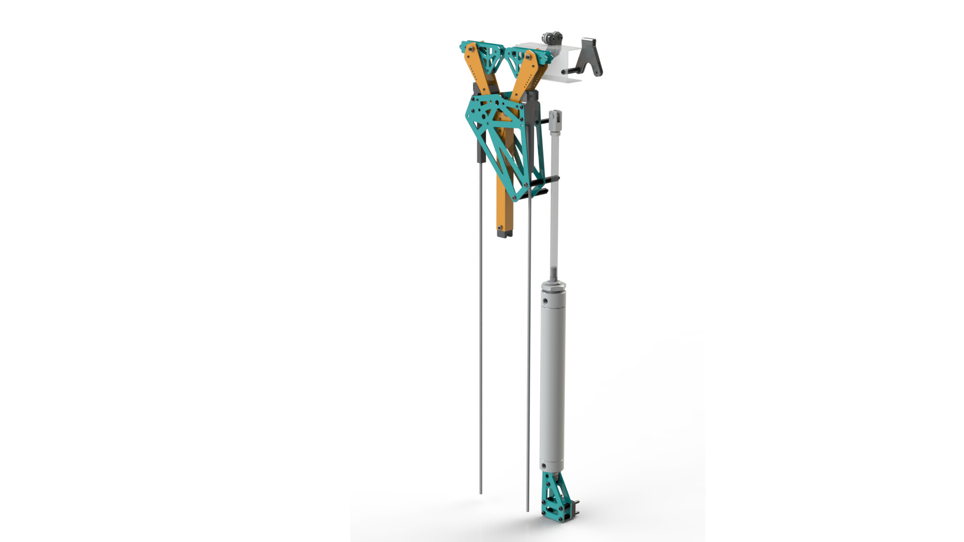

Here’s how it works:
  • When robot is disabled, pneumatics reset do their default state automatically
  • We have a grappling hook on our robot that is locked in with a pneumatic with default state in
  • We have a massive 2" Bore, 12" Stroke pneumatic strapped to the side of our robot and bolted to our superstructure that is also default state in
  • When robot is disabled, our locking pneumatic disengages and releases the grappling hook that flies up to grab onto the traversal bar. The lifting pneumatic disengages more slowly with the help of a flow control valve to pull the robot up.
Here’s a video of the climb:

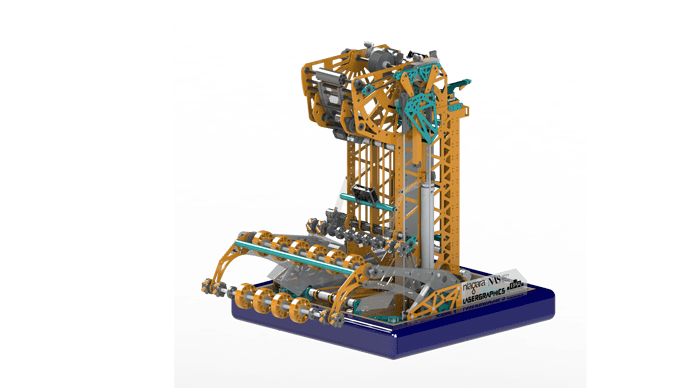

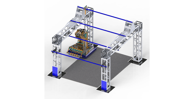

Quick follow up: Here’s a couple more images on how it looks mounted on our robot and what it looks like in the hanger zone.

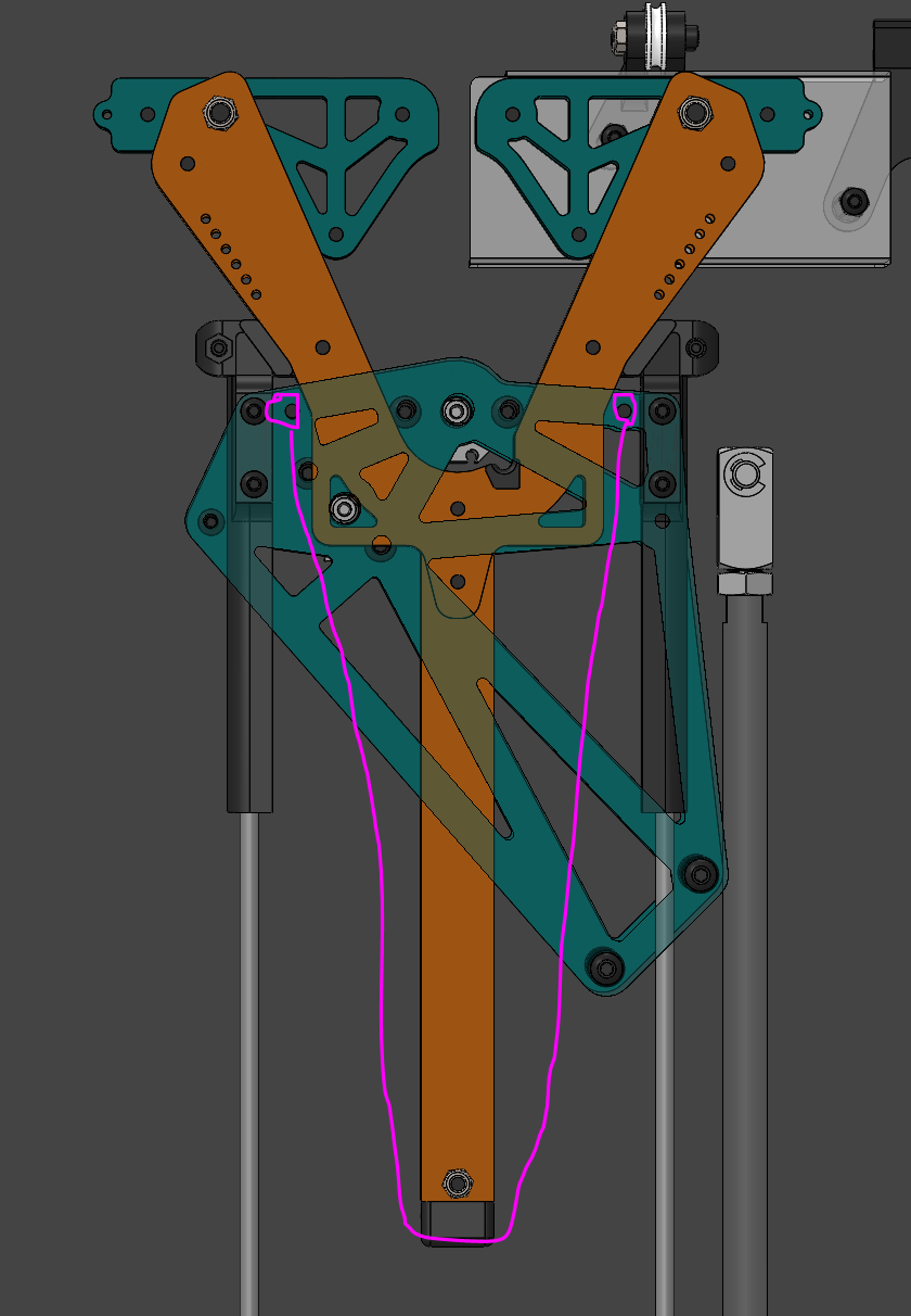

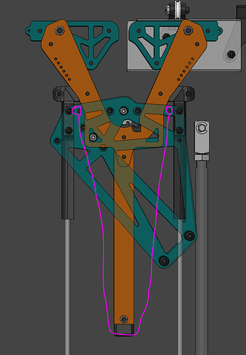

I’m a bit confused. What makes the grappling hook passively want to shoot up?
Love it.
What changed your opinion?
-Nick
Sorry, kinda neglected to mention that in the post haha. We have a surgical tubing slingshot that’s tied to the launcher plate and its hooked around the base of the grappling hook.
