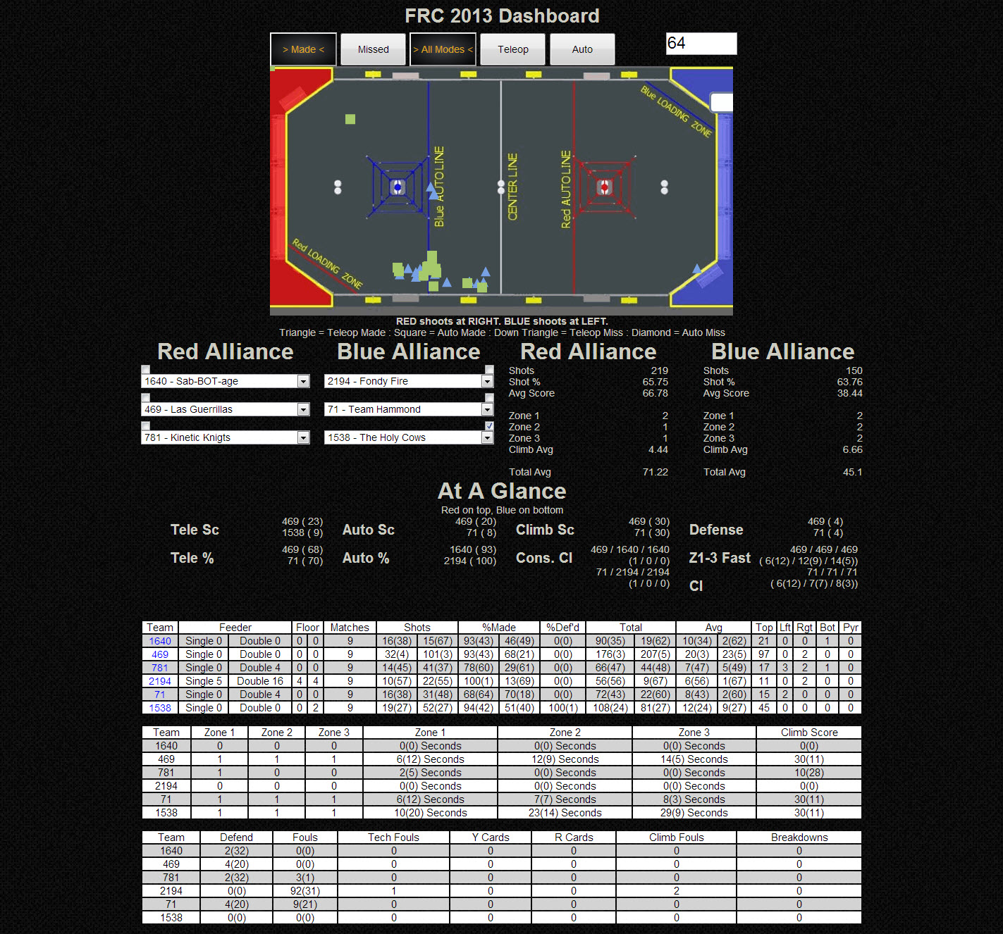

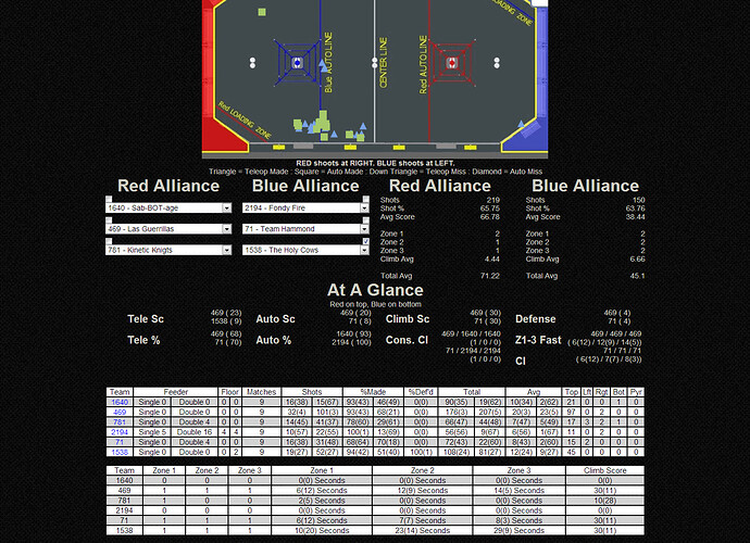

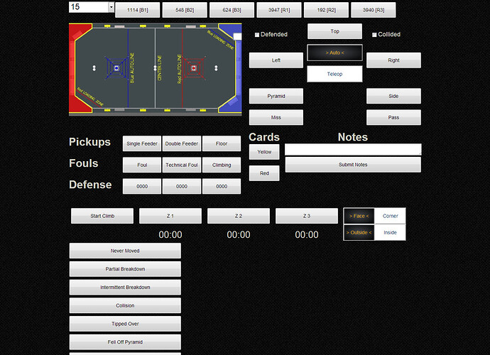

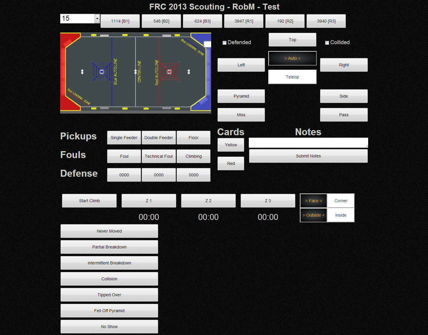

Great Scouting sheet. We have incorporated many of your same attributes into a web-based tablet application. This gives our drive team real-time statistics for strategy planning. We are heading to St. Louis and our intent is to scout all 4 divisions. We would love to share our application with anyone that will help with a little manpower scouting.
