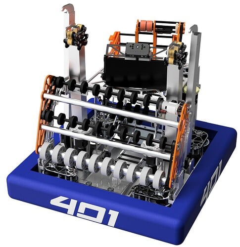

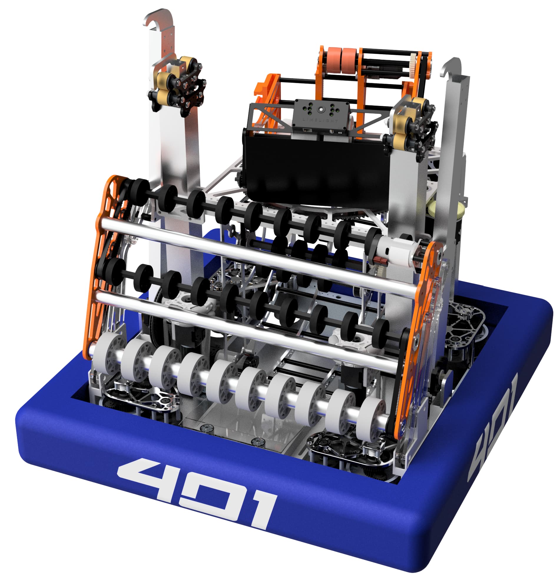

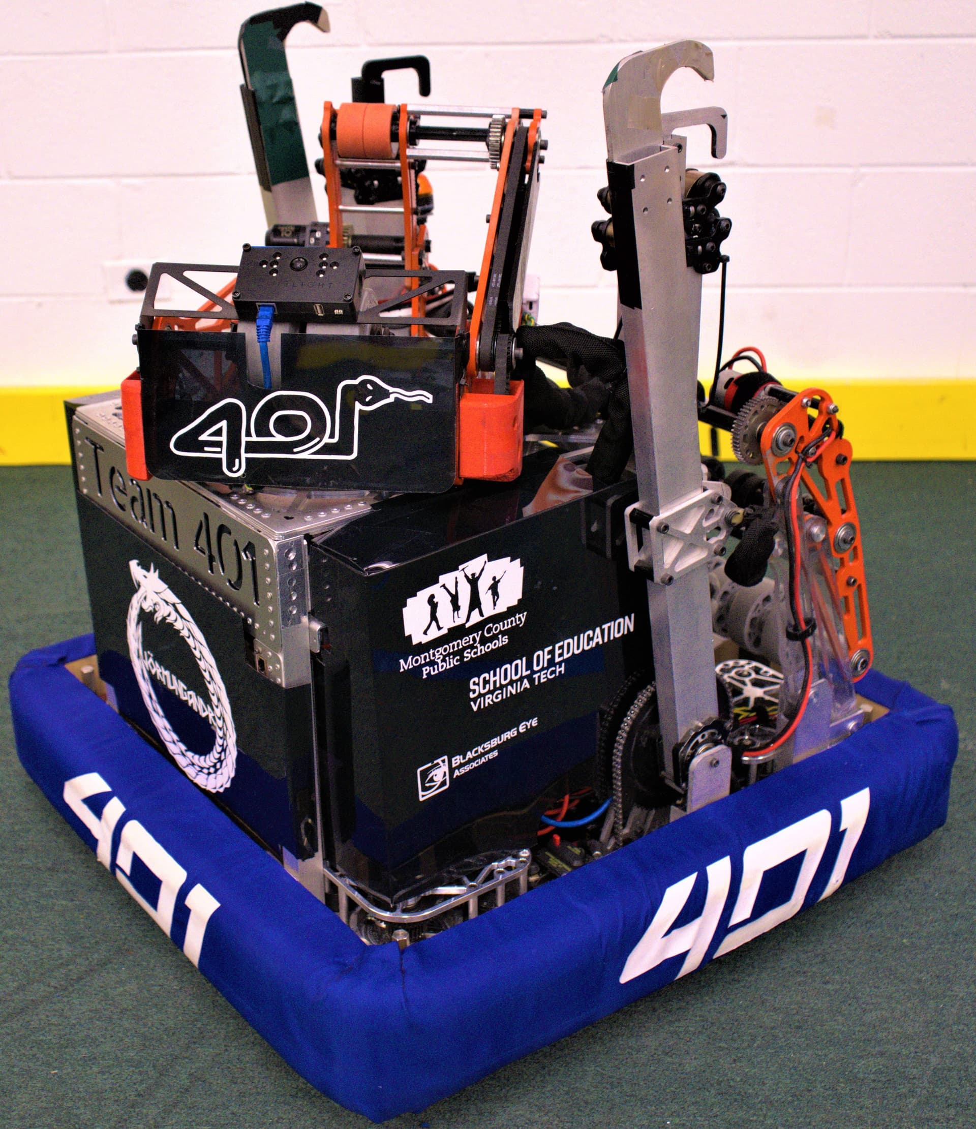

2022 Robot - Jörmungandr
Tech Binder and Onshape Doc
Robot Features
  • SDS MK4i L2 swerve modules
  • Motor actuated, full width 6 bar intake
  • 540° turret range
  • Continuously variable hood with top roller
  • Dual Thrifty telescopes + intake hooks for traversal climb

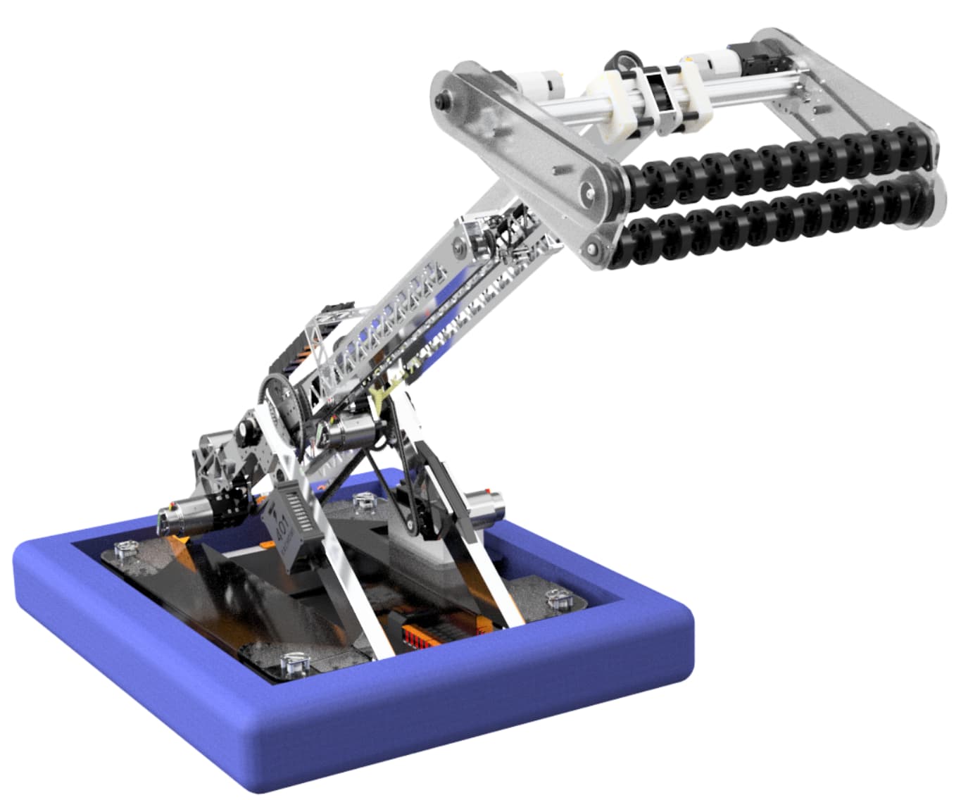

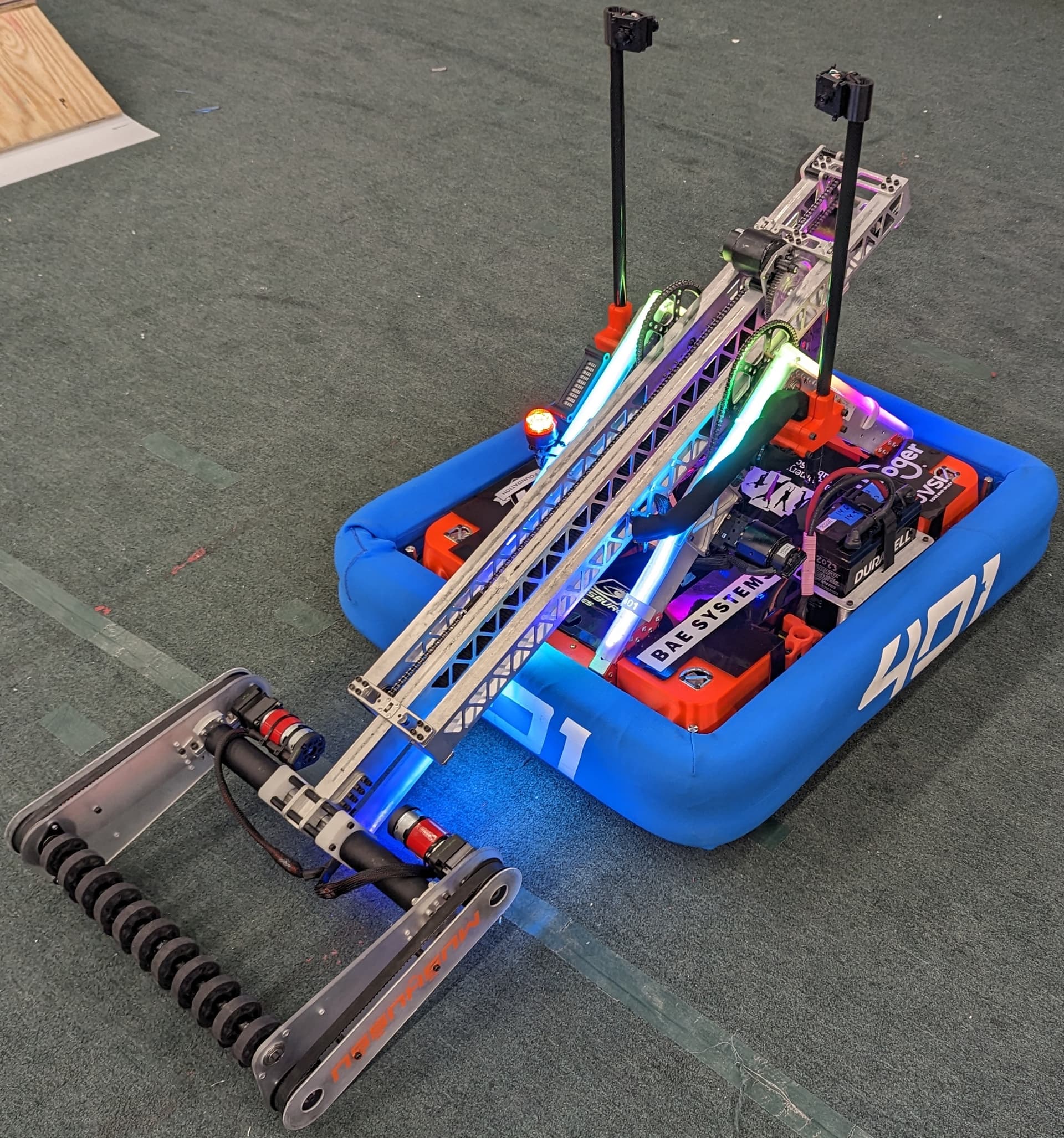

2023 Robot - Mušḫuššu
Robot Features
  • “Not Quite Pink” Arm with 250° of rotational range and 30" of extension
  • Belt in tube driven wrist with 330° of rotational range
  • Grabs cone flange or tip from any orientation from both sides
  • Scores cones and cubes out either side of robot
  • Hour meter to track robot enable time using toggleable PDH slot
  • Toggle switches for brake/coast mode for all motors and for all LEDs on the robot

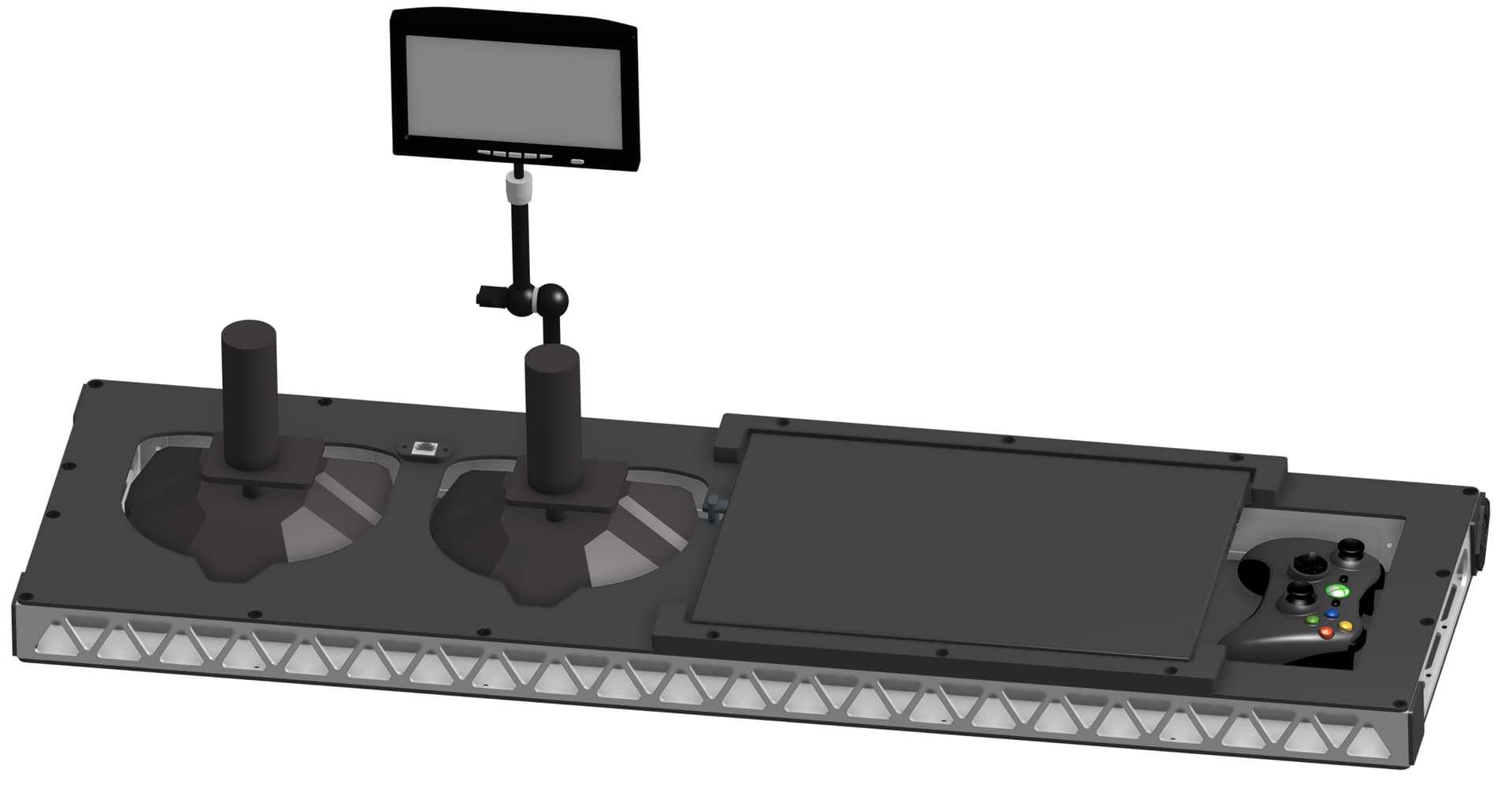

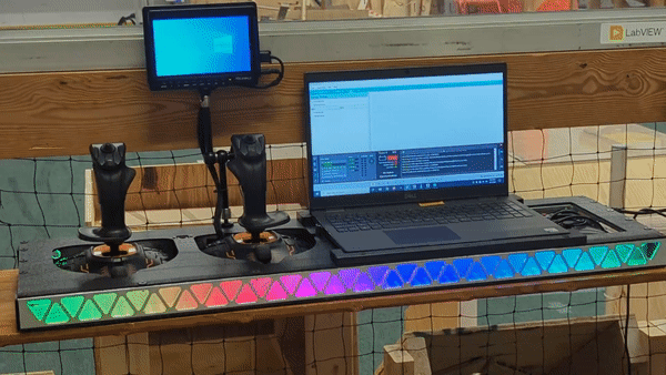

Driver Station
ds
Onshape Doc
Features
  • 2x Thrustmaster t.16000m joysticks
  • 1x Xbox 360 controller
  • 200+ RGB LEDs with serial comms to laptop
  • Heads up display on SmallRig arm
  • Ethernet bulkhead for connecting to field
  • Integrated C14 power plug for charging laptop
  • USB C dock to connect all peripherals

where did you get your heads up display and arm for the driver station?
Very nice, clean CAD. Just curious why two joysticks? You don’t use the twist axis of the joystick to rotate the robot?
I love your driver station. Simple but clean. A lot of ones I’ve been looking at to try and find some inspiration have been way over complicated. This is almost exactly what I had planned. Thanks for this
They’re both from Amazon: Arm, Monitor
Correct. The left stick is robot translation, the right stick is robot rotation, it’s called split arcade and is a pretty common control style. We’ve played with using a single joystick and using the twist axis but have always found it’s hard to do pure translation or pure rotation in that setup so we stay with split arcade. It’s also nice to have more buttons available for rarely used bindings or test modes.
