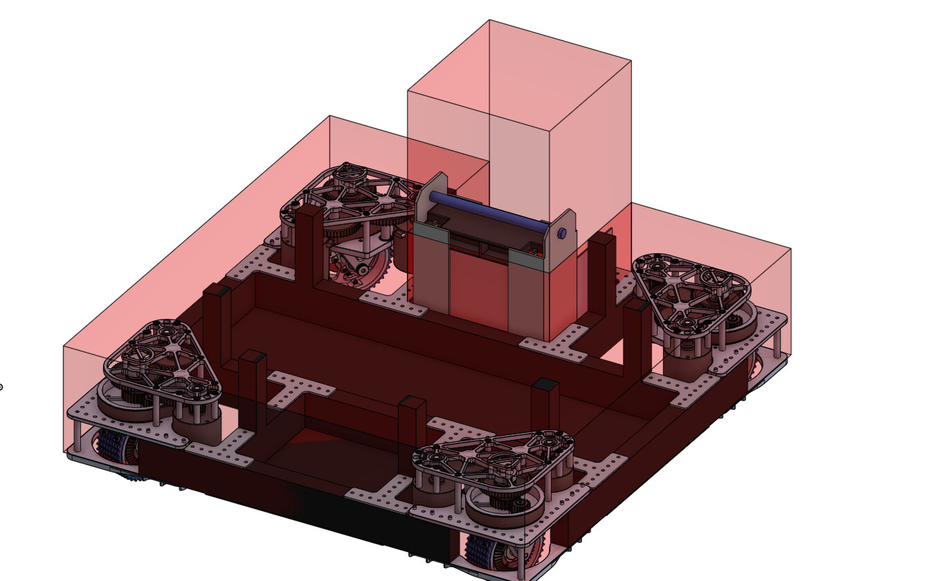

The velcro-strap and custom battery block based battery holder

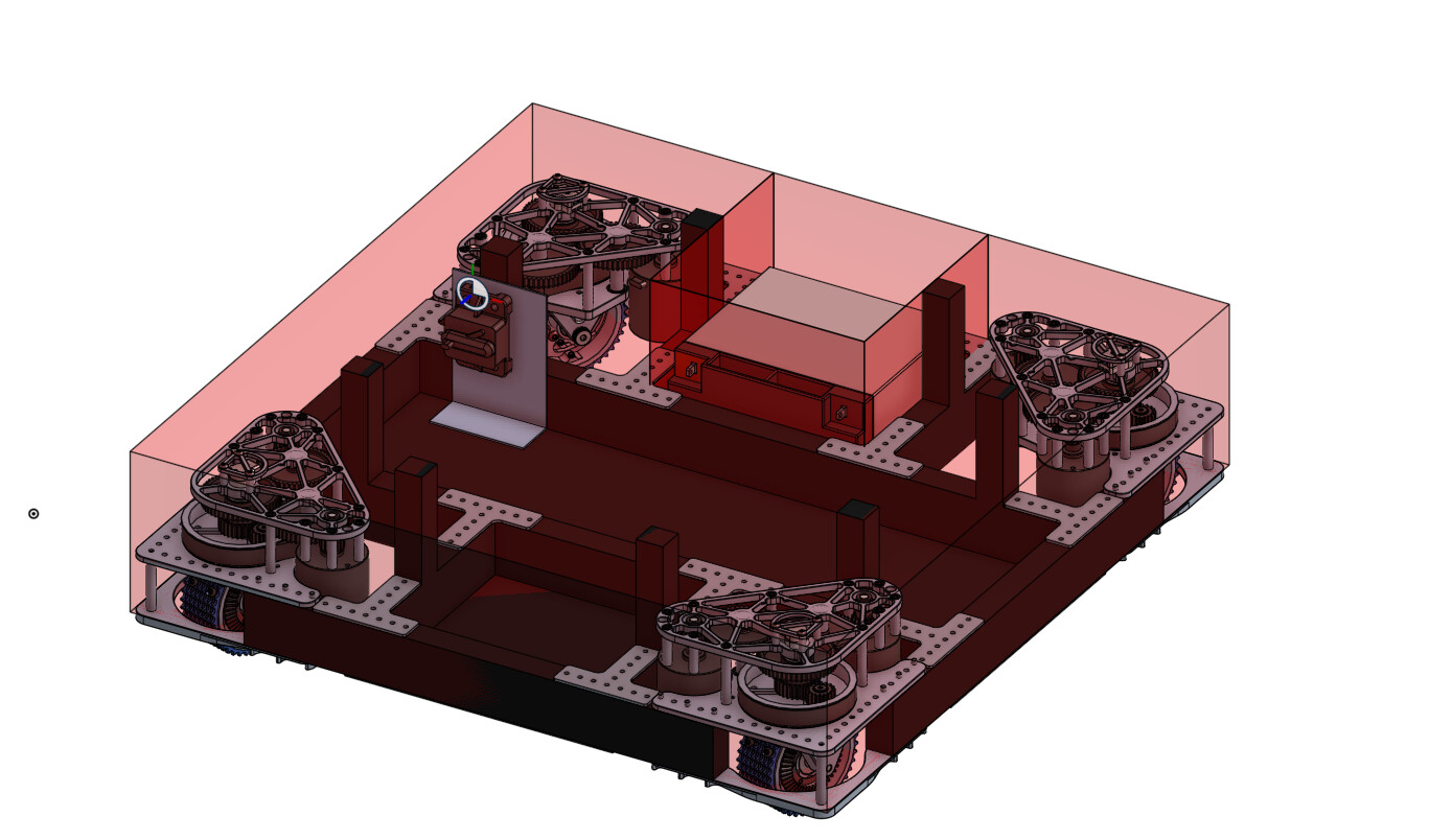

To clear confusion, the red boxes are constraint zones; basically telling the design team not to put anything super critical in that area to keep electrical accessible.
We hope other teams see this and use this for their Mk4i drivebase!
Drivebase CAD
Battery block CAD (modified one from the AndyMark one. Uses 1/4-20 bolts)
Traditional battery box based battery holder

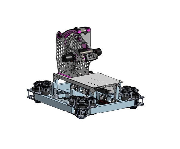

Here’s what an example of something mounted onto the drivebase would look like, which is our Bunnybots 2023 shooter.
