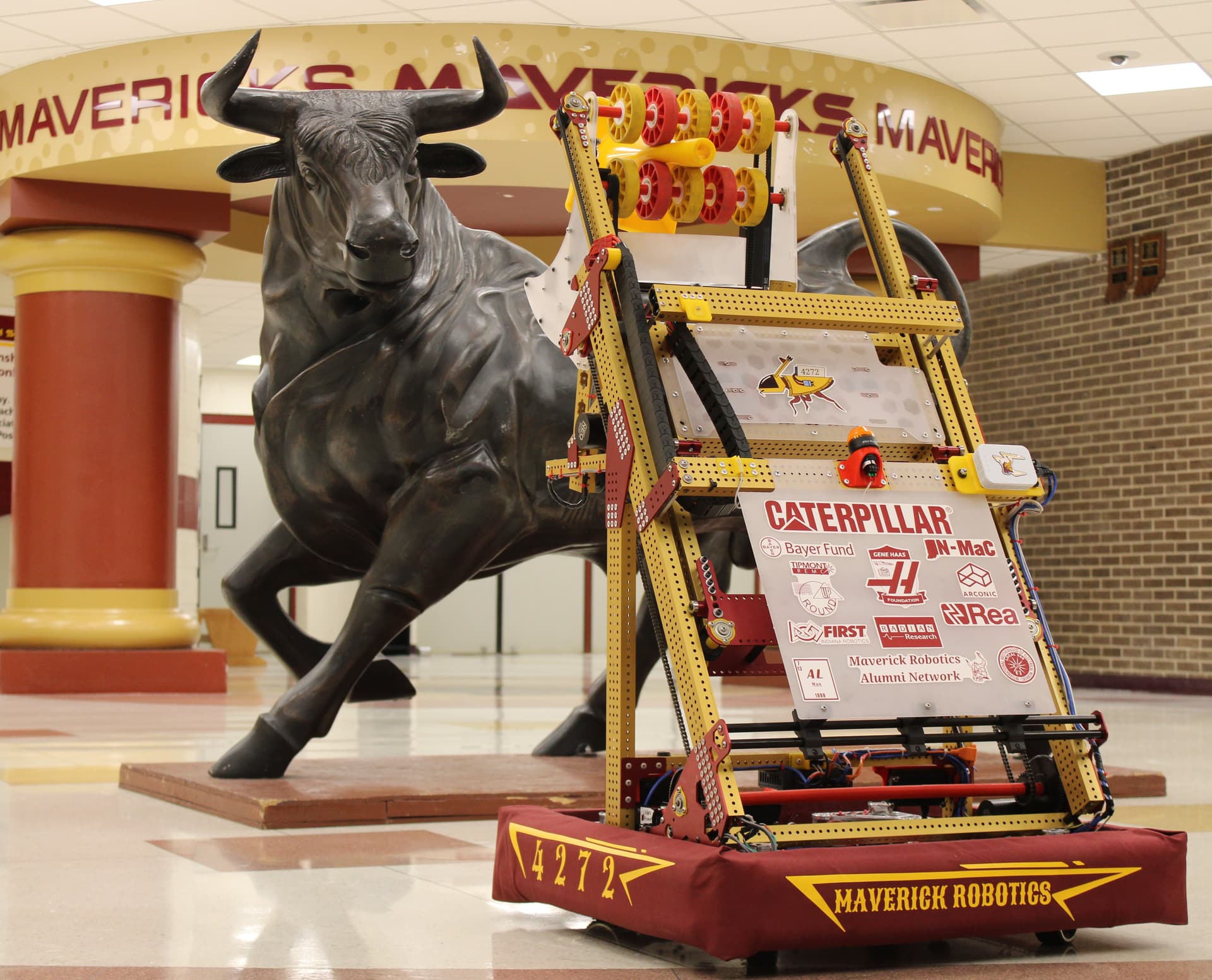

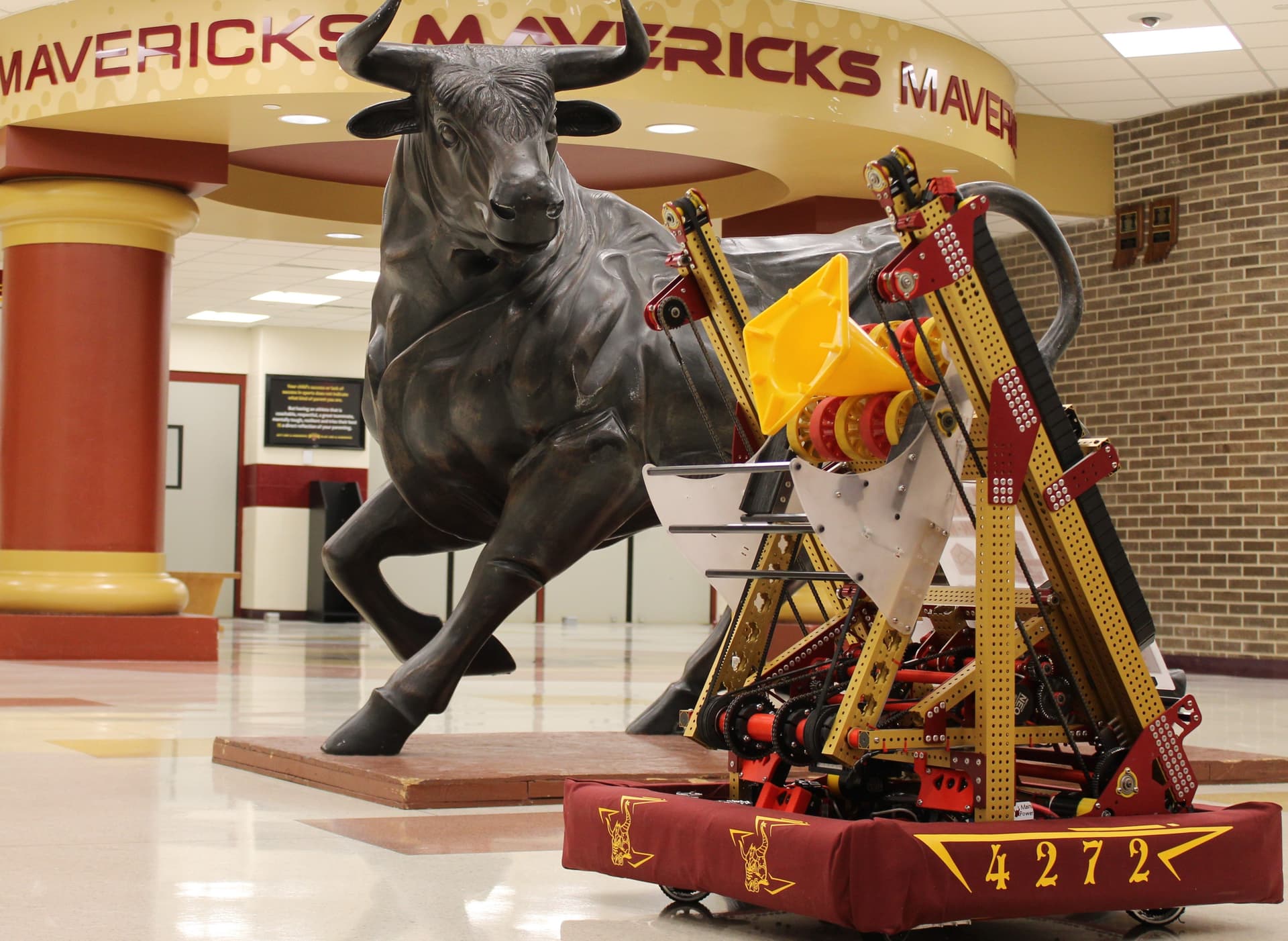

Team 4272 is proud to present our 11th robot - La Cucaracha.
This year we put a strong emphasis on robot reliability. The goal is to be difficult to kill - like a Cockroach.
Some fun Highlights:
Fun Cockroach Highlights:
No Pneumatics
Clean Command-Based Code
All Bearings retained with bolts
Rope-less Elevator instead using Timing-Belt and Chain

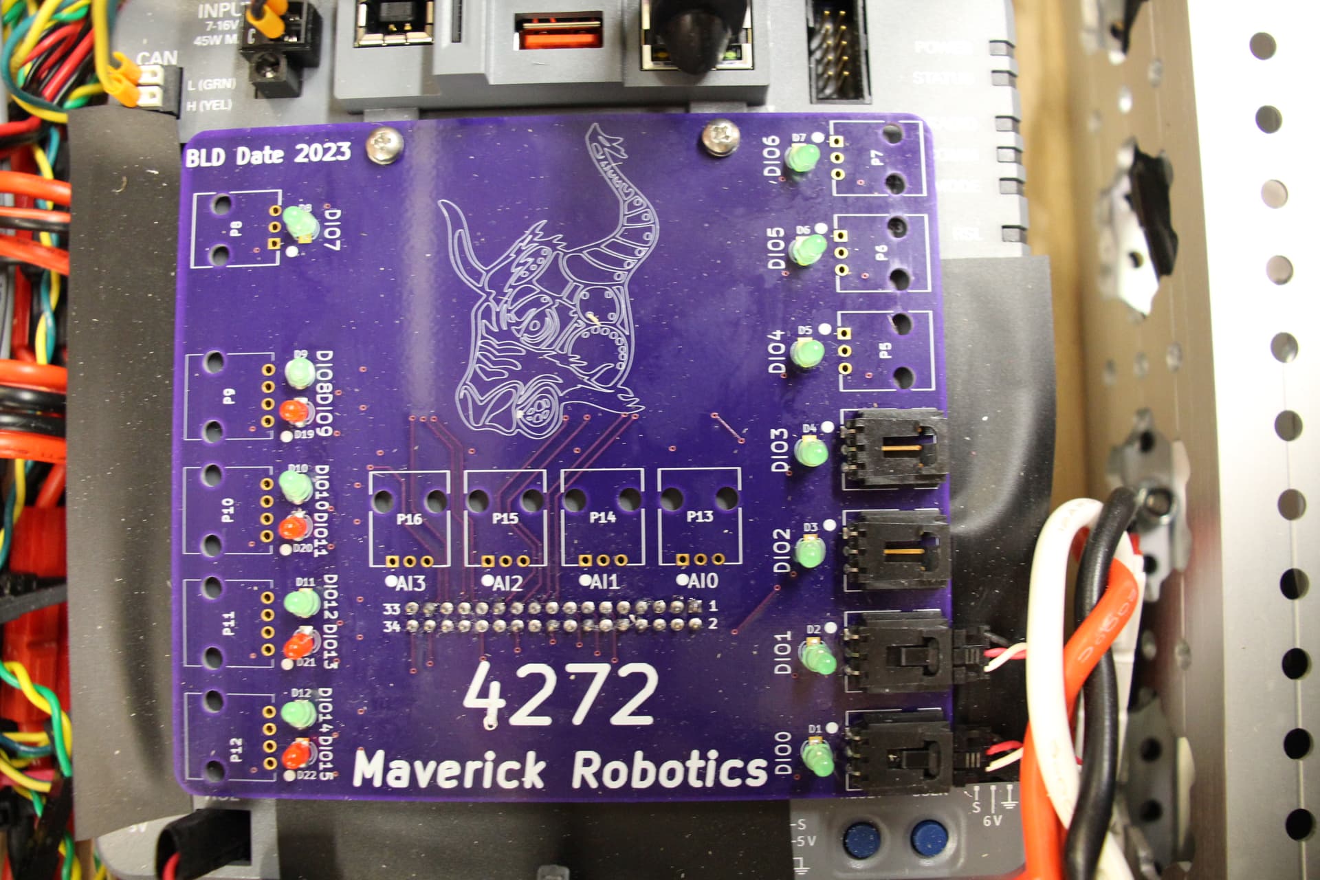

Custom MAVcoder and Spark Max Breakout to reduce the number of CAN devices
Standardized to Molex SL on CAN wires, Sensor Wires, and Neo Sensor Cables

I love the zip-tie strain relief built into your 3DP Spark Max mounts. We need to steal that idea

Cool. Please do. We are really happy with how this turned out.
CAD file for our design is here and on printables here .
We’re very excited to see everyone at Princeton this weekend!!
Noice! Looks VERY solid. See you this weekend!
