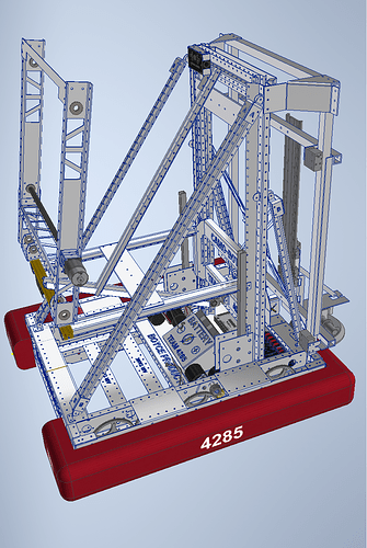

We are switching to the 2910 MK2’s for this year. We designed our practice drive-train to be as easily repairable and structurally sound as possible. Most parts are laser cut and bent with 1/16" and 1/8’ inch aluminum 5052 sheet metal.
2019 Robot CAD - Team 4285
2019 Robot Code - Team 4285
Our 2019 robot Maverick was also made mostly of laser cut and bent aluminum 5052 sheet metal.
All CAD design were made with Autodesk Inventor.
