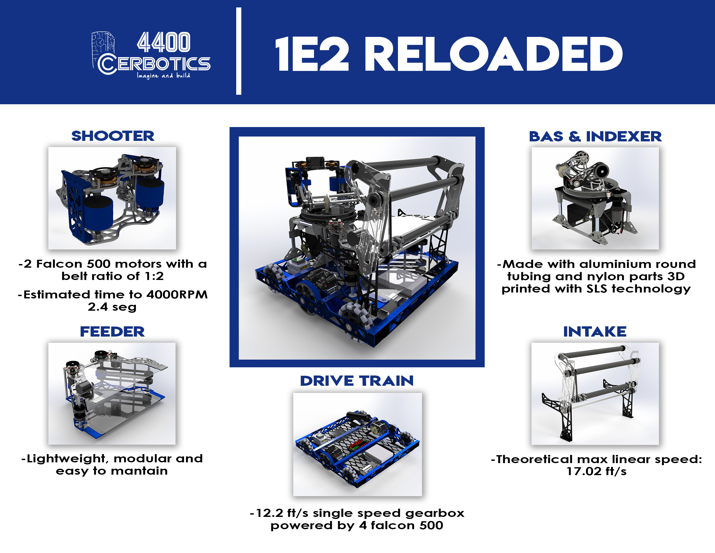

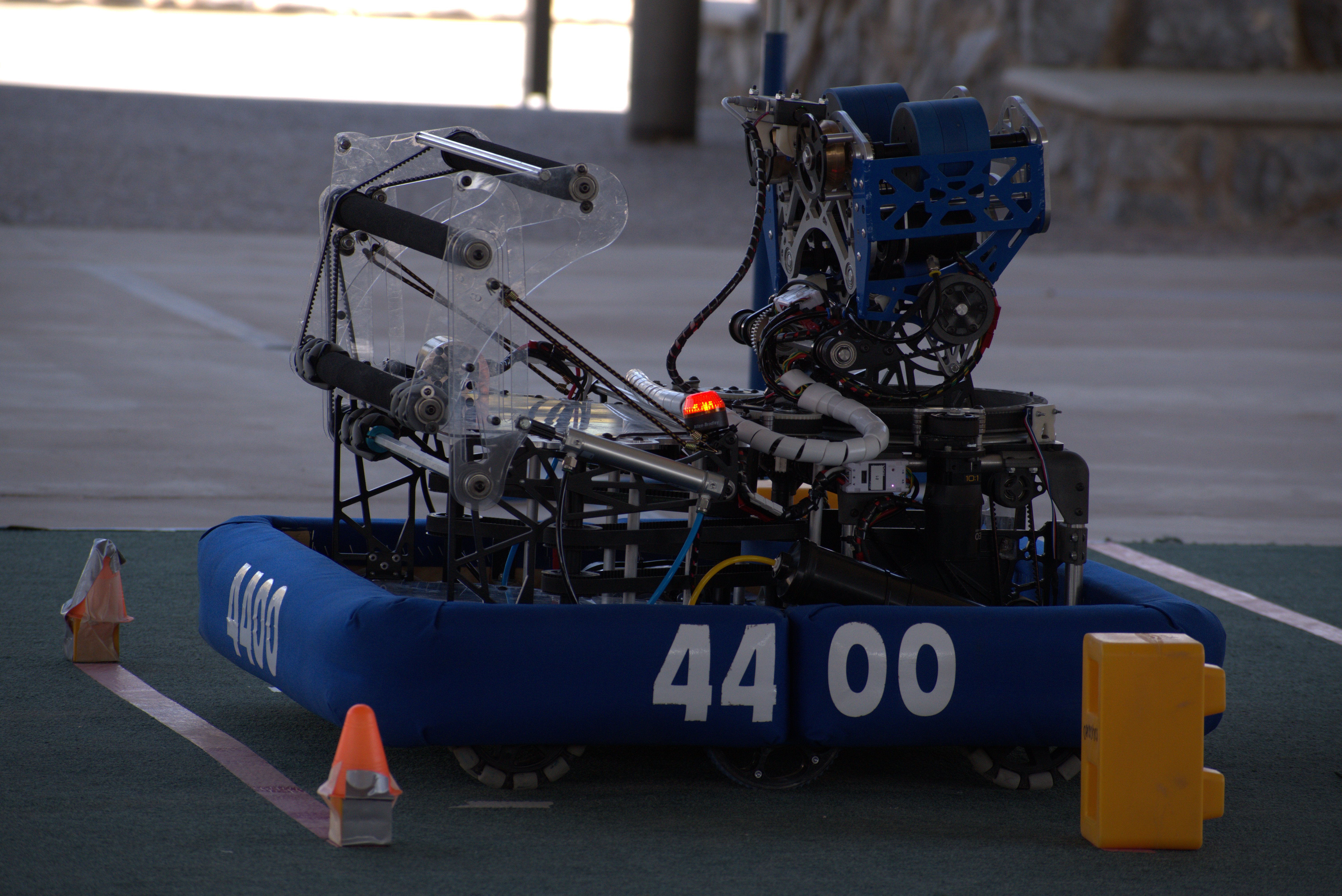

Here are both our robot and the videos we had and uploaded for this 2021 season. Hope to see all of you in person soon. Greetings!
Robot photos:
Robot presentation
Robot flyer

What motivated you guys to go for the double flywheel shooter instead of a hooded shooter?
We made prototypes of both types of shooters and also competed last year in a week 0 event with a hooded shooter. However, we liked more the control authority and accuracy that the double flywheel shooter gave us.
Our shooter is very good but we have a big problem with the backlash on the system that adjusts it, also it is a lot more complex than a hooded shooter and not as efficient as we would like to.
