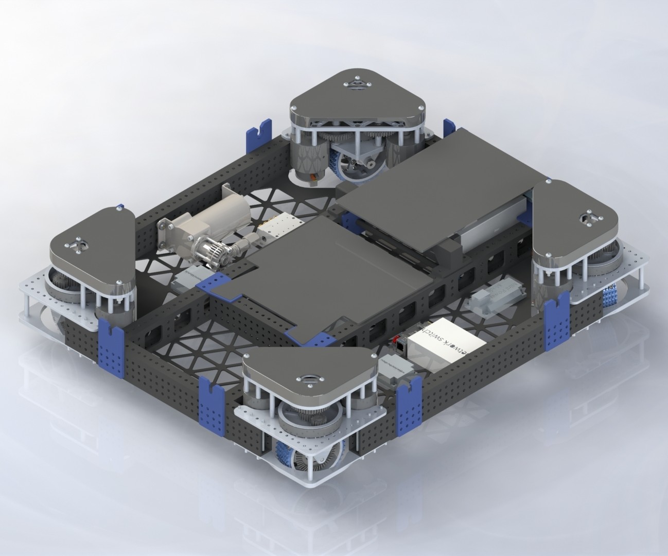

Team 4499 The Highlanders presents our 2023 robot: Iceman.

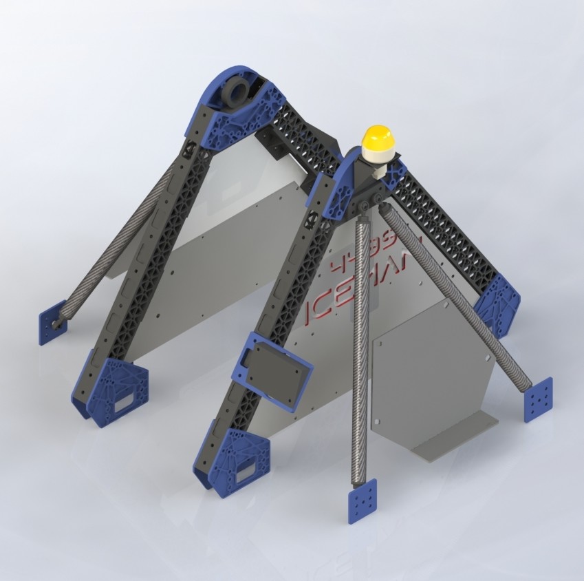

How did you decide the CF stiffening members were necessary?
We wanted tie rods → We had CF on hand in a pretty convenient size → Yes
This was the thought process. Not that the CF was necessary and totally wasn’t for testing something else.

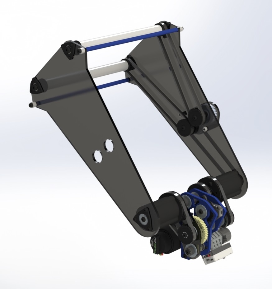

that intake is super pretty! would y’all be willing to share how much compression you’re using? ty!
I’m not sure how important compression actually is. When we tested through the compression range we were looking for, it seemed that the angle was more important than the compression (within reason).
We did 4.75 between rollers to discourage the cube from sending itself through the intake not because we needed compression.
I’d challenge you to look at Spectrum’s (3847 or anyone similar) intake and really understand how it works.

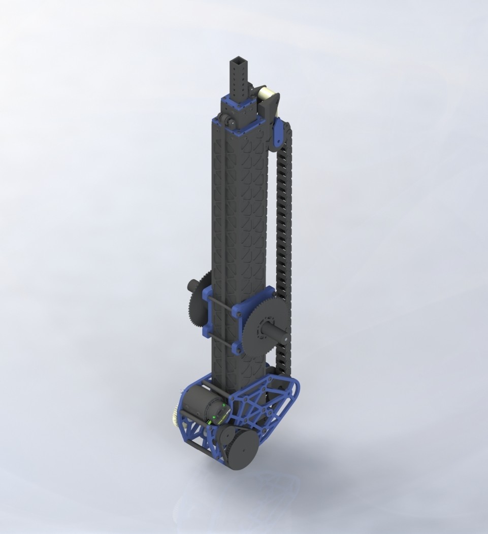

Beautiful robot. Loved watching the matches at Colorado and the autonomous is chefs kiss. Is that a belt I see being used for the extension and retraction of the telescoping arm or what are you using for that?
Thanks!
Kinda hard to see. but it’s there.
There’s also another one clamped onto the 1x1 which is inside the 3x3 straddling the 2x2.
I would love to check out the robot more and specifically the energy chain attachments to the sections at Houston! See you and your team there!

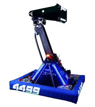

Do you know this pesky thing called the center of mass?
youtube-video-gif
Truly embodying the phrases
“Drive it like you stole it.”
“If you’re in control, you’re not going fast enough.”
“Never drive faster than your guardian angel can fly.”
And lastly
“If the bot ain’t tippin’, you ain’t whippin’.”
