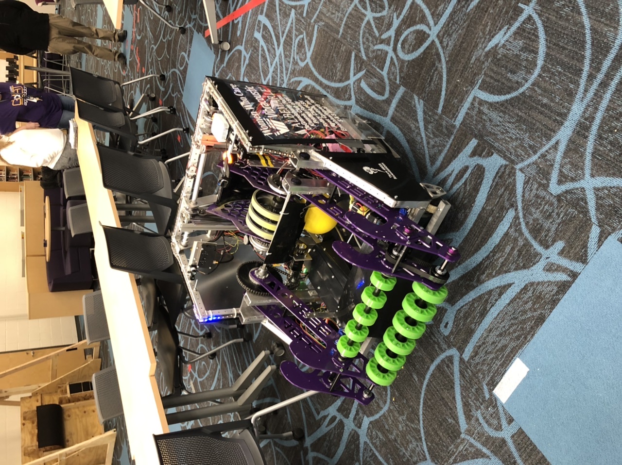

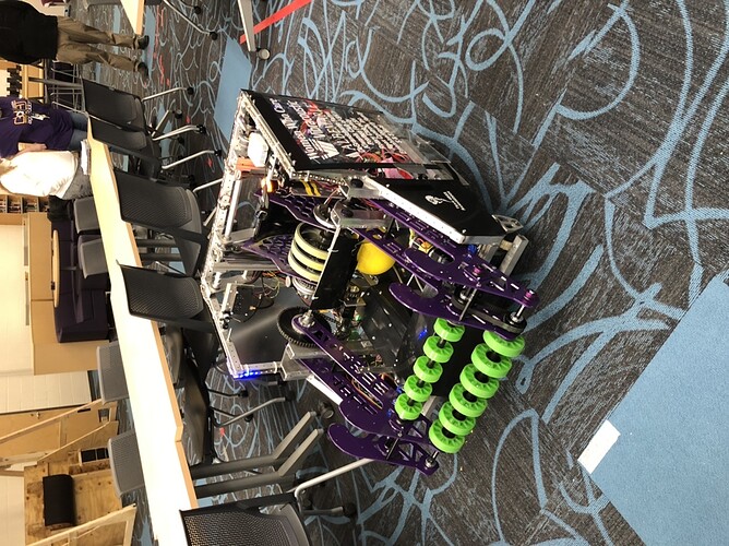

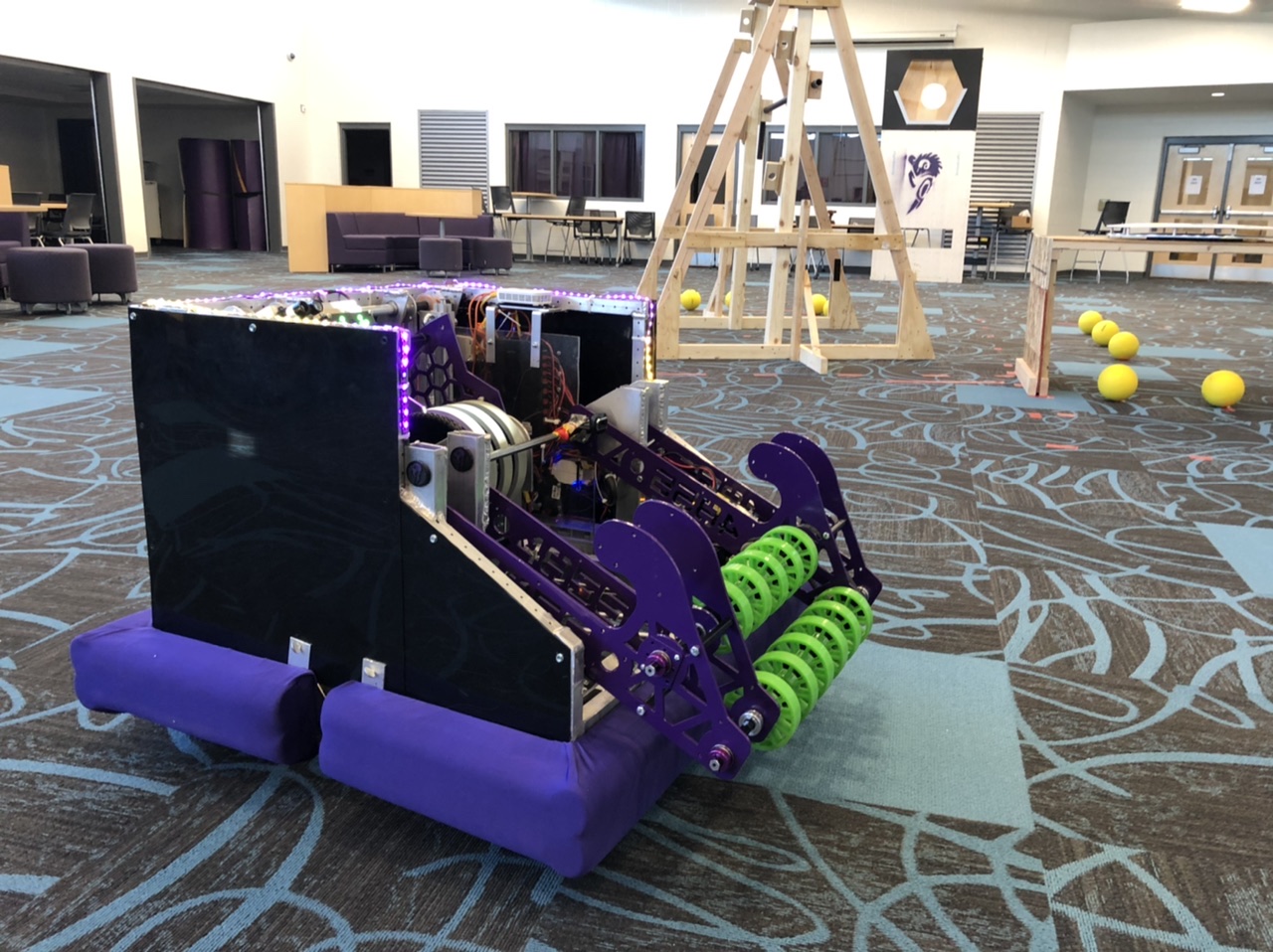

Very excited to be competing at FIM St. Joseph and FIM Gull Lake with our 2020 robot!
Sadly we don’t have a reveal video so you’ll just have to watch us at the competitions. Feel free to ask any questions! As always, good luck teams!

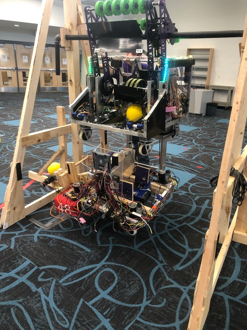

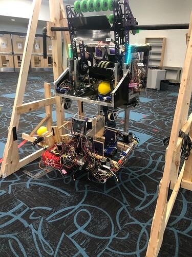

please try and look past the mess of wires on that bot we lifted in the second image
For a minute there I thought your electronics dropped out of the bottom of the robot while you were climbing. That would be an…interesting strategy. Seriously though, looks like a cool robot.
So do you guys use the legs you are using to lift someone else off the ground to also lift yourself up to grab the bar? If so can you explain how you are able to do this consistently and are sure you are lined up correctly before you start climbing?

Precisely. We have a web cam pointed straight up into the air at the bar and some computer aids to line us up to exactly where we need to be to ascend. We’ll also be running a program during competition that will use our gyro to turn the robot to the angle of the bar relative to the field, ensuring that we don’t come at it crooked.
I love the integration of everything - hooks with intake, buddy climb tucked away, and a simple ball path that should be easy to diagnose.
