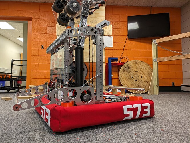

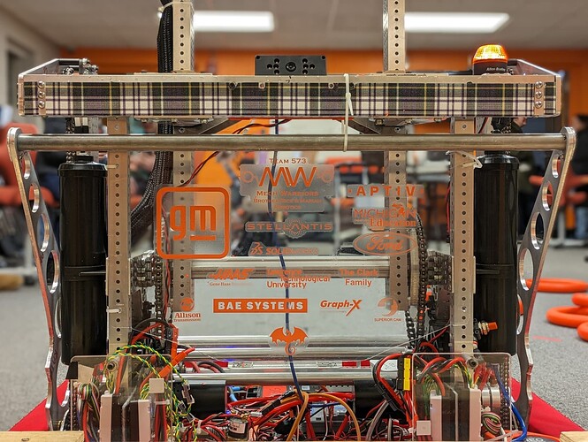

We are so excited to reveal our 2024 robot: Pegasus!
Pegasus was designed and built to play the 2024 FRC game Crescendo and will compete at the Berrien Springs District Event (March 2-3) and Troy 1 District Event (March 23-24)! We hope to see you there!
General Robot Specs:
  • Max dimensions: 29"x29"x47 3/4"
  • Overall weight: 123 lbs
Drivetrain:
  • Four wheel swerve drive utilizing MAXSwerve modules
  • Capable of a max speed of 16fps
Shoulder and Arm:
  • Powered by two NEO motors that drive the arm at 120 degrees per second
  • Arm supported by large diameter MAXSpline shaft
  • Gearbox mounts are slotted and chain tension is maintained via a cam system

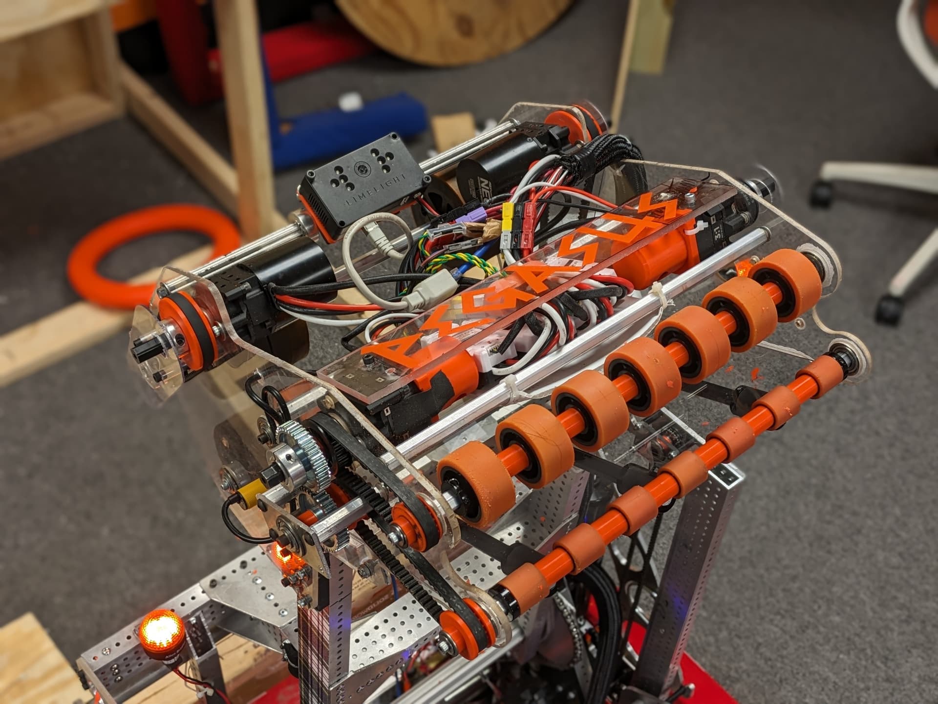

End Effector:
  • Integrated double roller intake, feed roller, and double flywheel assembly
  • Capable of acquiring game pieces from the floor and human player load station
  • Scores in speaker (high goal), amp (low goal), and trap (climbing goal)
  • Each set of flywheels is powered by a NEO motor, the intake rollers are powered by a NEO 550 motor and the feed roller is powered by a NEO 550 motor

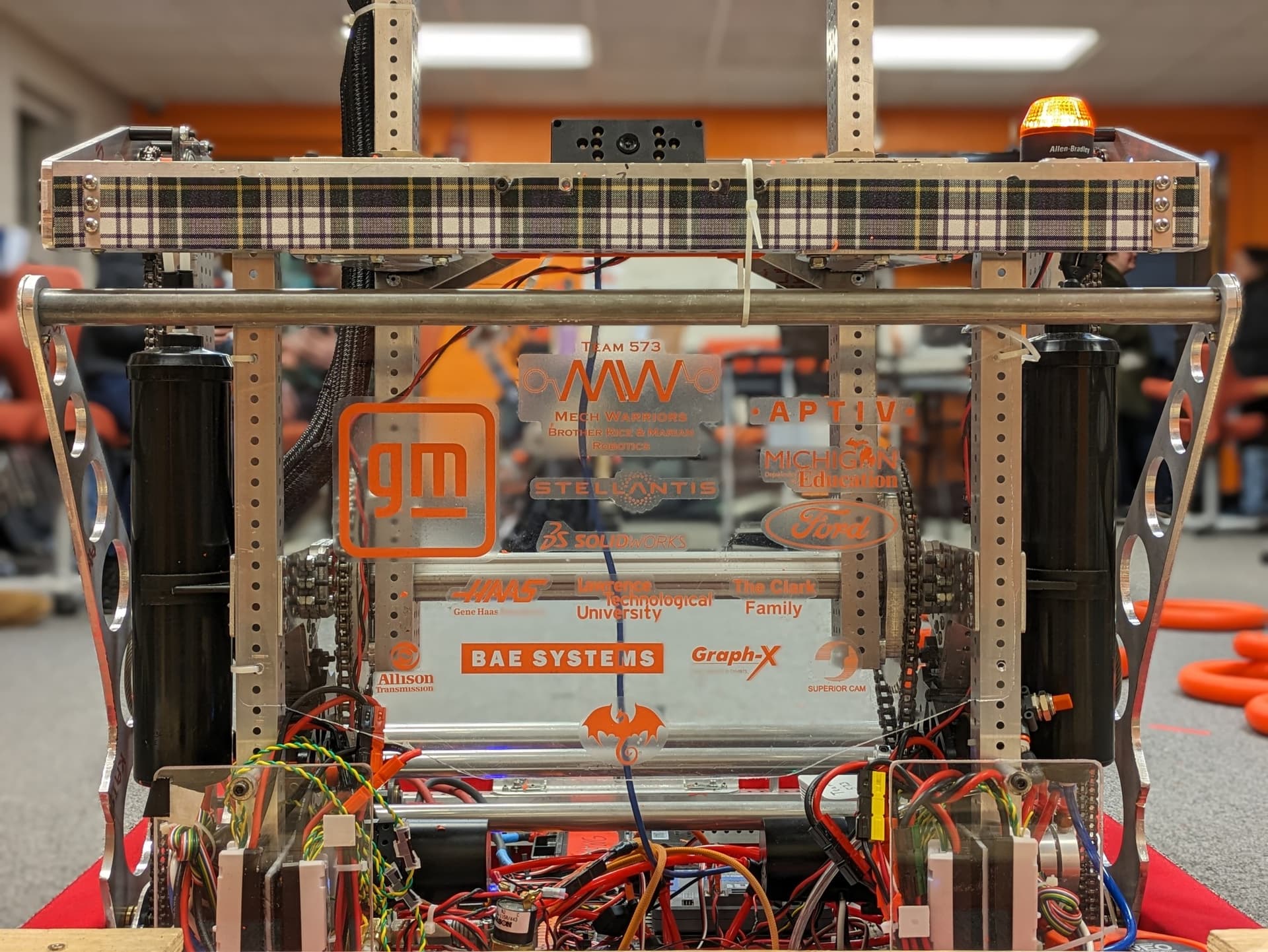

Climbing System:
  • Comprised of elevator masts and powertrain, hook assembly, buddy bar, reaction bar, and lock mechanism
  • Powertrain is powered by a pair of mechanically connected NEO 550 motors, each with a 30:1 reduction - capable of climbing at 19 in/s and has a stall load of 640lbs
  • Buddy bar provides a friendly climbing surface at chain height for alliance partners to earn extra points
  • Reaction bar stabilizes robot against stage core
  • Robot maintains elevation by a pneumatically actuated ratchet and pawl lock to prevent backdriving
Controls:
  • Limelight cameras track field mounted AprilTags for scoring alignment and floor pickup of game pieces
  • Robot utilizes a gyro and a suite of encoders to execute pre-planned paths during autonomous and odometry and pose throughout a match
  • Arm and flywheels are controlled by full PID loops
  • Drivers’ station contains a suite of prognostics and diagnostics to identify and address sensor failure, voltage regulation, and the like.
Lastly, we want to give a shoutout to FRC 3005 - The Robochargers for inspiring a significant amount of this robot’s design, from the swerve modules themselves to the bumper mounts!

  • Lexan and cleaning solvents don’t mix. Our initial end effector side plates were cut out of reclaimed table dividers from COVID. Who knows how many times they were wiped down with disinfectant, but it only took one hard hit to propagate a series of cracks through both plates made out of the now brittle material, and after three matches, it was time to switch to the spare. Unfortunately the spare also cracked after the gyro reset and caused another hard impact. Luckily, the spare stayed together after some splints were added, but there was still enough play local to where the feed roller motor mounted, which caused belt slip and difficulty expelling notes.

  • End effector iteration. Through some recent testing, the team is adjusting the lexan floor to be better supported and better align with the flywheels, resulting in both improved intake and a more accurate shot. The feed roller was also removed and the flywheel motors were repackaged to the arm. The resultant open volume will soon be used for a more robust camera mount and a trap assist device.
