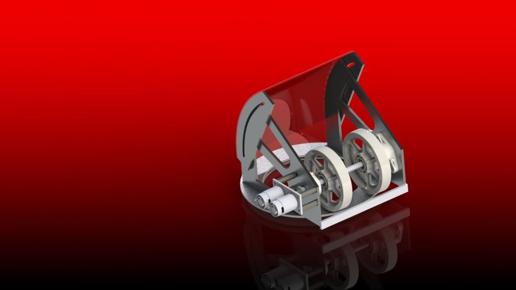

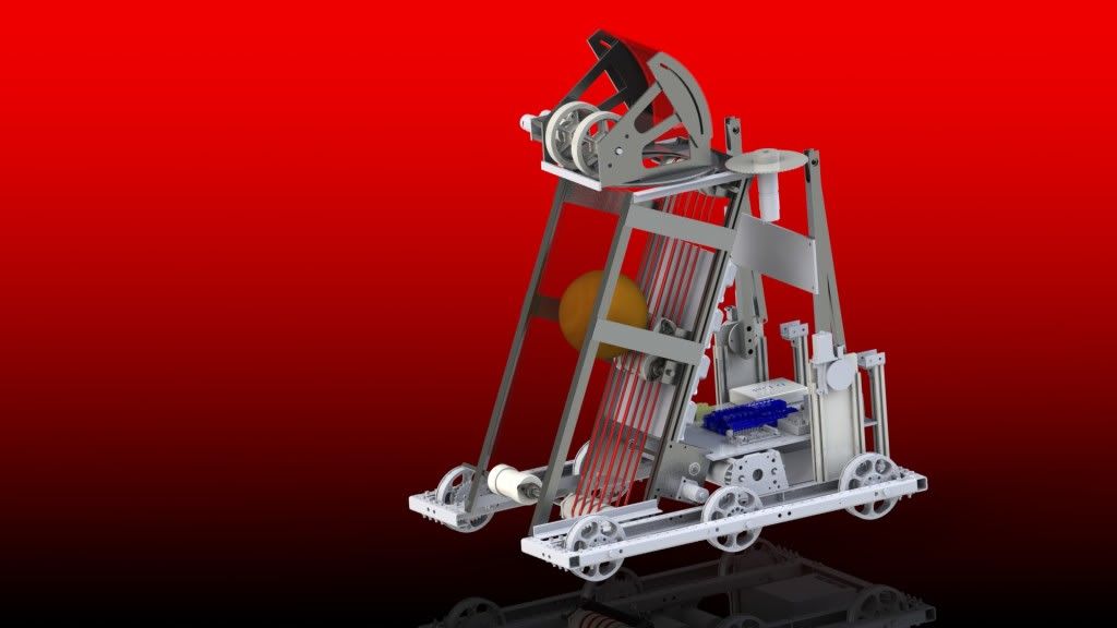

Here is some CAD renders. This is our first year doing CAD and it really helped out.
Look forward to competing with you :D. Well done!
You too good luck. Maybe we will play together like in 2010 :slight_smile:
