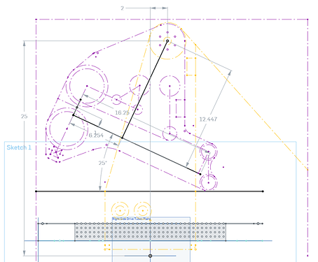

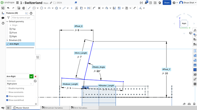

I assume you guys set up a master sketch that looked something like this:
I was wondering if you could find out the major dimensions. Def not planning on making a bucks clone…

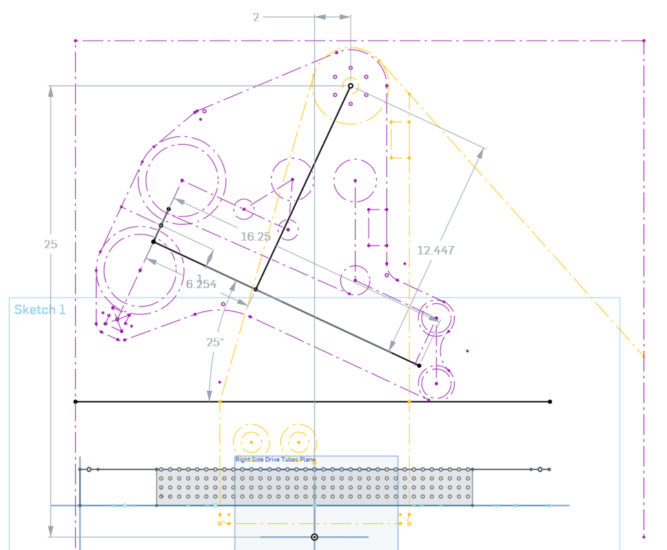

Yep, this is pretty much exactly how it started. We did all of our measurements to the origin and not the bottom of the drive tubes:
As the sketch progressed we used other features of the arm system to drive the geometry, hence why the Arm Length is a nice 12.447".
I would recommend also going lower than our lowest “home” angle of 25 degrees. We didn’t think we’d shoot from anywhere beyond the farthest legs of the stage, but the 25 degree angle ended up being our limiting factor in shot distance.
