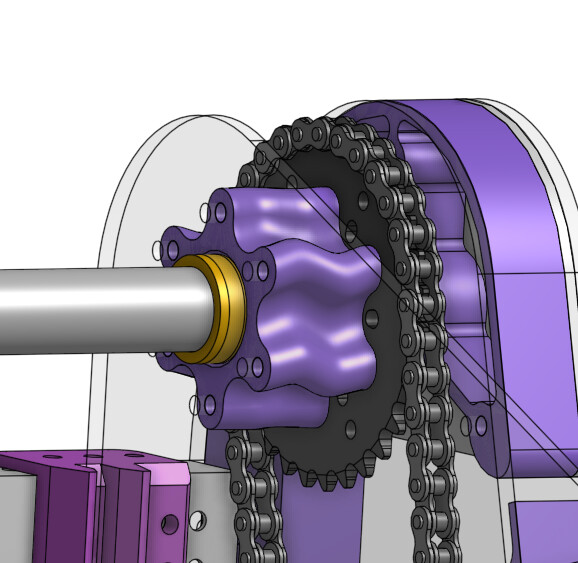

Most 3d printed components on this robot seem very “form follows function”, so I just have to ask - what’s up with this sprocket spacer?

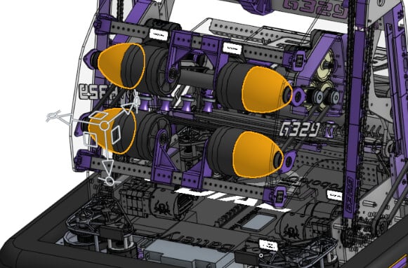

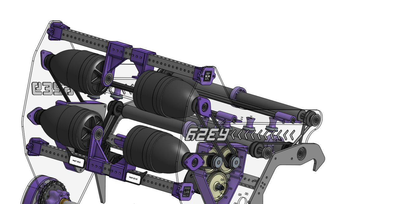

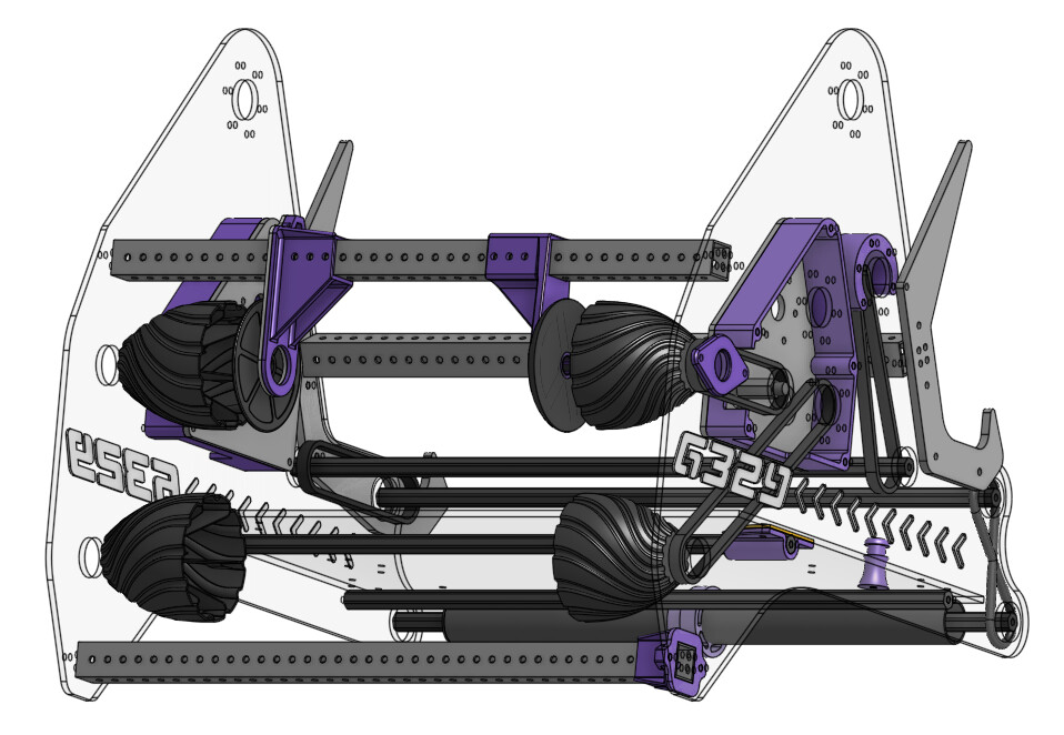

interestingly, I’m noticing the opposite. At nedcmp, I noticed they had some really aesthetic “spirally” parts near their shooter wheels but it looks like they aren’t in the CAD
(source: crappy yt screenshot)
The best answer I heard from a student was “it fits our swiggly bolts better”.
In 2023 we used some 3D printed parts with weird lofted geometry and it generated a lot of questions, so we tried to find fun places to sneak it into the design this year. Purely an aesthetic thing but it’s fun to learn about more complex modeling techniques.
Beat me to pointing this out. Those shooter spacers are also an aesthetic choice, but we suppressed them because they added ~15+ seconds to the part studio regeneration time. If you go into the 6329-24-A3000 Shooter document part studio, switch the configuration to Complex and they’ll eventually load in.
