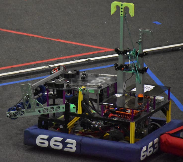

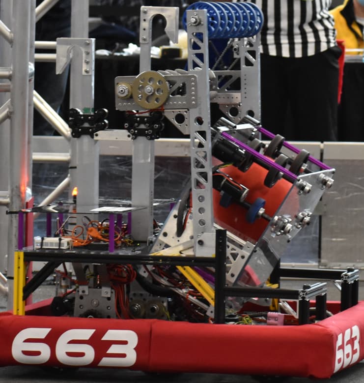

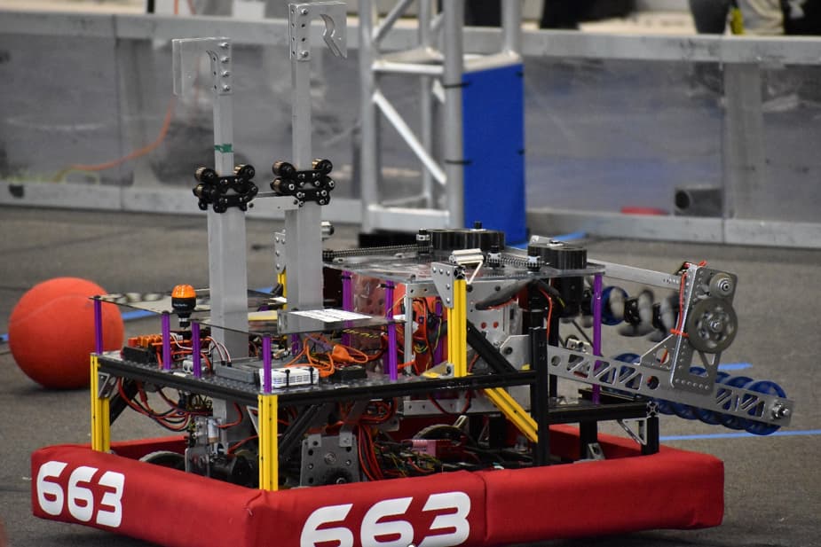

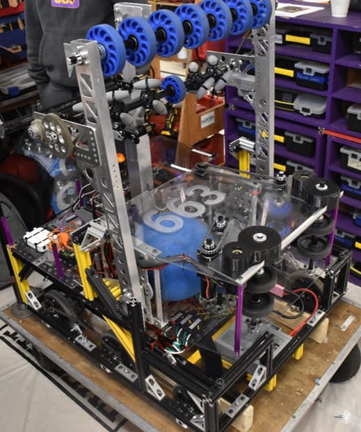

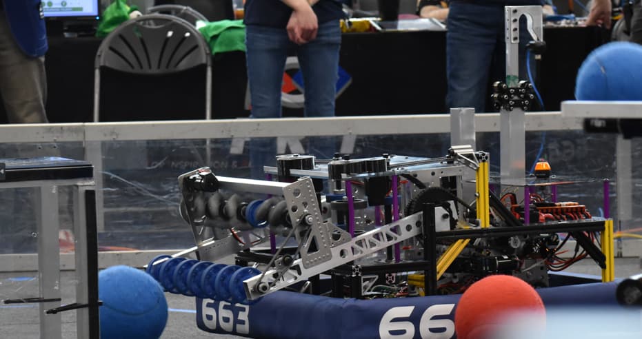

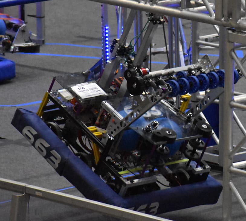

Hello,
It is my pleasure to present the Team 663’s 2022 Robot, Double Trouble!
Short List of features:
-Over the bumper intake
-2 ball capacity muzzle loading shooter/indexer, pivoted for a variable launch angle
  • Dual Telescoping climber (High Bar Max): Thriftybot kits using oilite busings instead of bearings to allow for higher side loads (albeit with more friction in general)
  • 6WD drivetrain
