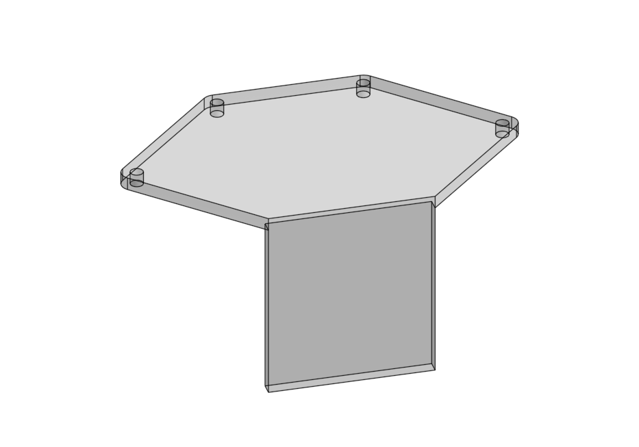

I saw some transparent parts (for example this swerve guard) that are somehow bended. Are these parts made out of polycarbonate or PLA/ABS etc.
bending polycarb isn’t difficult, all it takes is a heatgun and some patience
Just cold bend :sunglasses:
yes it is not difficult to bend polycarb but it becomes more fragile. Isnt that something we want to avoid?
Poly is pretty resilient even if it has been bent. These parts are meant to absorb collisions from the arm going astray (due to getting hit or a malfunction) so even if they broke they would have done their job to an extent. We had many hits to them from external robots and they never broke.
