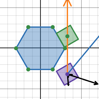

Our auto-align system utlizes a repulsion field for avoiding collisions with the reef. Other than that it’s just P control on odometry x, y, and θ. Everything was done from scratch.
We also made a desmos calculator as a proof-of-concept. You can drag the purple robot around and hit play in the top-left to animate its behavior. (Note: The real robot includes acceleration limits to mitigate the jerkiness you might see in Desmos when we switch from applying repulsion to not applying repulsion)
The repulsion field only kicks in if we detect a potential collision on a straight path to the target. Here’s a quick summary of how it works:
  • We calculate vectors from each reef vertex to the robot’s center, scaled by the inverse square of the distance
  • These are summed and combined with an attraction vector from the robot to the target.
The same auto align system is used for all our autons.

How did you guys like the repulsion field solution? We thought about implementing one but decided against it because it felt like the robot would drive too slowly when autonomous over a longer distance.
We actually ended up really liking the repulsion field. When properly tuned, it was more than fast enough for our needs. That said, we typically don’t use auto-align from very far away from the reef. The main purpose of the repulsion is to prevent the robot from driving straight into the reef if the driver triggers auto-align from a bad angle.
