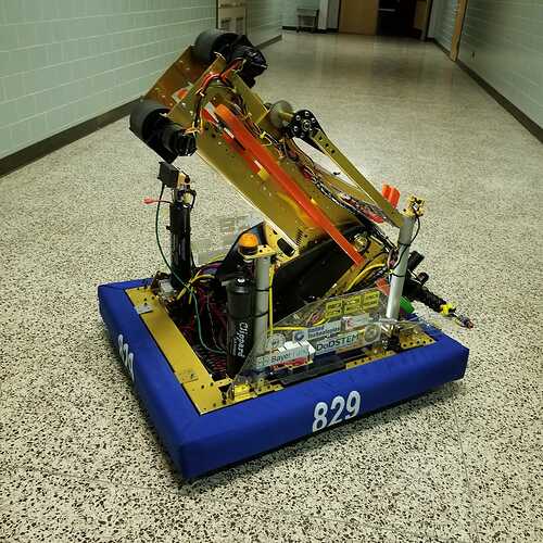

Say hello to our 19th FRC robot C-3P-Goat.
4 Neo 6 wheel custom drive, 4AM 6" Performance wheels (gold of course) and 2 AM Omni’s
Two flywheel shooter powered by Falcon500’s and 4" AM stealth and 4" WCP solid rubber wheels. Shoots anywhere from the wall to behind the control panel (with good PC’s)
Limelite aimed.
Pneumatic climb.
CP spinner (in theory)

Are your flywheels spinning at the same speed or is one going slower to give it a spin?
Top is faster yes.
Looks good! The ability to control your spin is awesome. For the climb, do the pneumatic cylinders lift the whole bot, then the hook grabs the bar and then the cylinders retract?

Yes that’s how we climb. It was a non-technical mentors idea and we ran with it. We have plans to convert to a winch if we don’t like how it works in competition. We can sit there and it they will retract automatically when disabled at the end of the match if we haven’t already.

Maybe I’m thinking about this wrong, but wouldn’t spinning the top roller faster give the ball front-spin not backspin? So the magnus effect would be hurting rather than helping, and the ball would jump up (and maybe out) when it hits the goal, rather than down
