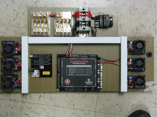

Nice. Very organized, I like how you hide all the wires.

That second Maxi block needs to be directly connected to the Rockwell PDB. (See the sixth bullet on <R50>)
Apart from that, it looks great.
very nice organization…wish we could afford garolite.
OOps, thanks for that catch. I’ll be sure to change that tomorrow.

The ATC fuse panel should also be directly connected to the PDB. In this photo, it looks like it is connected to one of the two Maxi blocks. Furthermore, are you using red wire for that? It’s hard to tell, but it looks black in the picture.
Besides these little nit-picks, very nice board. It looks really neat, no rat’s nest of cables.
Wow I totally missed that. I didn’t even realize I made that mistake. That’s also something I am going to have to fix tomorrow. I connect the black wire where the red should have gone and forgot to put the other wire on altogether. The ATC is connected to the PDB, I just connected it wrong. Thanks for catching all of my stupid mistakes

I didn’t notice this before, but what gauge wire are you using from the PDB to the ATC panel? I believe it’s supposed to be #6 per R50, and that looks like #10 or #12.
I don’t remember I’ll have to check. I have to redo the ATC anyway. Thanks for the catch.
im wondering what the inspectors are going to think of that… will they make you take off those channels and reveal the possible rats nest underneath?
