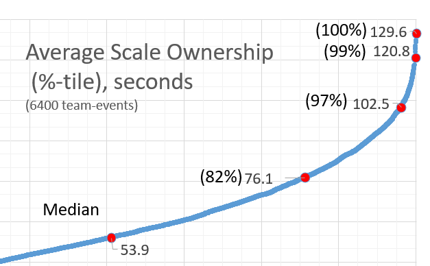

  • The distribution of scale possession looks pretty amazing (that’s 254 at Arizona North way up there at the top):
    https://i.imgur.com/15ebwAn.png
Nice graph!

My, how normal.
Hey I hate to ask, but do you by any chance have the equation of that graph? I’m trying to make a .js application that will allow my team and others to determine some quick facts about how a good a robot will be with them fast, ad that would allow us to add percentile to that list. Cheers!
It looks like a sigmoid graph oriented vertically. I don’t know the exact numbers but the rough estimate would be something like: Percentile = 100 / (1 + e^(-possession / 10 + 5.5)). The graph shown has possession on the Y axis and rather than percentile uses “total rank” (I suppose) where the maximum is approximately 6400.
Thank you. That seems to be close to it, and the calculator I am making would be for rough estimates only, so that helps a ton.
