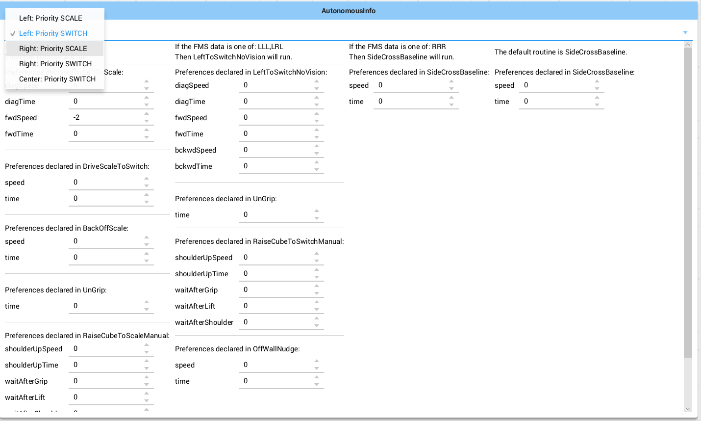

  • An improved autonomous chooser together with a shuffleboard plugin that supports selection of an “autonomous strategy”. This defines a mapping of game specific data to routines. Each routine can use annotations to easily change hard-coded values to preferences, and these preferences show up in a shuffleboard plugin. HYPERLib supports commands which are “subroutines”, and the preferences for a subroutine show up whenever a command which uses it is selected. Autonomous example.
