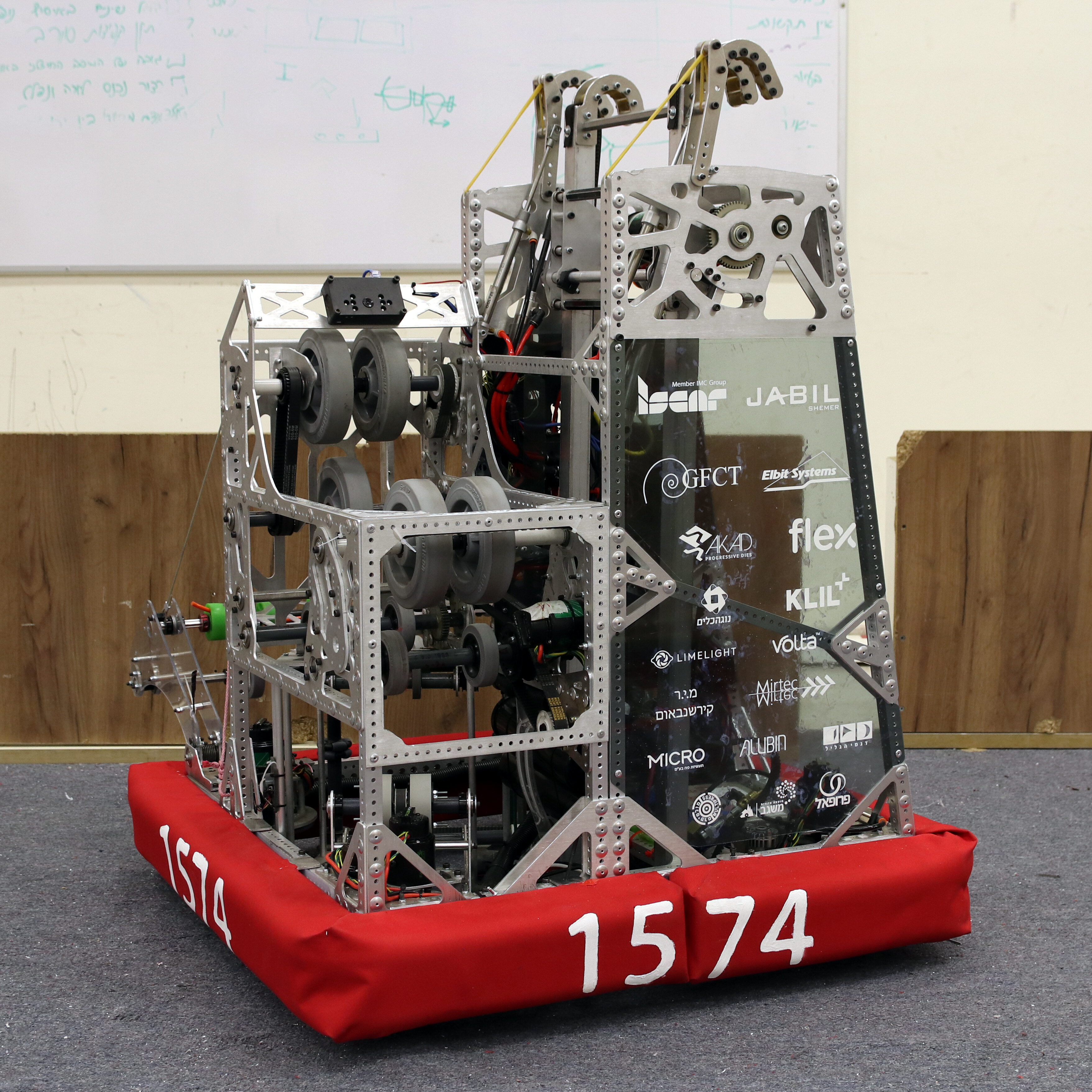

Team MisCar 1574 is proud to present our 18th robot!
Highlights:
Custom designed swerve drive
  • Absolute encoder on the rotation shaft allowing for compactness, reduced weight, and simplicity
  • Modular chassis connection
  • Artificial Intelligence assisted weight releases for maximum durability

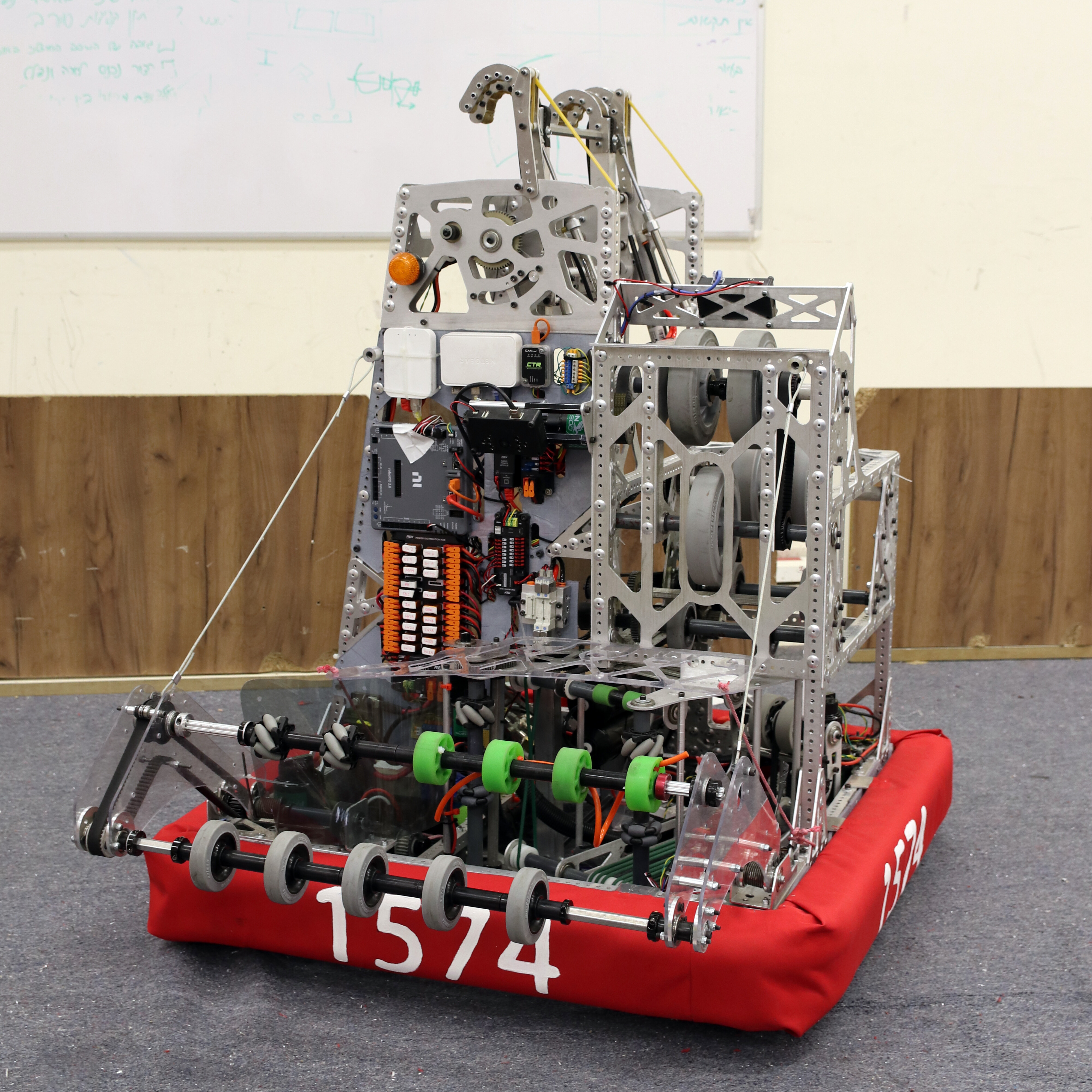

Shooter
  • Front and back pairs of 6” Colson Performa wheels
  • Designed for simple control
  • Four 3” Colson Performa intake wheels for alignment and acceleration of the CARGO
  • Modular configurations for CARGO pressure
Climb
  • A pair of moving actuators using timing belts to reduce weight
  • A pair of permanent hooks for a stable and fast climb
  • Carefully designed to fit under the TRUSS to fit more robots
Conveyor
  • Mecanum wheels along the vertical axis to lower the balls from the intake
  • A color sensor to stop and filter the balls
  • Designed with a spline method for compactness and an optimal path for the CARGO
Intake
  • Flexible polycarbonate sides for easy replacement and durability
  • Connected using ropes for automatic retraction upon impact
Software
  • A modular drag and drop dashboard for the drivers
  • Failsafe for absolute encoders and Limelights disconnecting
  • Intake CARGO detection and autonomous intake using Limelight Python pipelines
  • Autonomous climbing routine
