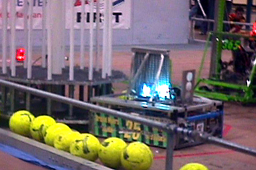

The Silver Scorpion last year was decorated with 8 1/2 x 11 full sheet Avery labels printed in my Inkjet printer.
The numbering, label art and design are set up on a ppt slide and then we print the whole slide as a label.
As some will recall, the SS grabbed two goals last season and more or less pulled them in along the sides of the machine. As a result the labels took a beating. So we printed off dozens of them in different colors and styles and replaced the artwork as needed.
BTW- we had a changing color scheme for the Scorpion.
In the seeding rounds we had orange lettering on a silver brushed metal background. In the later rounds we moved to orange on brushed copper or bronze. In the elimination rounds the colros went to blue lettering on gold.
At Brunswick Eruption, after making a formal agreement with John Larock of the the MOE team. we decorated the SS with stickers with the trademark Moe-stick green and black striping. BTW- it was the SS moestick colors that eventually won the event by beating the Moehawk in the finals.
