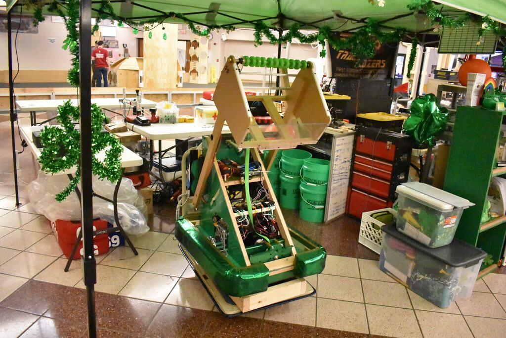

Also, you can totally use a wood-shop to build an FRC robot. See 6956, Sham-Rock-Botics. I believe they have been based out of wood-shop for several years and build fun robots every year.

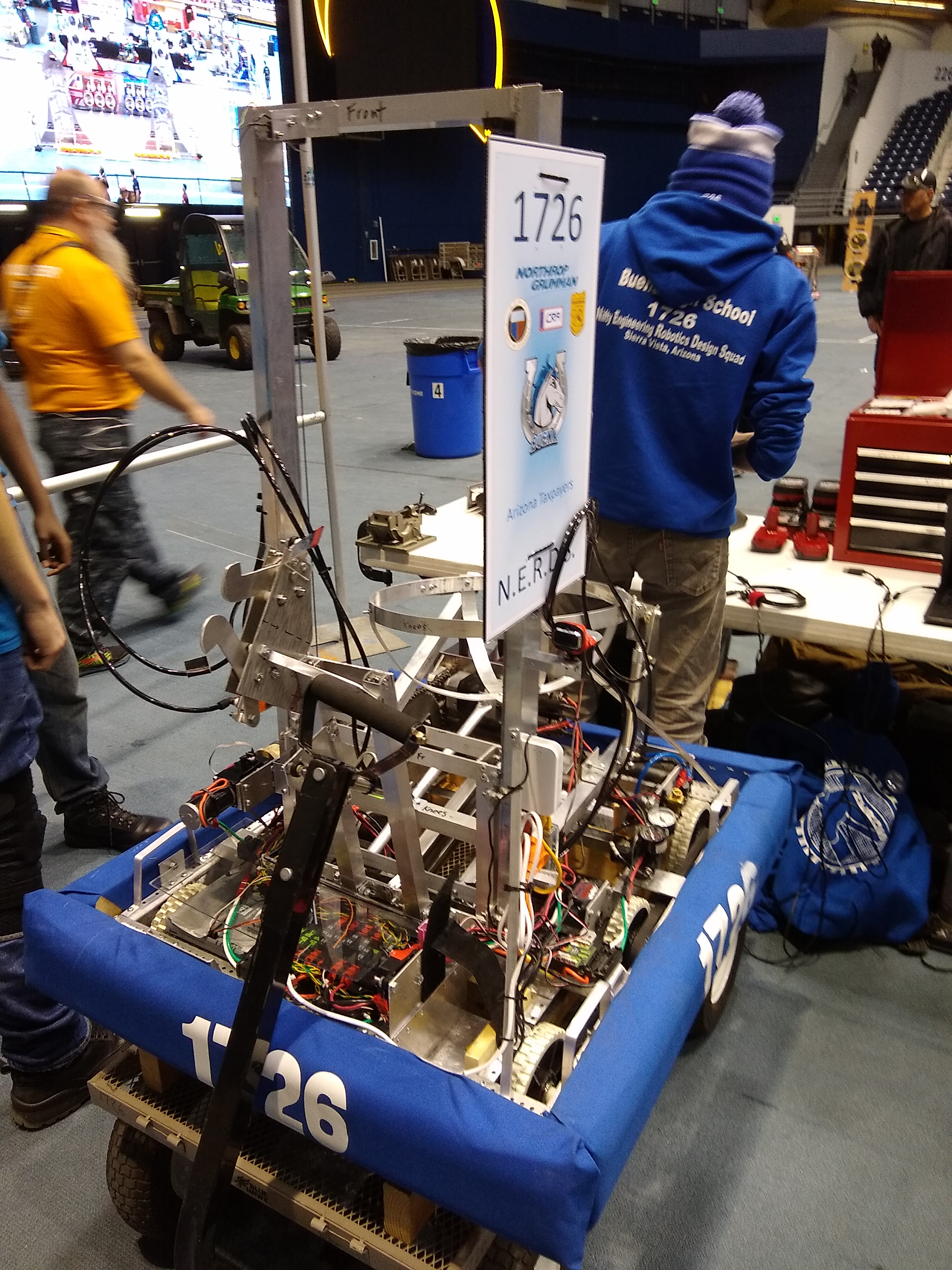

  1. Miter saw with aluminum cutting blade. Very helpful. We have accuracy competitions for our fab kids and it can get the job done. The one we have on hand has a laser sight on it.
  2. Versaframe. Never went with it before, but having lost much of our high end machine access it helps a lot.

“…and then we thought, does it really make sense to build a metal robot in a wood shop? So we built a wooden on instead.” -6956 Sham-rock-botics

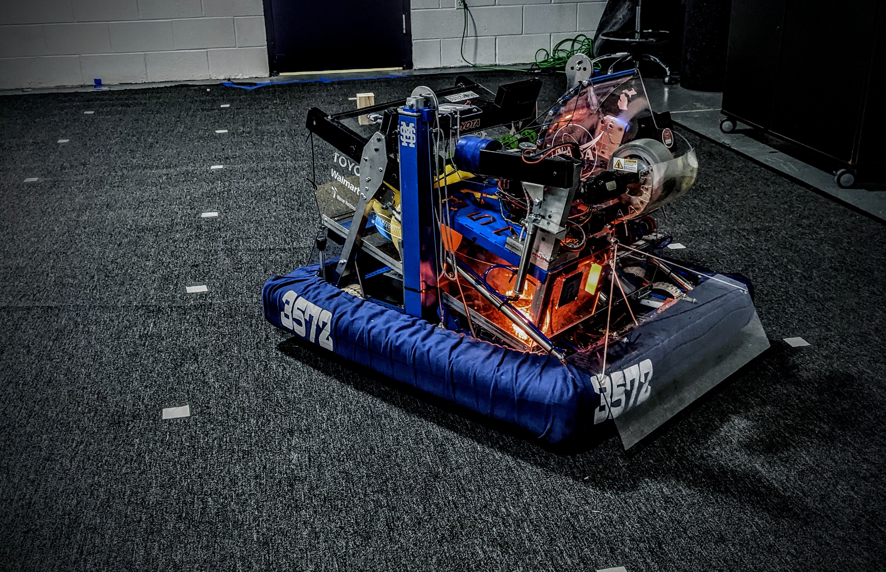

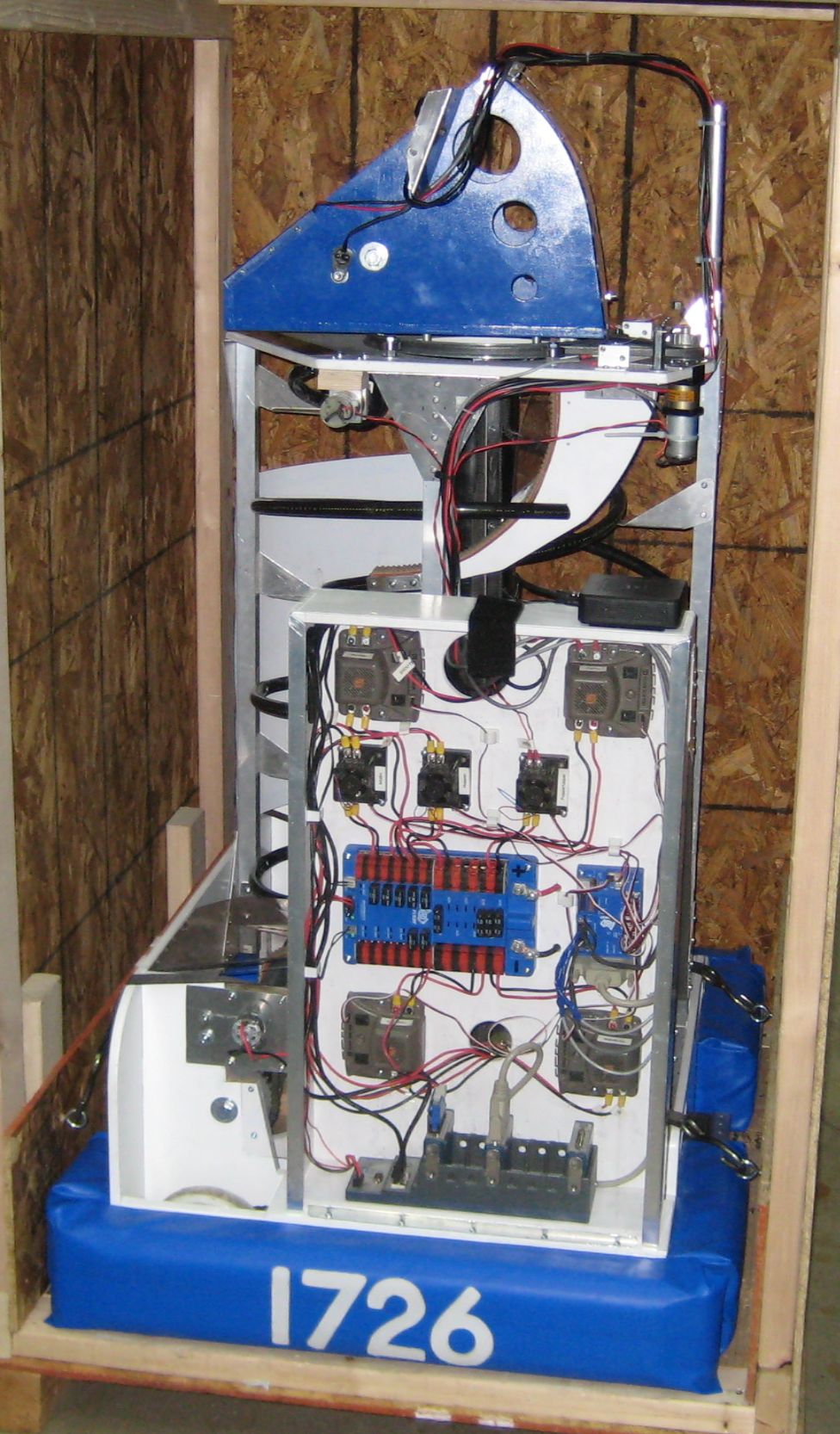

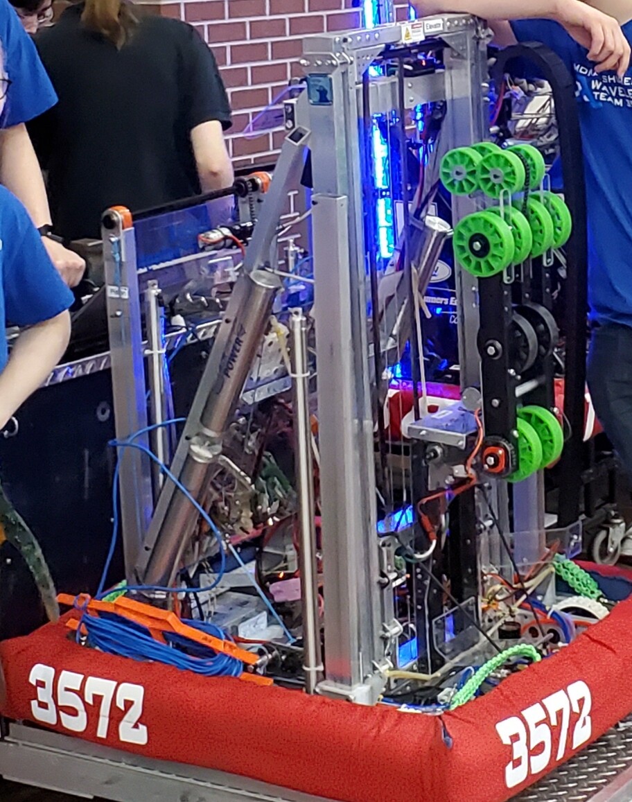

This one was made with a little drill press, a little band saw, some hand tools, and a couple parts were turned on a small lathe, because we had one. Ok, we also did a little bit of welding. It earned the #2 qualifying spot at Denver playing the Cargo game.
It takes a sort of different way of thinking about design and building. We try to take advantage of different shapes and materials available, looking at them from the perspective of “what can we use that will require minimal machining to turn into the part we need?”
Also, you can have fun with wood…depending on the game, of course. Our best performing robot had a lot of wood, the chassis was plywood, so was the shooter housing. This one was designed in CAD and cut out with stuff at the sort of well equipped wood shop we had access to at the time.
The finish is a couple coats of spray can paint, sanded between coats.
One reason this one turned out well was that we figured out the design early, and had a working prototype robot at the end of week 3, and it only took a week to make another one with the desired changes and a nice finish. Yes, it won a blue banner.
