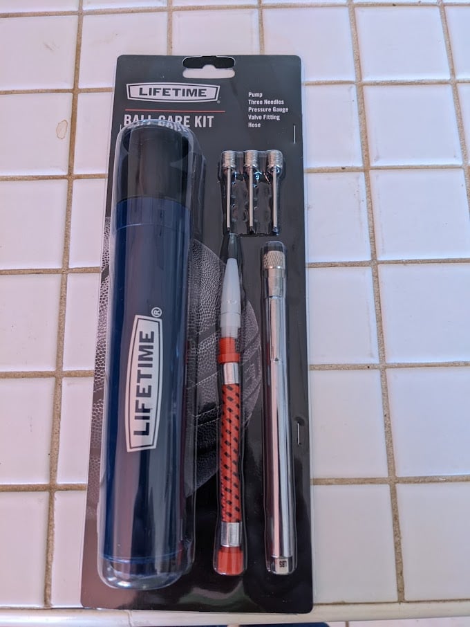

The Lifetime gauge I bought at Big 5 seems to work ok.

We have two of the champion gauges and both seem to be odd. We have a similar experience where the only way to get a good reading is to over inflate and then use the gauge to release air, if we put the gauge in a ball we believe is inflated correctly it will not register a reading and we have to over inflate and release air again. Similarly to above our digital gauges seem to read about 1 psi higher than this analog gauge (analog reads 3.5psi is a digital 4.5psi).

Our Amazon digital pump consistently reads 1psi higher than the Champion gauge on the same ball.
My current inflation technique that seems at least repeatable with the Champion gauge is to over inflate with the Amazon pump by 2-2.5psi (set it to 5.0psi). Then I rapidly tap the bleed valve on the Champion gauge to puff out small exhausts until I hit 3.5 on the money. The jostling of the needle and exercising of the valves I think helps get the gauge unstuck.
Fwiw I do think that is how the Champion gauge is intended to be used. Meaning it’s designed to take a slightly overinflated ball down to proper pressure and probably expected to be used that way.
