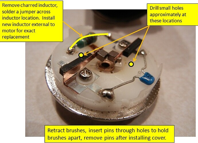

It is quite possible, likely even, that GDC had no idea how these motors would react to the devil-may-care “design” work done by our enthusiastic high-schoolers. Can you give us more details about the minifuses? I would put them into my test machinery regardless of competition legality, then remove them for competition.
As far as I can tell the biggest oversight was the failure to include motor leads at all in the first choice parts kit. They ran down the list of needed motor stuff to add to the resource kit but fell short of even the standard connection method. That connector is at least designed for the machine. No visible strain relief in it and no way to secure it to the motor either. I get the idea that it’s an afterthought from Tetrix.
thats funny, i can always seem to remember teams having wireless networks set up for scouting… if the rule has existed that long, has it really been this poorly enforced?
You can withhold the minibot and insert fuses in the feed lines from the motor at your liesure. It would take a few dollars for the parts, and about 10 minutes. Hopefully you’re prototyping using fuses. Certainly a lot less time and expense than taking a motor apart and replacing an inductor, or the complete motor assembly.:slight_smile: :slight_smile:
You can pick up minifuse holders and fuses at any car stereo shop or auto parts store. I would suggest you start out with 2 - 2.5 amp fuses, and have spares on hand. They originally had the less expensive motor leads listed, then added the thermal protection leads (at about 4x’s the price), which do not react fast enough to protect the motors. Remember, these components are used in robots that run across the floor. That is a whole lot different than using them to climb a 10 ft. vertical pole. In addition, these components are"new" to even experienced FTC teams for the same reason.
We found around 20ohms of resistant across the windings with a stock motor and 6 ohms with just a wire in place of the inductor. Pretty big difference.
Does anyone know if the inductor I listed earlier in this thread an identical part?

Although the Bourns page is similar it is not nearly the identical part. When I first started research on this a few weeks ago, I found an identical sized inductor with the same conformal package. I believe they were more like 900ma max DC current. The series resistance is much lower than the Bourns above. AT 900 ma used with a motor that stalls at 7.5 amps, you can see why the motors constantly burn open.
BTW, I started the discussion to allow opening Tetrix motors to replace the inductor. My recommendation was based on the purchase cost factor of replacing a motor that had failed simply because an under rated part had failed. I had hoped that teams could cut their losses by replacing the inductor. FIRST and the GDC was overly generous by allowing teams to open and repair other items besides the Tetrix motor and delineating “repairs” from the “modification” rules.
That’s a big help in telling whether a motor is repairable. My armature coils measured much less than 20 ohms. That is further support for my presumption that there is invisible damage to my coils internally.
I’m confused about your 6 ohm measure though. Why would shorting the inductor cause less than the coil winding resistance?
So, my advice now about trying to repair a motor is to measure your coils first, across all three pairs of commutator contacts. If you find a coil pair that is significantly less than 20 (or 6?) ohms, don’t bother trying to replace the inductor. Even if you were to get an operating motor going, its work and power characteristics will be different than a stock motor. That would make the repaired motor questionable to use for prototyping. It might still be useful as an arm mover on an FTC robot though.

Thats a good idea… I was wondering about the possible failure modes of the choke. If it fails open, the motor should be a brick which I suspect most people see that can revive the motor by replacing that. If the choke can have a partial failure mode and still allow current to flow then we should see a partial power motor… like all three of the ones we smoked. But if the choke can typically only fail open, then likely the windings are shorted and should be tested like you propose.
What confuses me is the motor R should be 12v/Imax = 12/7.5 = 8/5 ohm.
So I suspect that the shunt capacitor may be interacting with the ohm meters to corrupt the reading.

The stall current should occur when two windings are in contact with the brush at the same time. If you happen to measure when only one winding is contacted, you will see a higher reading. The failure mode on the inductor is open if stall occurs often or for an extended period, accompanied with a little smoke and possible debris. Partial short with smoke if running extended over several amps. The cap is so small that you likely can’t measure any resistance even if it was outside and not connected. The choke is so small that high heat causes the coating to crack and the in some cases the core cracks as well.

Based on everybody’s work here, and my own experience, I would suggest the following:
If you still have any good motors, protect them with the “fuse protected” cable (really a thermal switch) sold by Pitsco: http://shop.pitsco.com/store/detail.aspx?ID=6122. These should be acceptable for use in competition, but minimally use them during test to prevent motor damage. I have not tried them, but they automatically reset and presumably can protect the motor (will they trip under “normal” load conditions though)?

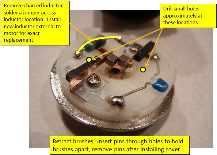

If you have motors that are already burned out, it is indeed possible to repair them. You can carefully open them up by un-crimping the small tabs on the back cover. The hardest part of this is re-assembly because the brushes spring closed and you can’t safely get them to go back over the commutator when trying to install the lid after repair. I found a good way to do this is to drill two small holes through the back plate 180 degrees apart next to the brushes (See attached diagram, thanks to Colin for the photo):
These holes allow you to insert small pins (safety pins for example) from the outside, holding the brushes in the open position while you re-install the cover plate. Once the cover is in position, then remove the pins and presto, the brushes are back in contact with the armature. I used a 0.036" PC board drill. You could use a more common 1/16" drill too.
You can replace the inductor with an equivalent (The best one I have seen was recommended by Patrick Freivald (Thanks Patrick)) –> Here:
http://www.mouser.com/Search/Product...lkey434-22-3R9
** Important ** – Since these inductors burn out so easily, I would recommend repairing the motor by removing the inductor and replacing it with a jumper wire. That is what is shown on the attached diagram. Then install the new inductor EXTERNAL to the motor. You can put it in-line with the wire and cover it with heat shrink tubing. That way when it fails again, you don’t have to open the motor to fix it. I cannot imagine any sane person disputing that this is an exactly equivalent repair. Deleting the inductor would not be legal (although perfectly functional for prototyping), but if it is replaced externally, that is exactly equivalent.
