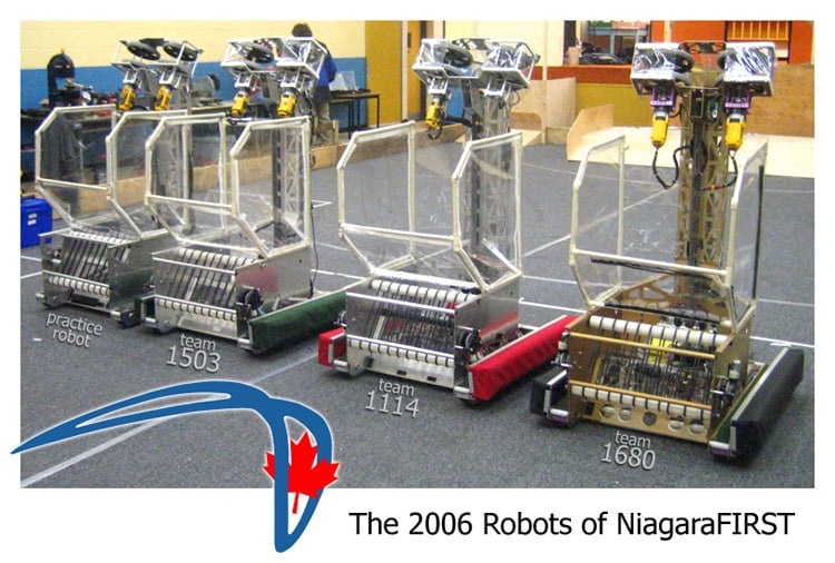

These robots are awesome. I’m sure there are more truly elegant design details beyond the winch cams.
When I was a student, the Niagara triplets blew my mind. Once again, I’m similarly inspired.

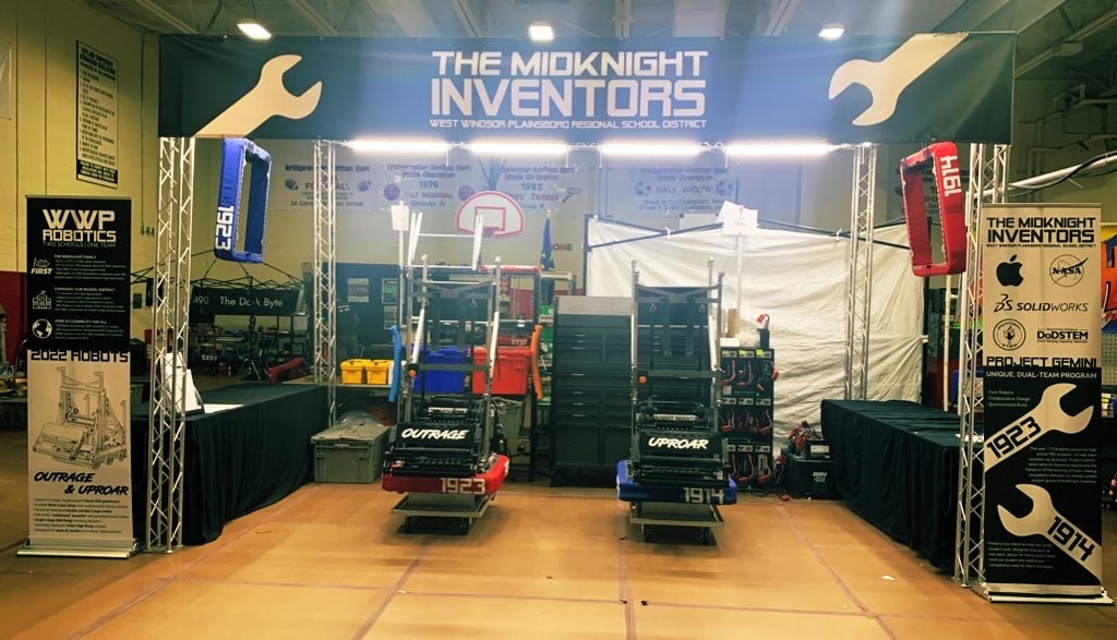

I need to be clear here; other than in the eyes of FIRST’s registration system, these are not separate teams. All of our students are on both rosters. At home, this is one team and program, following the same process we always have to bring them together to collaborate on this work. We absolutely never intend to split them up culturally; we are proud of the MidKnight family’s size and unity.
We have always been a large team building twins (and at least half a triplet) - this year we paid an extra $5k to put regulation bumpers on our twin and give more of our students drive team and pit crew experience.

For the pit awards - this was our first event trying it, and we sort of played it by ear. Judging groups came by for each team, and we did make sure that the students who spoke ‘for 14’ didn’t also speak ‘for 23’ - the event manager at one point did ask us if we could help be clear about that. In future events, we plan to give the pit crew members something to identify who they speak for - maybe pins, or some sort of other visual marker.
For context, because we share tools - again, we are one program and one group of students with one shop - we would obviously prefer to mush our pits together since we were next to each other on the pit map. FMA event coordinators reached out and asked us if we wanted to be neighbors, so we said yes. (We also cleared the double-truss situation with FMA ahead of time, and would not bring it to events where we have not verified it’s OK). I totally get where it might be confusing who you’re talking to, and we’re going to do better at that for our next event!
