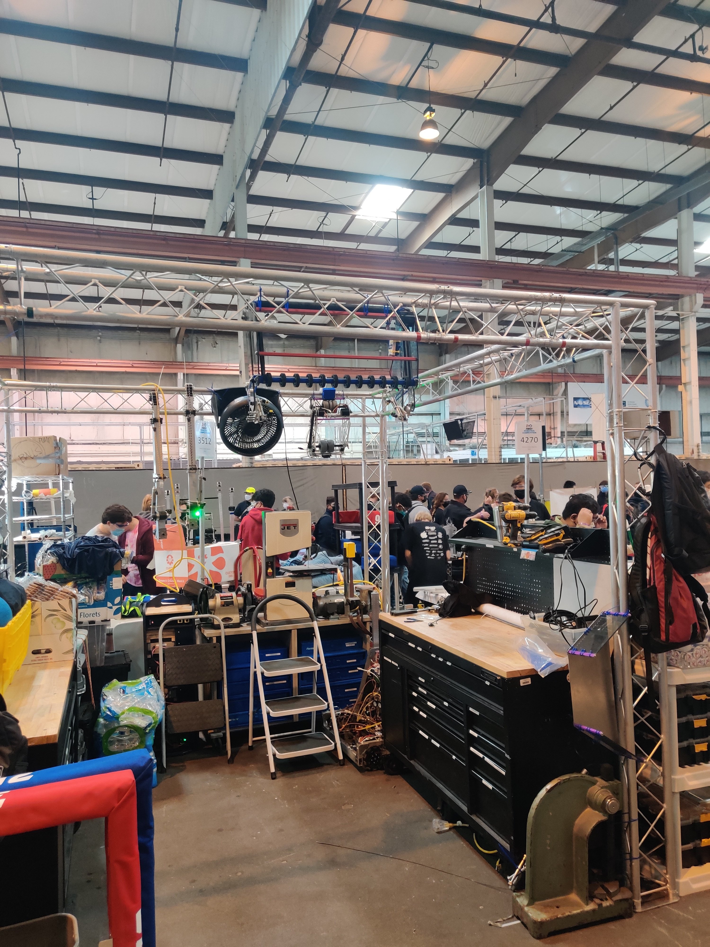

This is exactly what 3512 did this season. On packup night we’d unbolt the entire shooter, intake, and climber assemblies from the practice bot. We never even considered powering up the practice bot at comp, it was a part donor only.
This saved our bacon at Ventura when after winning our 2nd quarter final we snapped a dyneema line on one of the telescoping arms. The kids an entire telescoping arm swapped out, system checked in the pit, and did a successful L4 climb on the practice field in 15 mins.
We decorated the pit truss with the spare parts which was fun:
Whoa that spun out of control. I just wanted to make sure the same safety controls for voltage, wiring, pneumatics we’re enforced if around so many others.
I’m far more impressed that you lugged in that arbor press.
I think it helps press-fit wayward turrets :grin:
