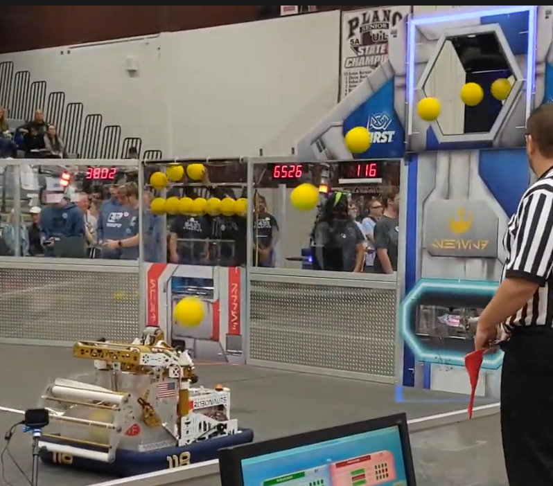

Hi, I noticed while watching videos of 118 competing that in several matches, they were storing and shooting up to 7 balls, yet they received no penalty points. I can understand that it is hard for refs to keep track of all the balls on the field, but I feel as if this is a problem that some teams might choose to exploit.

Can you count that fast without stopping it? There is a reason to make an opaque hopper.
This seems to be the match in question
Edit: ( https://youtu.be/zOZgpRfTXqk?t=36 ) Exact Time
Interesting… If I remember correctly, its a foul per Power Cell right?
It’s supposed to be 3 points per ball, but there are 0 penalties points for that match.
We also had an match where we stored 6 balls in our robot by mistake, and when we launched them all out, we didn’t get penalized. We don’t have a hopper anywhere near as fast as 118 anyways.
So does it seem to be ruled on what the intentions of the robot were? or the Refs just generally dont pay that much attention to how many balls you take compared to other things? Your thoughts?

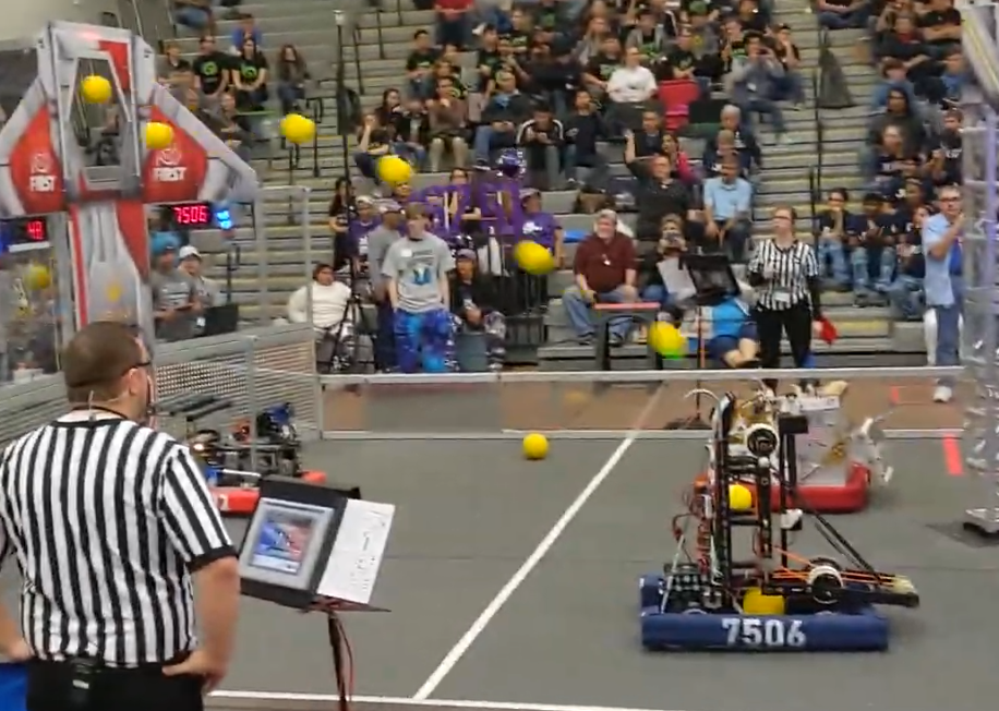

I hope nobody is intentionally holding and scoring six or more cells. I had a parent bring up they saw 1986 do it a couple times. Here is one of them: https://youtu.be/4YjYfKmSkew?t=83
But watching I just see a mistake (going with a good intake into a bundle of balls) and not some strategic plan to hold above the allowed amount. Still, they weren’t penalized for it, and you’d prefer it gets called so others aren’t tempted to do it as a way to cycle faster.
I just don’t think they noticed. For a team like robonauts, it’s almost impossible to count that many balls that quickly. The only way I could see the rule being inforced would be to have a ref on each robot counting how many balls the robot intakes before shooting. Other than that there is nothing stopping teams with incredibly fast indexing from getting 6-7 balls per cycle.

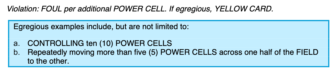

Exploitation of this as a strategy would very likely lead to a yellow card, per G6:
My 2 cents after watching that section of the video a bunch of times. Their hopper shields things enough that no one was likely able to look into it and count. And the ref was as they drove up looking somewhere else and then at the power port. Having already been to one event and seen just how fast balls are moving by the time the ref knew there might be an issue he likely had no way to confirm where exactly every ball came from. And with the other blue robot in a place where a ball could have come from and likely looked like a similar trajectory… too fast to call?
While this is true, it’s clear right now that the refs aren’t looking for this issue, or just cannot determine how many balls are being launched. Even if a team is caught once, it could be very difficult to hold them accountable each and every cycle. At what point does the ref give a yellow-card instead of just issuing the penalty?
