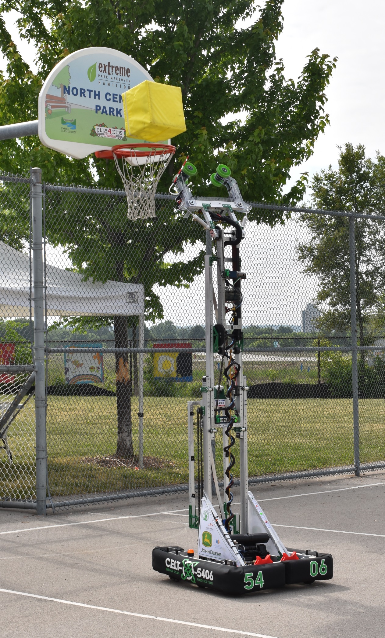

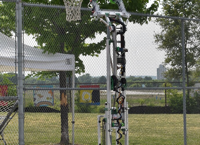

Was it ours? We built our own self-coiling cable harnesses by taking coiley air tube (needed for our gripper), and fixing the wire to it using braided sleeve. We also found that running a length of latex surgical tube in the middle of the coil kept it nice and centered in the mechanism, especially with the coil loaded by all that extra copper weight. All in all, it was a nicer and easier solution than an energy chain.

Our robot also had what I think you’re talking about.
All it was is a coiled pneumatic hose from McMaster that had all of our wires for our intake zip tied every 6 inches or so (the wires were wrapped along the coil). It was a dual air hose, with a single hose zip tied on the inside also. The part number for McMaster we used was 5612K43. A word of caution-- this “umbilical cord” is really heavy but it worked great for a 3 stage elevator.

Yes! It was a pneumatic coil like 6090 and 5406. Thanks, I wasn’t sure if it was a special wire that teams used of if it was a sleeve like that. Thank you!
That looks really simple too. Did you have any issues with weight?
No weight or other issues at all. It was a simple solution to a potentially vexing problem.
