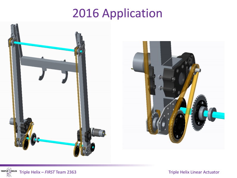

Triple Helix developed a compact linear actuator throughout the 2015 and 2016 seasons and successfully deployed the design in both of those games.
This video highlights usages of the mechanism in gameplay.
CAD of both Triple Helix robots can be downloaded from the links in this post.

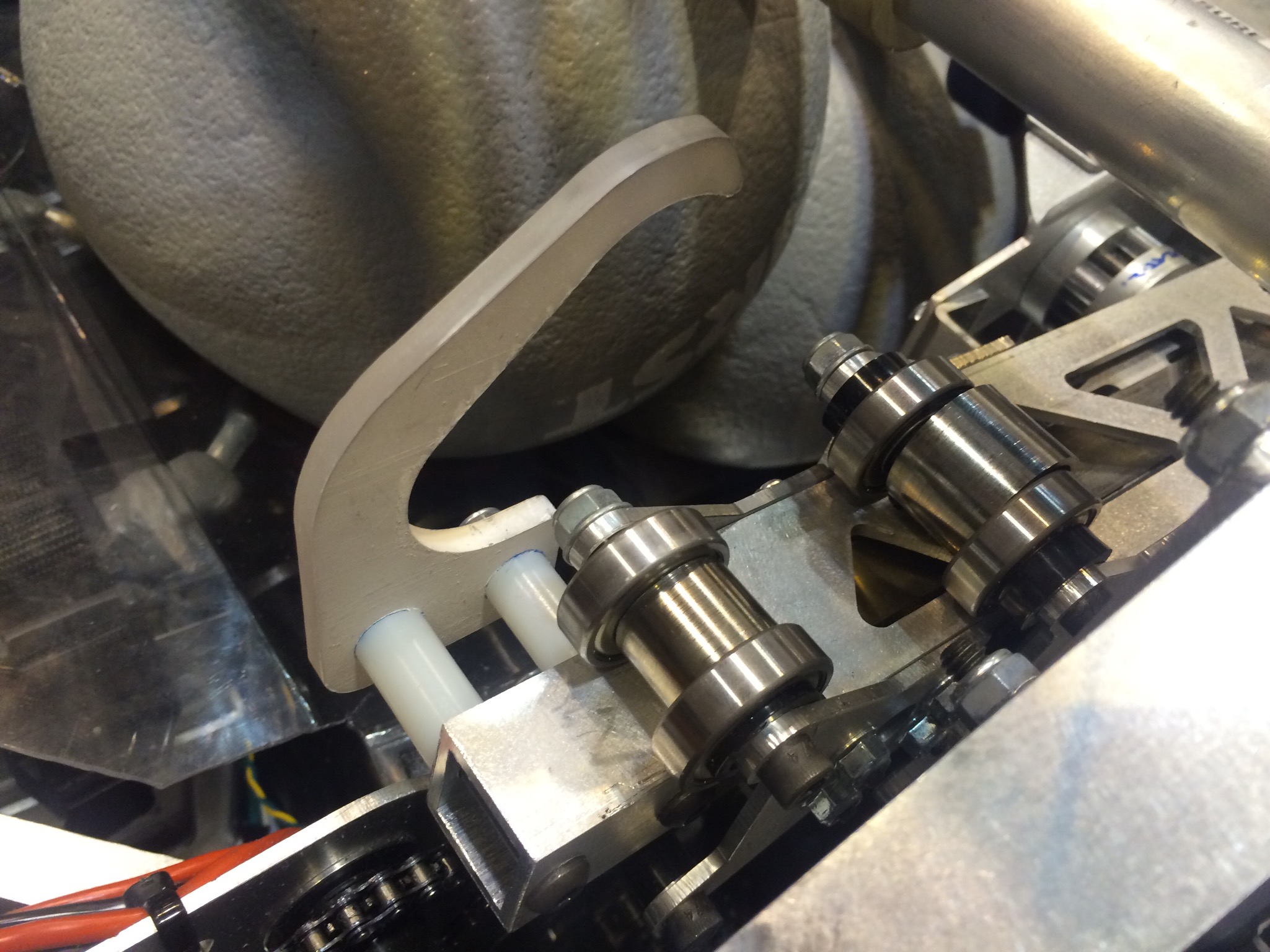

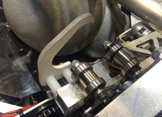

I snagged one photo of 2056’s hanger at champs in 2016. You can see their bearings with a constant force spring between.
