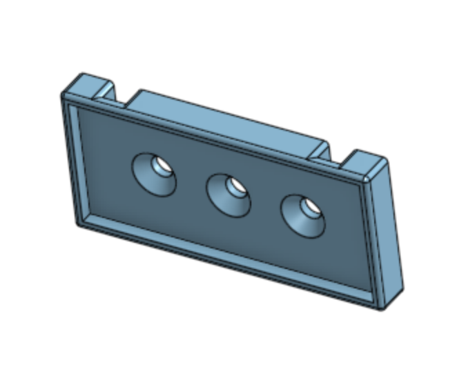

We use some mounts that can be screwed or double sided taped into place (what we usually do) which have a slot for 2 tywraps so you can change a controller without messing with its mount - that can help if you have an actual malfunctioning device if you need to swap for a replacement.
Single and Dual for SparkMax and TalonSRX - it’s probably not an original idea - I think I saw something similar…
