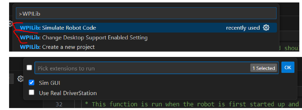

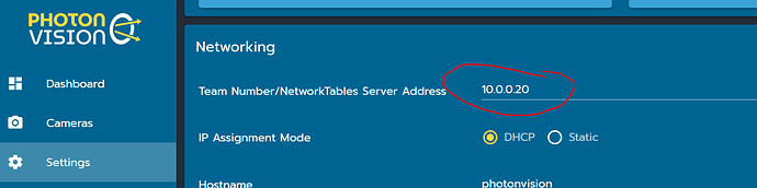

Well, I had given up frankly. I had taken everything apart and put it away. And then I thought that I would post an issue on the github. Like a somewhat responsible developer, I searched the github page directly and I found out that they actually pushed a pull request which now allows you to enter in PhotonVision the hostname or IP address of the remote network tables.
Even after flashing the most recent beta version, I still wasn’t able to see this option in the UI. Not sure if my browser was caching pages or what. I exported the settings and then for some reason it DID pop up.
So, I used the WPILib command to turn on Desktop Support and then I also ran “Simulate Robot” command.
When given two options, I choose the SIM Gui:
And then I was able to see the Network Tables and data was streaming to it. I also saw in the PhotonVision UI that it was connected.

So, in short PhotonVision DOES support running NetworkTables remotely now and running it on a laptop (VisualStudio Code Simulating Robot Code). This makes it SO much easier to test out some code without a RoboRIO nearby. Then when you take the RasberryPi back to where the RoboRIO is at, I assume that you would only have to change the setting back from the IP address or hostname back to a TEAM number and then it will automatically connect to the right NetworkTables and you are up and running while connected to the robot.

Here is the screen shot of running in Visual Studio.
