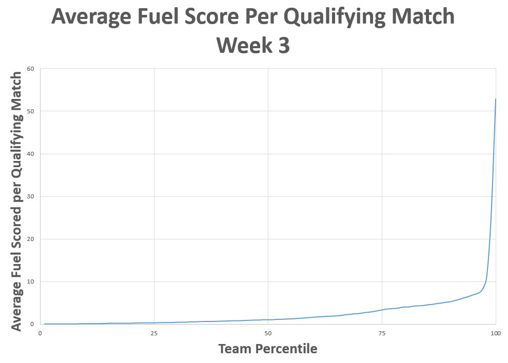

I’ve done some analysis of the TBA data. 937 teams competed in Week3. Here is a list of the top 10 teams (i.e. the top 1%) in terms of average pressure during qualification matches (not that THEY scored the pressure points necessarily but the alliance they were on scored that much).

More charts and the excel spreadsheet.
http://i.imgur.com/0sIIQk8.jpg
http://i.imgur.com/6jRRjro.jpg
Charts tell a pretty compelling story at least to my eyes.
Data is available in the spreadsheet. What does the data say to you?
