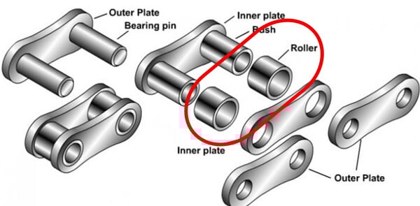

This post from 8 years ago may help:
The 5 does mean “rollerless” as in, the chain links use a bushing/pin system rather than a roller.

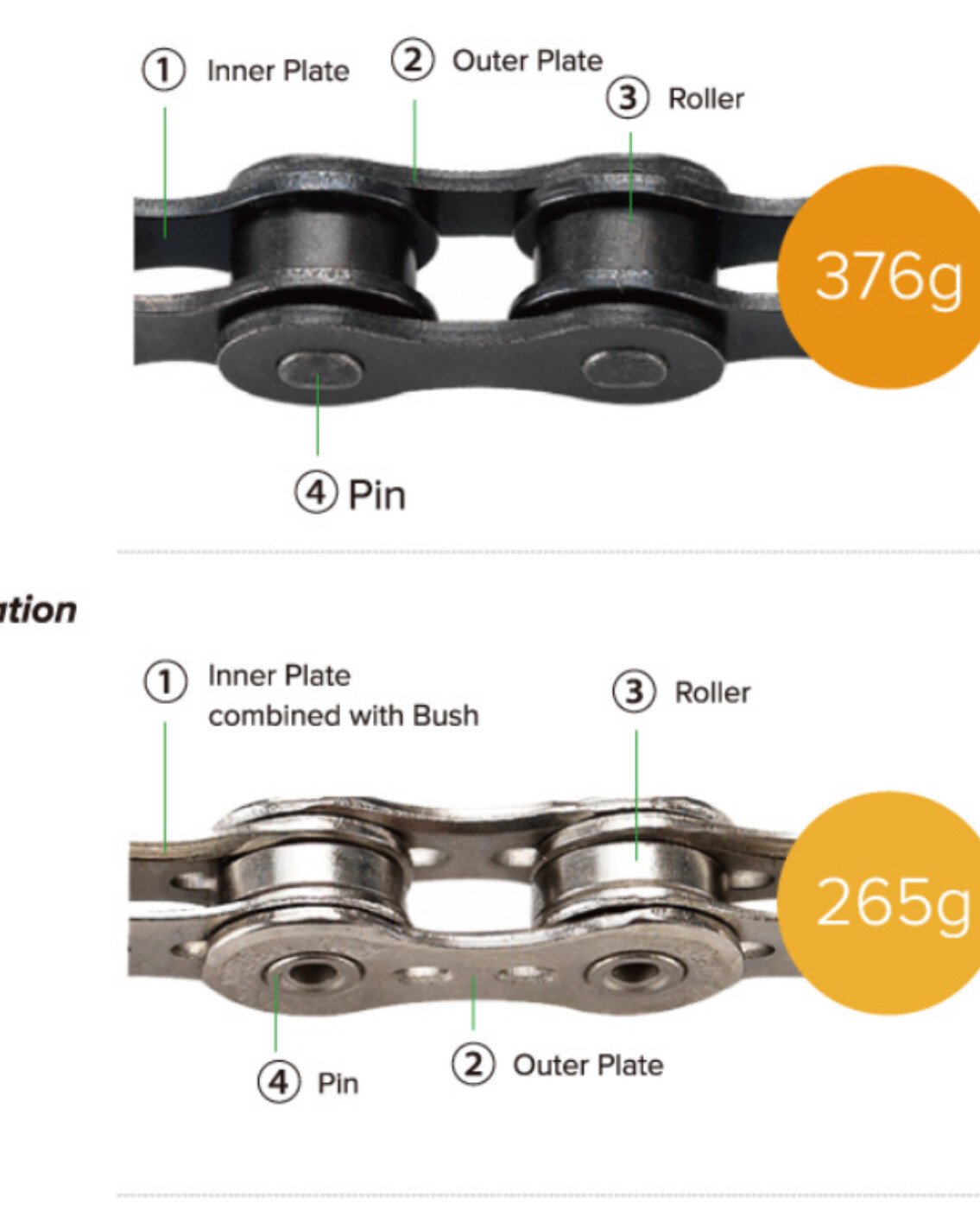

Here’s a picture of a chain with rollers.

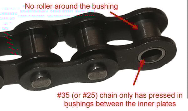

The 25 and 35 chains do not have rollers. They only have bushings between the inner plates.
The larger ANSI chains have rollers between the inner plates around the OD of the bushings.
You can explain it by showing pictures like these.

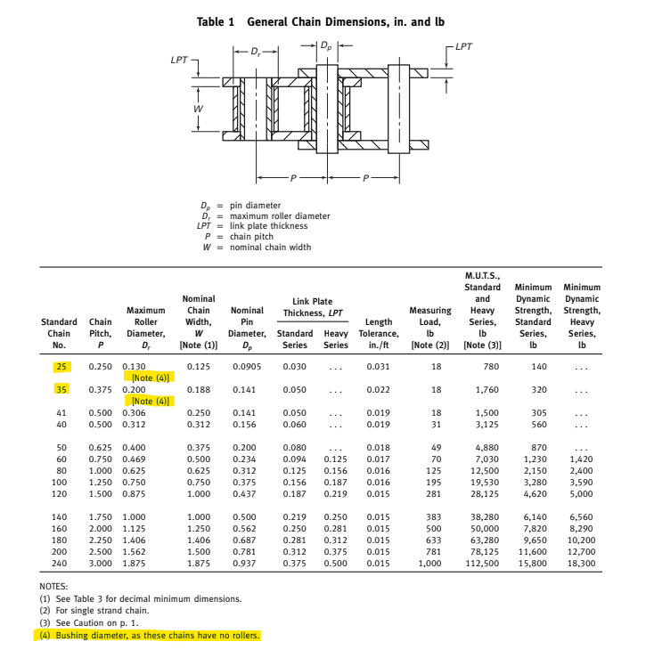

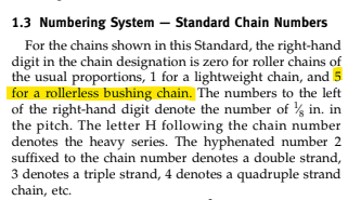

Some relevant excerpts from ASME B29.1
