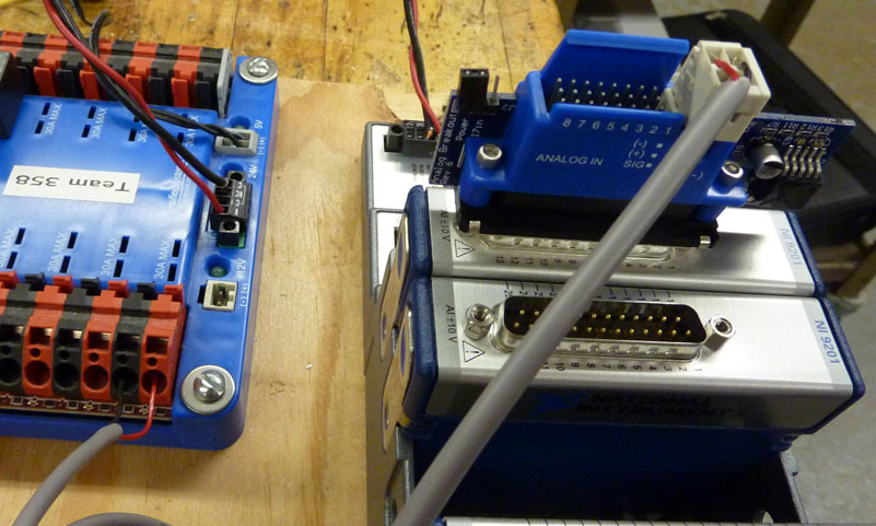

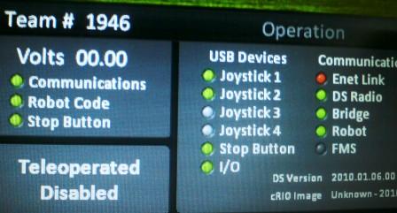

we have another problem at the classmate there is 0.0 volt see pic
The voltage reading originates at the Analog Breakout on the cRIO’s first module.
To get it to work, there are two typical reasons for the 0.0v:
  • The Analog Breakout needs a jumper on the outer two pins
    *]The Analog Breakout needs to be receiving power directly from the Power Distribution Panel
is there any docoments related to read who to do that, it will be nice frome you to send me the linke
Sorry i THINK i FOUND IT IN
http://209.85.129.132/search?q=cache:KzOAQfNiN7QJ:www.chiefdelphi.com/forums/showthread.php%3Ft%3D70970+Analog+Breakout&cd=2&hl=iw&ct=clnk&gl=il&client=firefox-a
Section3 PAGE 20
This year’s is in the Chapter 3 of the Control system Manual, starting on page 11.
We have a jumper on the outer two pins also the analog breakout is receiving power from power distribution bored
Still we get the same problem I’m not sure why??
If the jumper is installed and the power LED is lit on the Analog Breakout installed in cRIO slot 1, then that should be all you need.
  • Double-check that you have the correct cRIO Module labeled “NI 9201,” the Analog Breakout will fit on the Solenoid Module, but won’t operate properly of course.
  • I assume you have code running and confirmed via the Driver Station status.
  • Pull the Analog Module from slot 1 of the cRIO and look carefully underneath to see if any of the pins in the cRIO connector are bent.
*]You should have received two Analog Breakouts and two cRIO Analog Modules NI 9201. Try swapping Modules and Analog Breakouts.
Mark
My programmer girls solve the problem:
  1. The battery have 3 [v] for the Cypress IO board. They change the battery, then it works. But had some conflict.
  2. They Double-check that for the correct cRIO Module labeled “NI 9201,” , it was in wrong place. They change it.
  3. after 4 hours we lost the volt 3 [v] instead 9 [v] from the battery. Interesting thing, but they drive the Robot.
