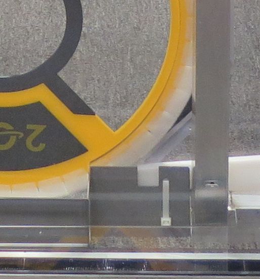

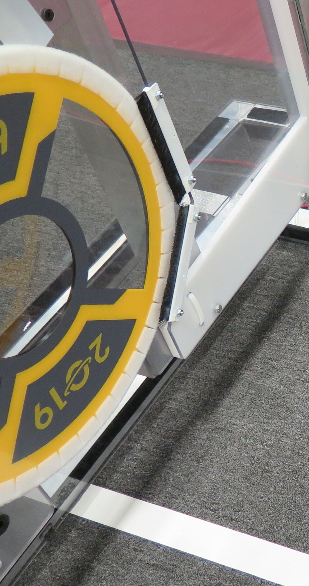

The mandated brush material has the property that the two sides are not the same. On one side, the plastic mounting flange is essentially flush with the bristles. On the other side, there is a lip where the flange meets the bristles. Looking carefully at all of the field drawings (both the real field and the plywood mockups) I can’t find a closeup that shows clearly which side of the flange faces toward the Loading Station. This is an important detail, because mounting the flange with the lip side toward the Loading Station puts the lip in front of the edges of the hatch panel in two places, making it difficult or impossible to pull the hatch panel straight off of the Loading Station (i.e. without first lifting it up slightly). Mounting it with the lip away from the Loading Station allows the hatch panel to be pulled straight back through the bristles.
Does anyone know which way the brush material is supposed to be mounted?
Looks like the flange faces the wall.
Here is a close-up from behind the loading station.
Here’s the robot side close-up

Thanks to Mark for his fast and informative reply. On closer examination, the answer seems clear: when dropped into place in the Loading Station, the the hatch panel does NOT rest on the surfaces where the three brushes are mounted. Instead it is located on one side by the separate round stop (part #26, McMaster-Carr rubber bumper) and on the other side by the rounded corner of the L-shaped spacer (part #16). (Part numbers from Reduced Field Drawings.) These two locators insure that the hatch panel does not drop down far enough to get hung up on the brush flanges. Instead, it is retained only by the bristles and can easily be pulled straight off of the front of the Loading Station. Problem solved.
