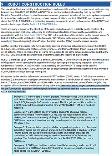

The 2023 Game Manual Section 9 rules are kind of confusing here. Seems like even if you machine it yourself it falls into Example 2, but I could also see some readings of Example 3 and my highlighted sentence that would make it legal.
You came to the right conclusion but cited the wrong rule.
That is the rule that defines COTS and just states that discontinued COTS parts that are not functionally modified are still COTS. However, the rule about parts made before the season allows for functionally equivalent parts:
